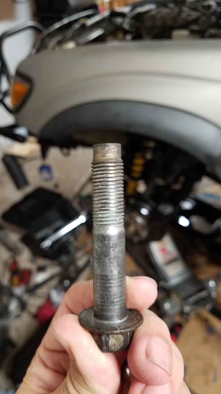

    Those threads don’t look that bad

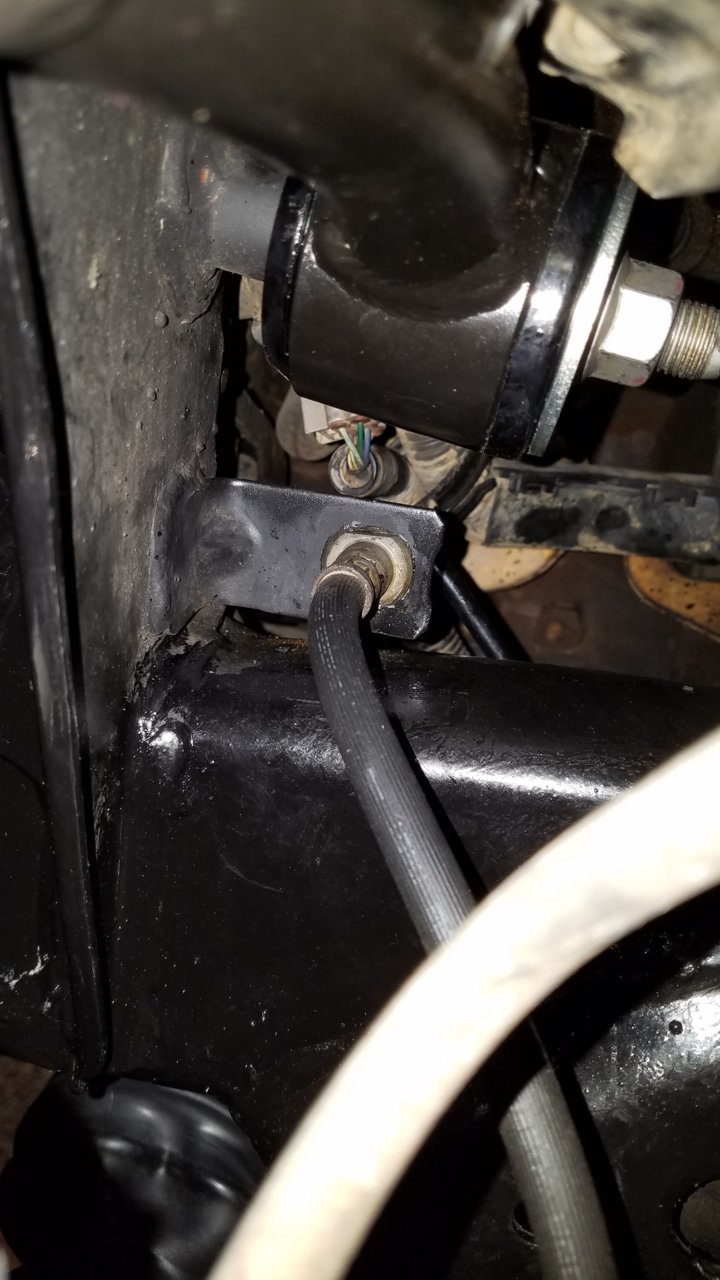

    I ran into a lot of issues with my brake lines when I changed them during my lift install. What won’t disconnect? The soft line has a u shaped clip that holds it on that bracket near the control arm. Sometimes these get essentially fused to the bracket and can take a bit a prying and poking to remove. If it’s the hard line you can’t get to break free from the soft line, we’ll my only advice is pull harder.
    Regarding the shock bolt it doesn’t look too bad, that’s just wear from where it contacts the shock tabs and the bushing. I’d get a new one for peace of mind. When installing the new one however don’t try to just hammer it into the hole. Put your trucks bottle jack between the wheel well and uca and push the uca down until the holes are lined up. However this is only really applicable if you still have a sway bar on.

    i couldnt separate the hard line from the soft line. ill try again later. i didnt have this issue on the passenger side at all. just super messy and cramp working in that cramp space. really crappy placement for that connection. i tried to hand thread the nut onto the bolt and i couldnt get it past 2 or 3 threads.

    I replaced my brake lines with Goodridge SS lines last month, to avoid the mess, use something (or someone if they are willing to sit for that long) to depress the brake pedal all the way to the floor & keep it there while you're replacing the brake line.
    What you want to do is connect a hose to bleeder on the caliper to drain into a container, loosen the bleeder, then press the brake pedal all the way to floor & have it held there. I used to work on cars for a living so I have one of those telescoping hood props that I placed between the pedal & the seat.
    Now while you're changing the brake line, you won't get brake fluid constantly dripping out & you can take all the time you need without worrying about mess.

    damn. this would have saved me ALOT of rags, cursing and brake fluid. i ordered some LCE Performance Brake Lines. they dont give (twist) very much when you attach them to the hard line and caliper. i had to reinstal a few times. (Noob with brake lines i guess)

    Another trick when installing SS brake lines (or even just standard rubber brake lines) is to start at the caliper first, route & attach the brake line mount (if the vehicle has one), then attach to the hardline last. This helps eliminate the misalignment with lines that don't twist much.
