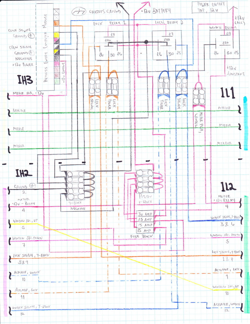

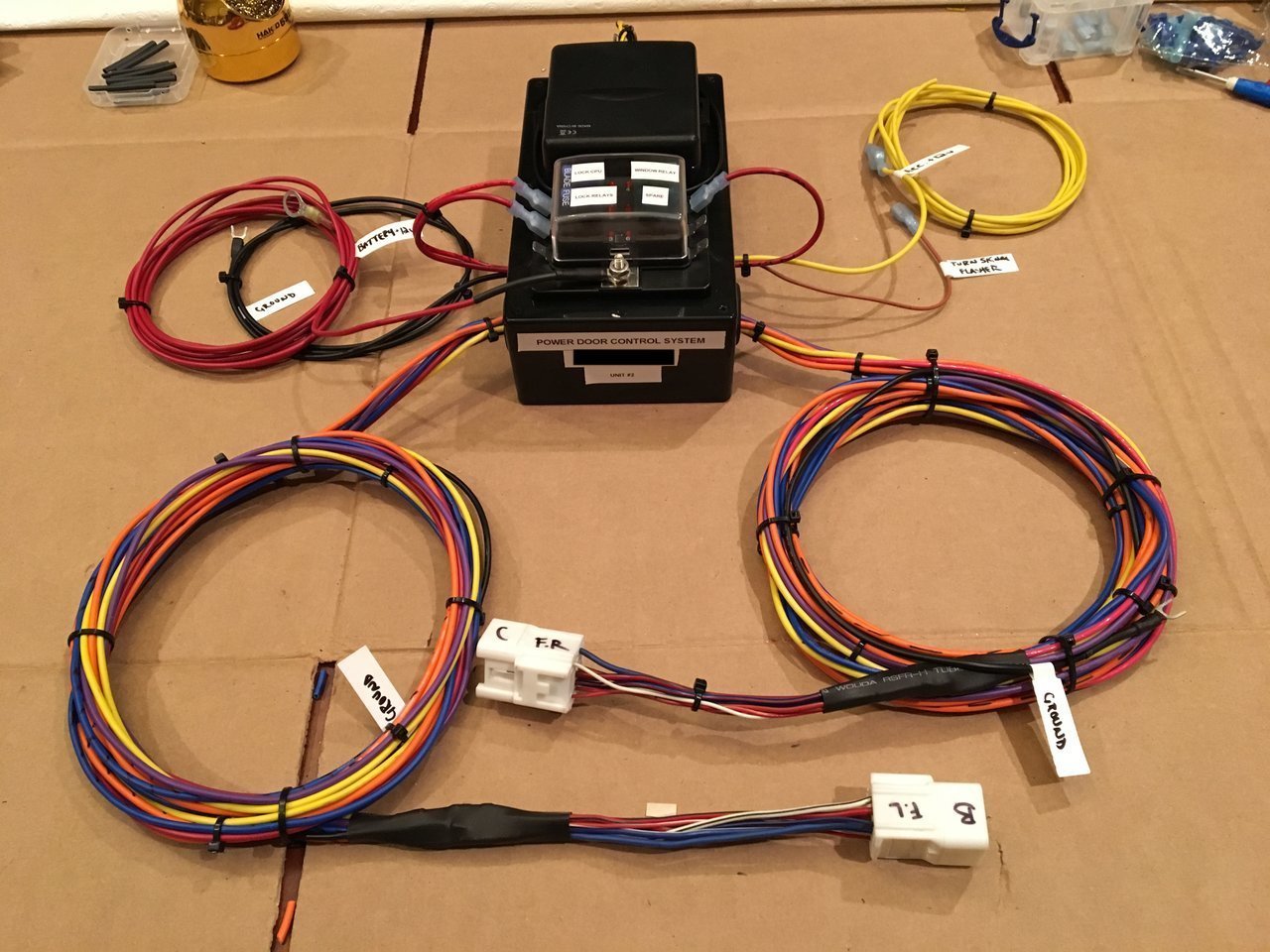

    Thanks! I'm no stranger to wiring, electrical systems are actually my specialty. Before I converted to 4WD, I converted my crank windows, manual mirrors & manual locks to full motorized and actuated ones by swapping in Double Cab door harnesses and making my own retrofit system to adapt to the OEM power and signal distribution system by bypassing the integration module.
    I've built a couple of these systems for other members on here, here's the latest one. Everything is OEM up to the kick panel, where my own system takes over.
