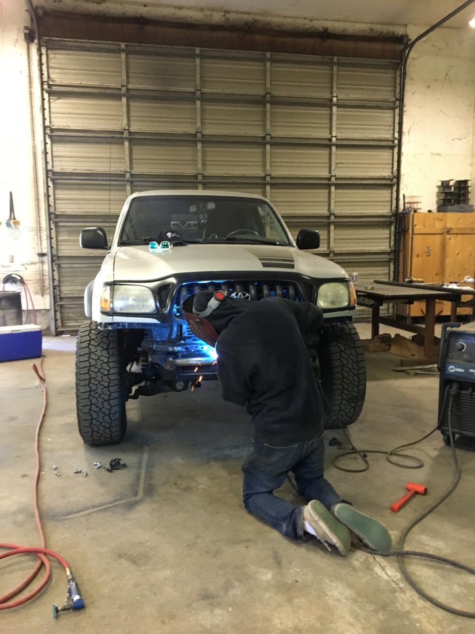

    I have a problem getting bored with my setup... selling my bumper tomorrow so today I started making a new bumper with my buddy who has the tube bender skills. I blame @Spoonman for making me want a cleaner design!

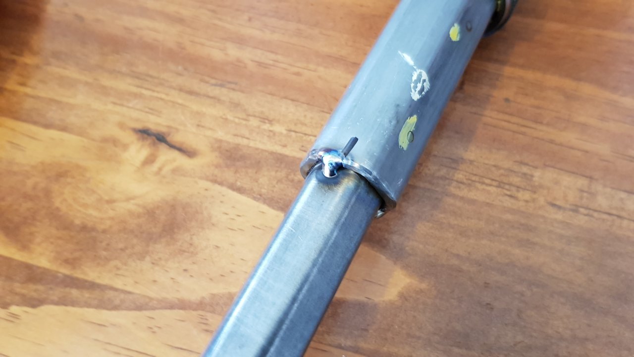

    Best mod for the money! I love driving down the highway, holding the steering wheel in one spot, and going straight as an arrow.

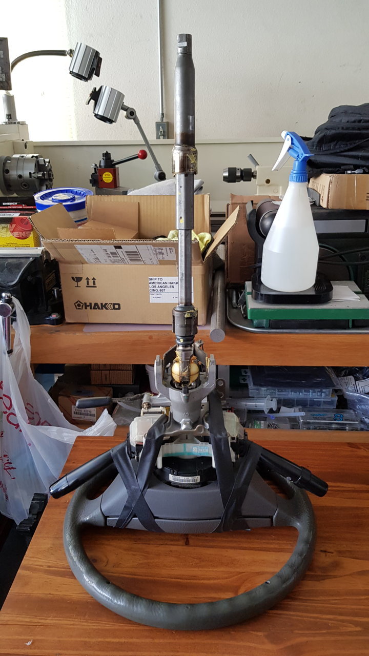

    Seriously, I think mine has been loose for so long I don't even remember it feeling this good! Thought it was my steering rack bushings again, change them & no difference. Felt a lot of play on the steering shaft pinion on the rack. Changed the guide bushing & spring, that eliminated all the play at the rack & got rid of a lot of steering wheel play but I still had some. Now with the tacks it's solid! Good thing I didn't go & change the rack cause it wasn't needed.

    I need to do this!

    Its really worth it. Ive done it. Use to be able just to shack my wheel like a 1” either way and Still be going straight now its nice and tight.
