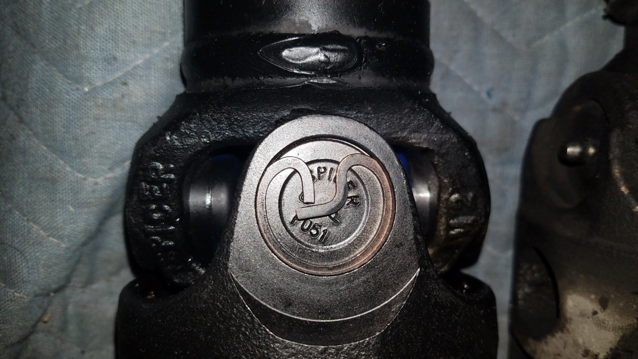

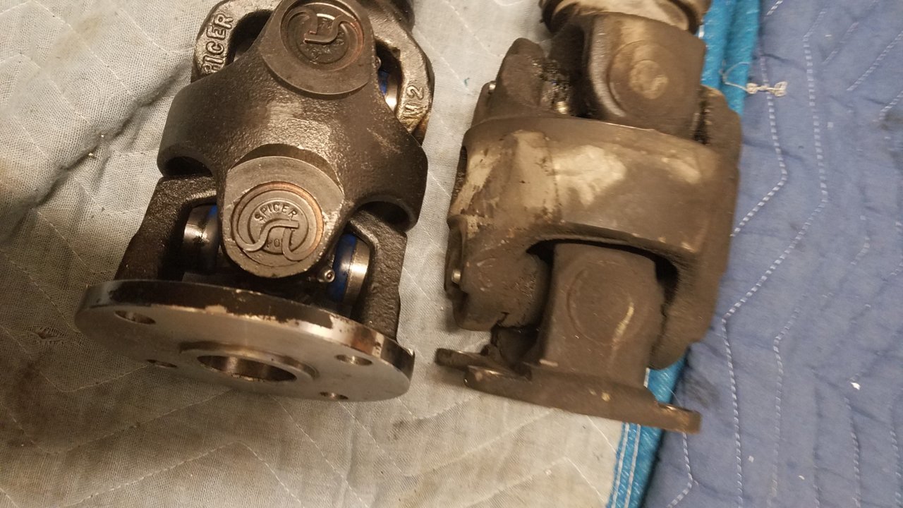

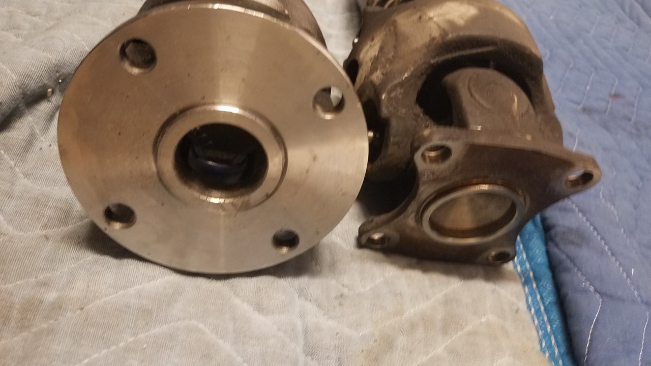

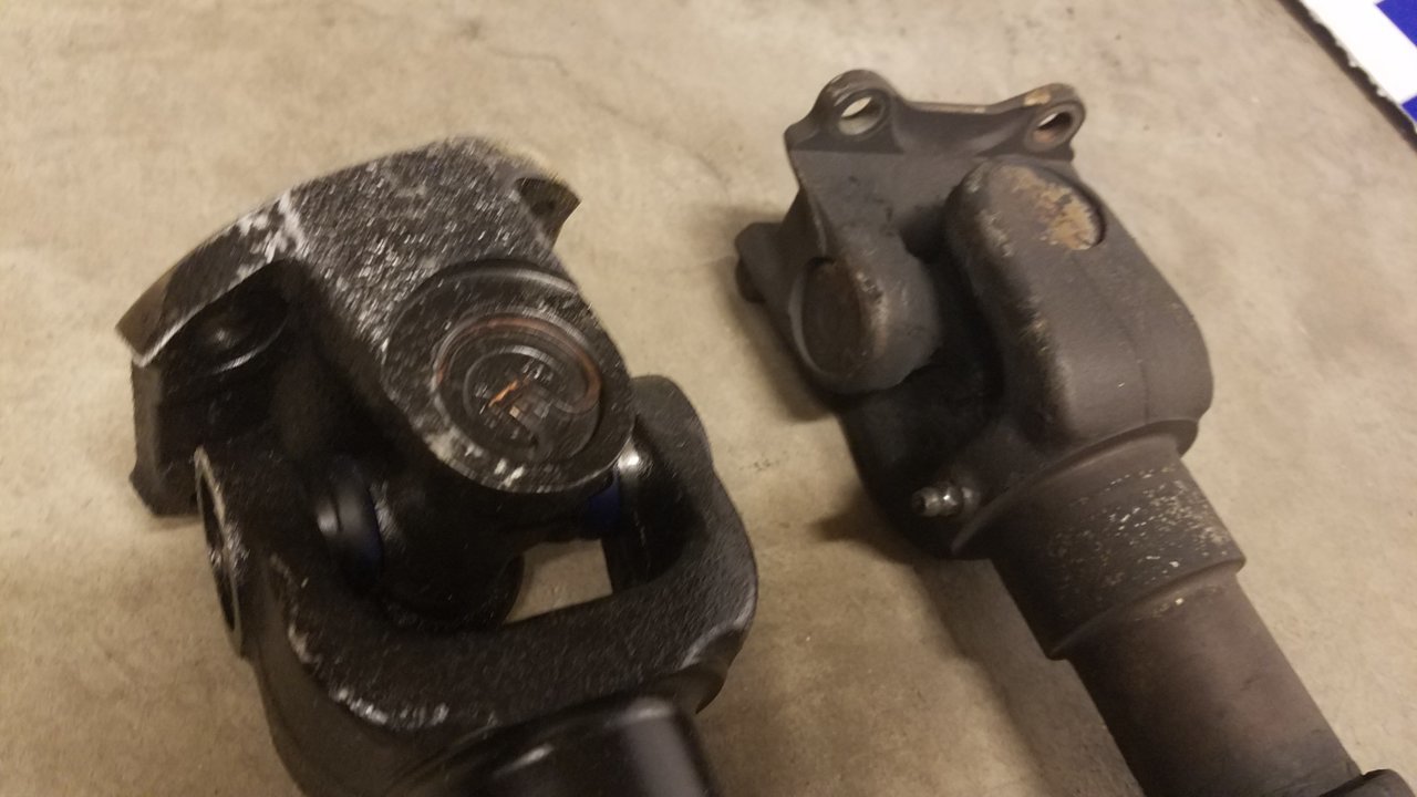

    At last, got the new Spicer drive shaft,
    Has a spicer double Cardin joint and Spicer ujoints and Spicer driveshaft components.
    Both Spicer driveshaft end flanges are much larger and stronger in size than the stock shaft
    Cardin center ball joint is sealed so now 2 zerks to grease instead of 3 and now one can replace ujoints or Cardin joint with ease if needed without having to fight
    the Toyota setup

    Nice. Where did you get it?

    interesting site. Cool, good to know. I'd probably call up Tom Woods.
