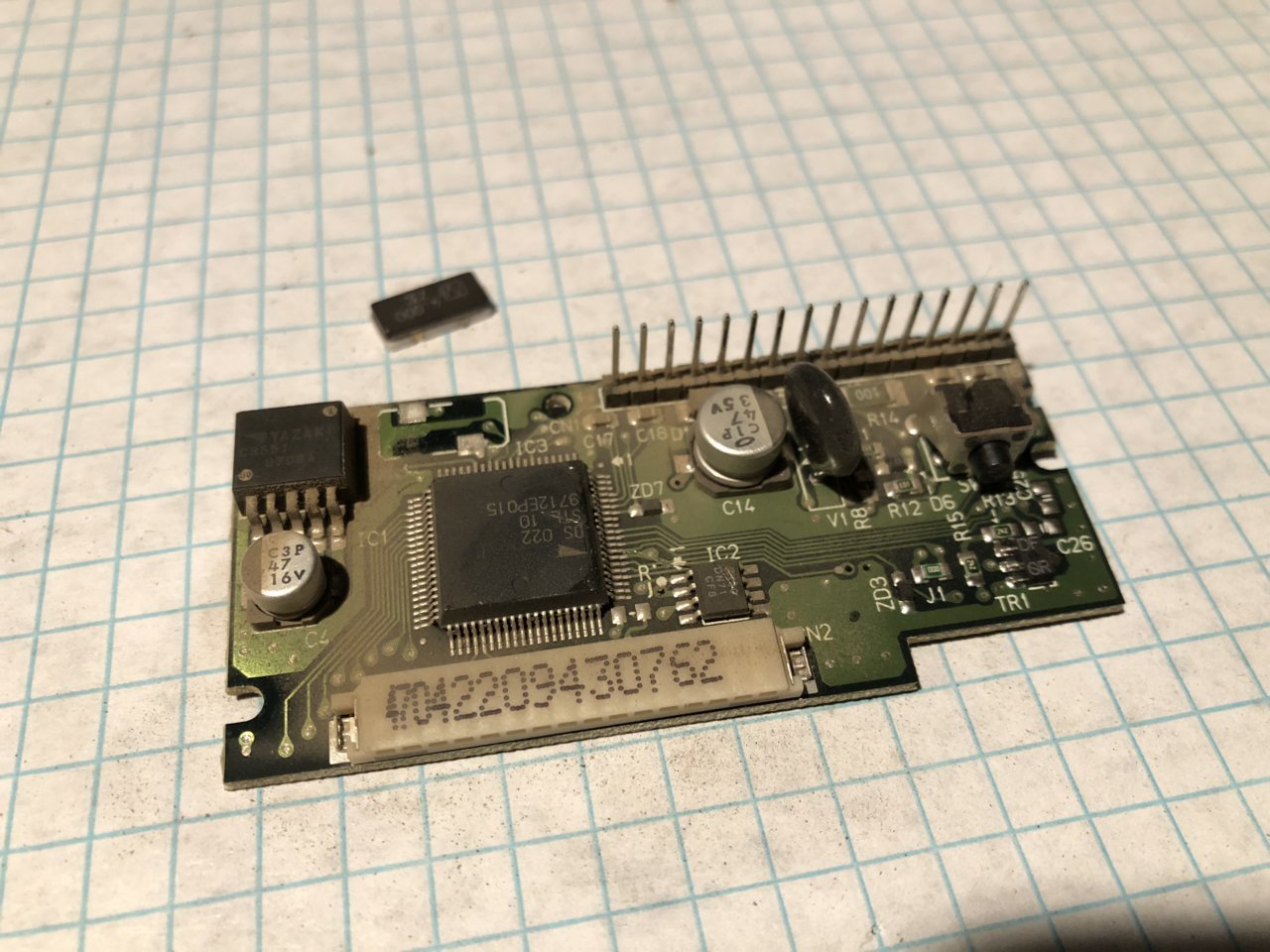

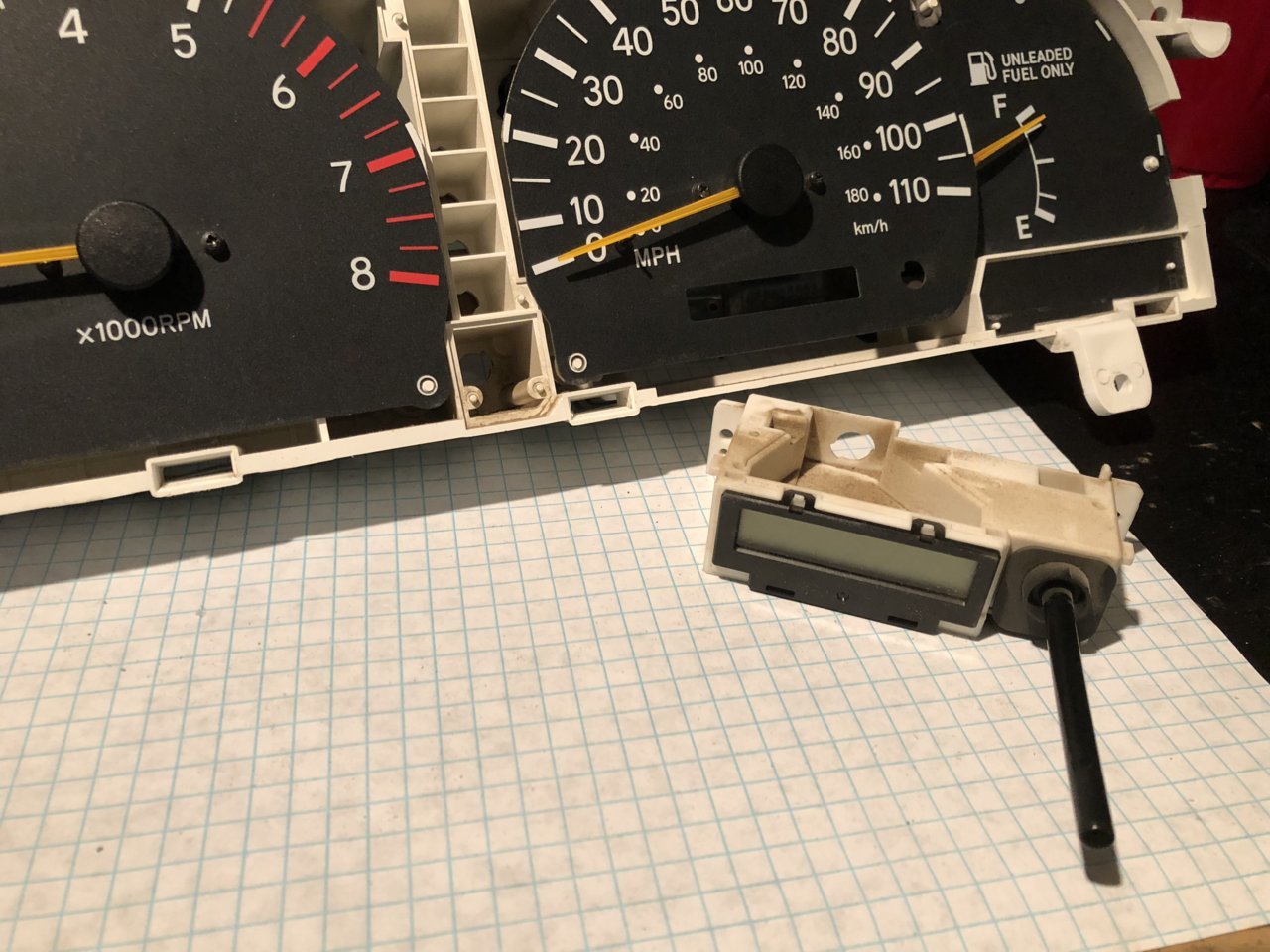

    The cluster in my 5-lug is pretty messed up. The lens I put in it doesn’t fit correctly since I grafted it from an earlier Tacoma, and the gas gauge is dead. Toyota wants $150 for a new gas gauge, and it was cheaper to just buy a new cluster.
    But here’s the issue: the mileage is programmed onto a ROM chip. The only way to change the mileage is to de-solder the ROM, wire it in-line with several resistors on a breadboard, and connect the correct pin outs into the serial port on a pre-2000 Windows PC. The mileage is programmed in Hexadecimal so you would have to use some kind of Serial IDE interface to change it.
    Way too much work, so I’m just going to de-solder the ROM chip on this cluster and replace it on my new cluster.
    Let the tear-down begin.
    Speedytech7, SwampYota and Sperrunner like this.

    Wow.
    That was easy.
    I read a write up on how to do it on an IS300, and you basically have to tear the entire cluster apart to get to the ROM chip which is an integral part of the entire cluster. On the Tacoma it’s literally just a module that’s held in with two screws.

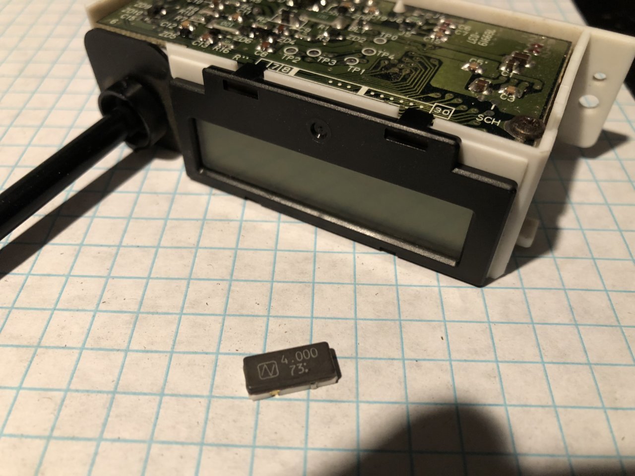

    Something was rattling inside, so I shook it until it fell out.
    That’s not good.

    The Tacoma Odometer module.
    And disembodied IC chip, and I have no idea what it does.

    You have a hot air rework gun? Easy to reflow solder that back on. But it looks like the contacts are accessible from the sides, if yes a soldering iron will work.

    I used to do a lot of SMD/BGA soldering on MacBooks, but I got rid of my nice rework station a long time ago. I'm going to have to do this with a soldering iron.

    If it needs to be reflowed, I've reflowed plenty of SMD components with a portable butane torch using the heat/hot air attachment. :rofl:

    In my experience, I've found that solder remains molten for 1-2 seconds so you do have a period of time where you can position the chip.
    This is going to be difficult without any flux or a hot air rework gun.
