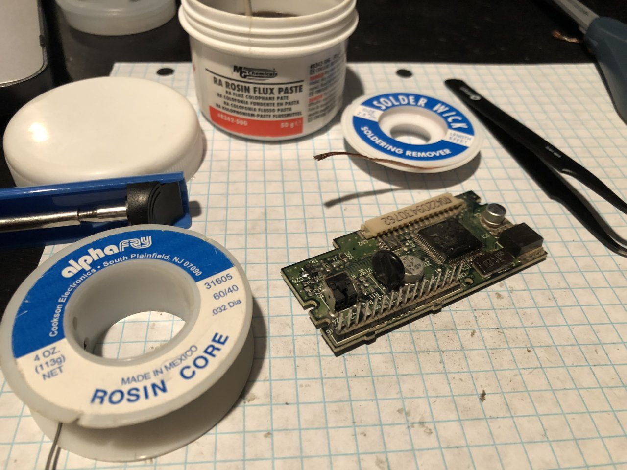

    Welp. That sucked. I am a little rusty at SMD soldering.
    I globbed solder on some of the metal traces of IC1 and getting it off was tough. These pins and traces are so small you need a jewelers Lupe to really see them.
    I’m going to go see if it still works.

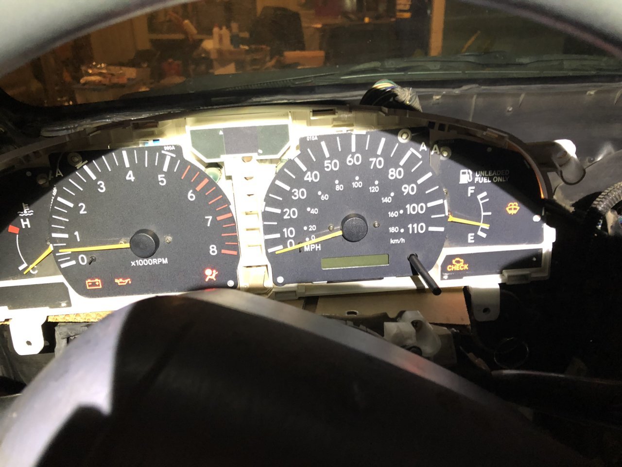

    Nope. It’s dead.
    And the rest of the cluster is too.
    RIP 5-Lug Cluster 1998-2018

    Thats actually a bad way to solder. Creates a cold joint.
    You actually want to heat the two things you are combining and flow solder on it. Thats a proper solder joint.

    I know that’s not you’re supposed to solder. I usually do SMD soldering with a hot air rework station, I just dont have one anymore. It’s an SMD Oscillator chip, so the contacts are on the underside of the chip. I don’t have the proper tools to solder those kinds of things anymore so what I did was the next best thing.
    I killed the Odometer PCB anyway, some stray solder got on the pins for IC1 and shorted something out, despite my efforts.
    However, the IC chip with the mileage stored on it is still intact. I’m sending it out to have the chips swapped onto a new instrument cluster.
