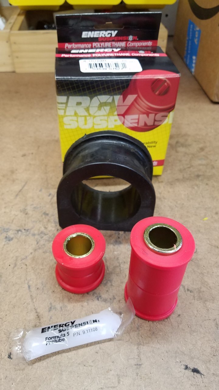

    If the new rack comes with new bushings might as well just run em till they wear out. The ES ones only cost $25 but there's that sleeve issue. Wonder if it was just me, haven't heard anyone else mention that issue. I was just going to machine an insert for that oversized sleeve on my last set but decided to just use my old sleeve & be done with it.

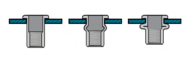

    I removed the hood latch bracket and moved the hose in front of it. Also unclamped it while mounting cooler. Then re-clamped it. All the bolts to mount it go into nutserts.

    my rack was rebuilt in 2016 and they included new bushings. im sure a new rack will come with bushings installed. upon inspection the other bushings were in great shape.
    i bought the ES kit for the rack and i only changed the bigger bushing because it was the easiest. (and i like the red look) the black one i took off was in great shape. long story short i have the set if you need it. just PM me.

    When ES first released the bushing set they did not realize that Toyota used 2 different diameter bolts. The exact point when they changed has never been set in stone. I bought one of the first sets and along with many others had to drill out the sleeve. If one goes with the set that comes with the extra sleeve, the bases will be covered. However the larger sleeve will work fine with both bolts.
    The bushings in OE racks work for both size bolts.

    Ah, didn't know that, thanks for that info. Yeah my first set that I had to drill out was in 2005. The set I got last month had the larger ID bushing but the hole was much larger than the bolt so I didn't want to use it.

    Yes your new rack will come with brand new ones, but mine had play in only 5k miles. Of course that included my cross country trip and Moab, but still. I was so mad I didn't do it when I put the new rack in.
