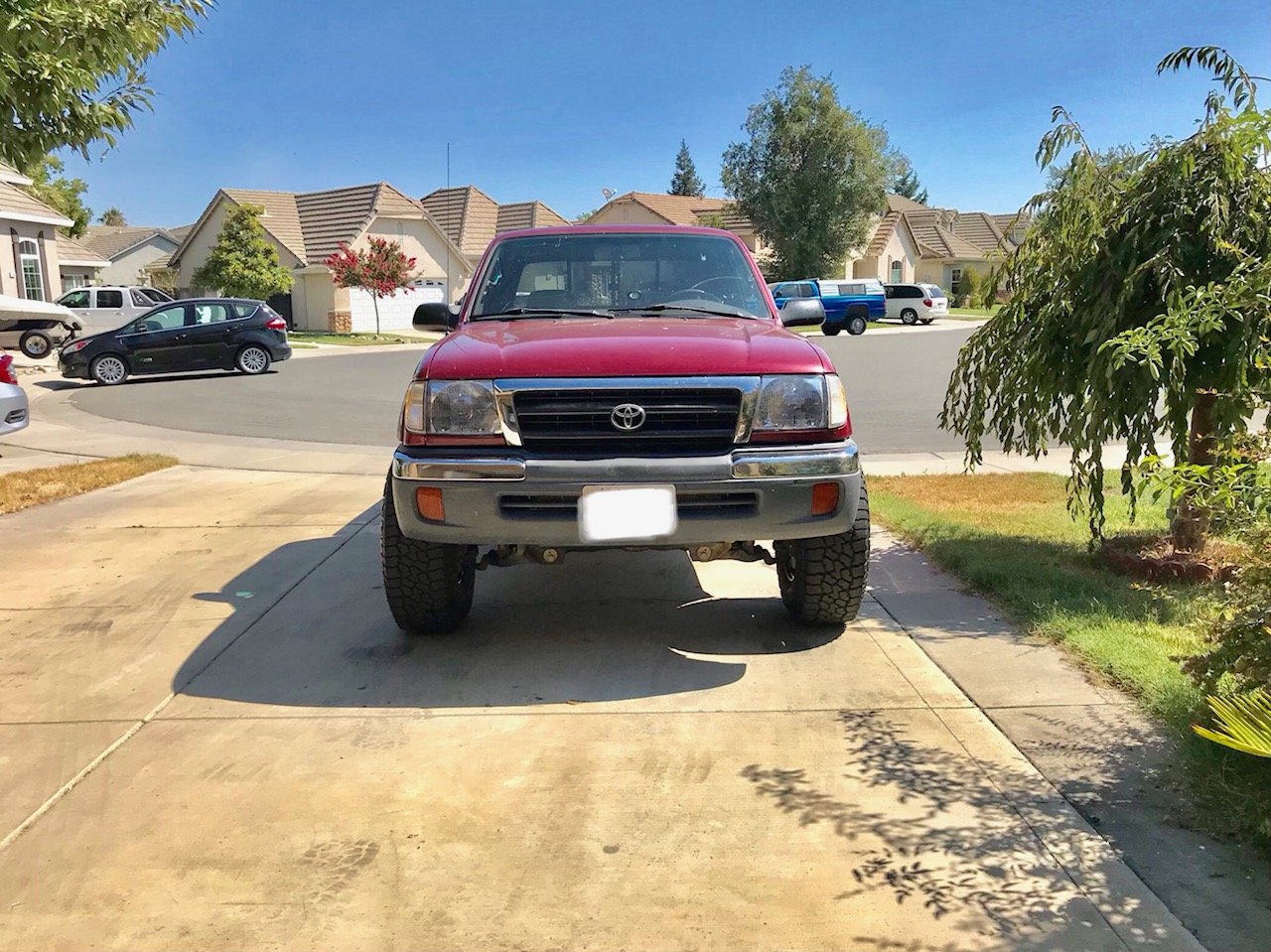

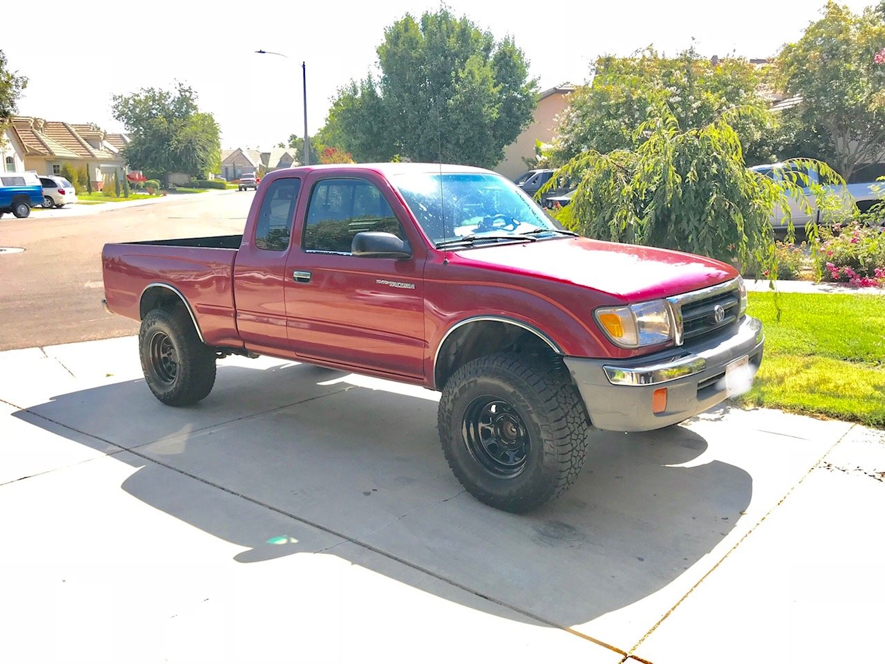

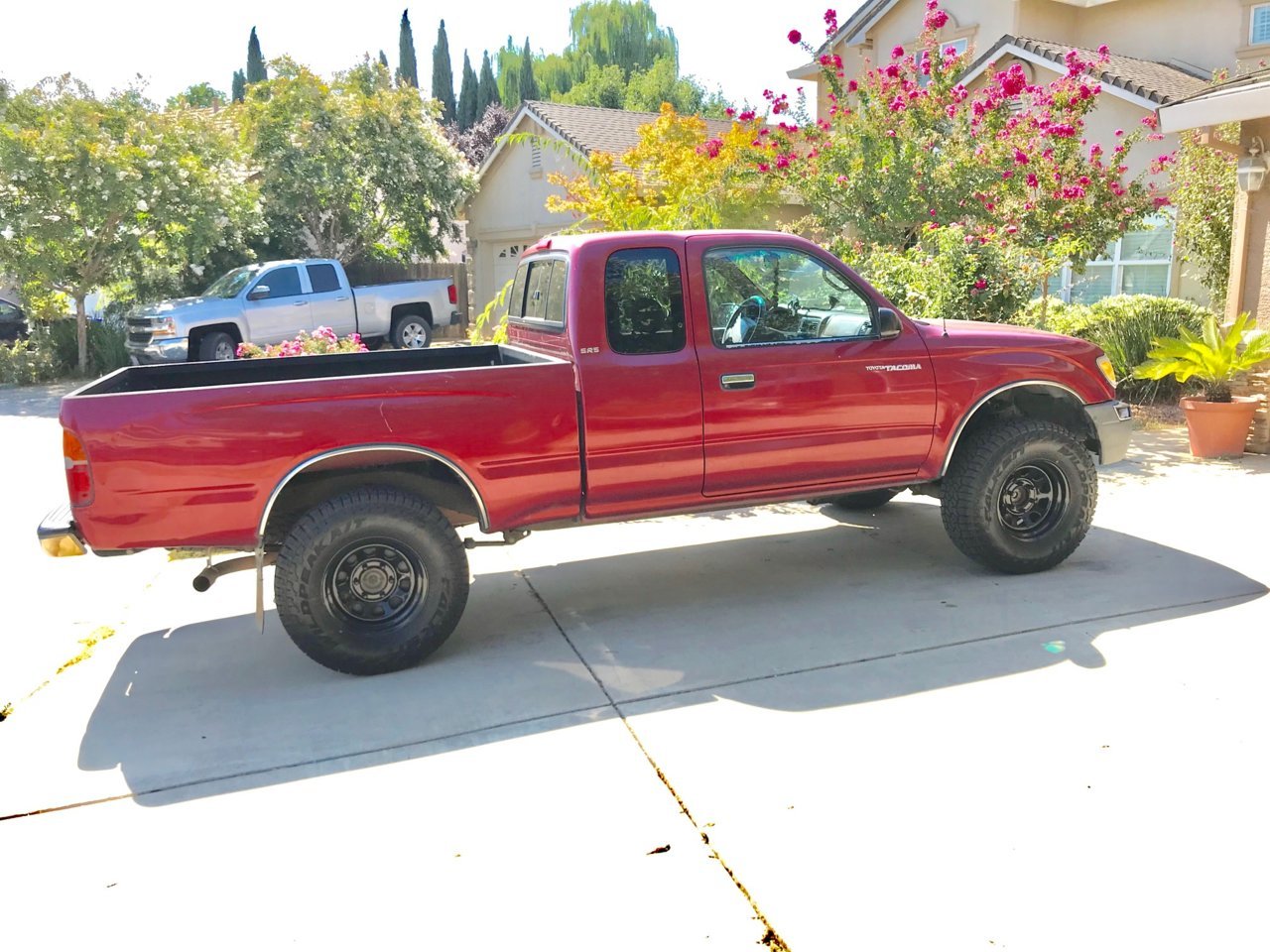

    The truck is sitting on stock height. Still has the original leaf springs. Only thing that has been changed are the shocks/struts through out the years, but always used stock height shocks and struts. I’ll measure the height from the ground to the fender flares.

    Should measure center of hub to fender flare as well

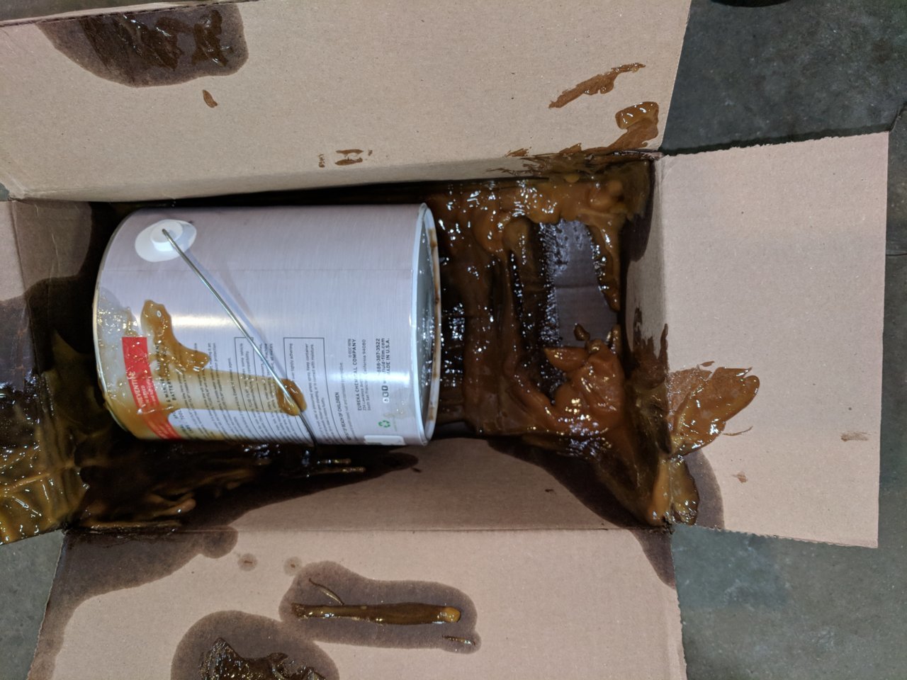

    I just did the wife's Tacoma last week. I did get a surprise from Amazon, though.IMG_20180731_144521.jpg

    That’s ridiculous. What did Amazon say when you contacted them about it?

    They just refunded my money. I still call it a win, I was able to salvage about half.
    The stuff smells terrible. Smells like a cat litter box that needed cleaned a week earlier.
