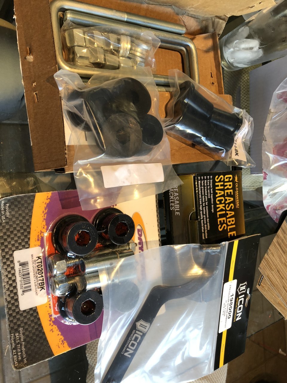

    Really? Did you put that you were using AllPro springs in the order?
    This is what they sent me. They are identical to the bushings that came out of the spring stock.
    I believe those smaller bushings press into the frame eye?
    SwampYota likes this.

    Mystery solved lol
    SwampYota and BartMaster1234 like this.
  11. Aug 18, 2018 at 11:21 AM
    eon_blue
    Mar 4, 2016
    #180213
    69,798
    Azusa, CA
    Yeah Wheelers sent you their own brand of bushings likely because you told them you had All Pro springs. The longer bushings go in the upper shackle, smaller ones go into the eyes of the springs

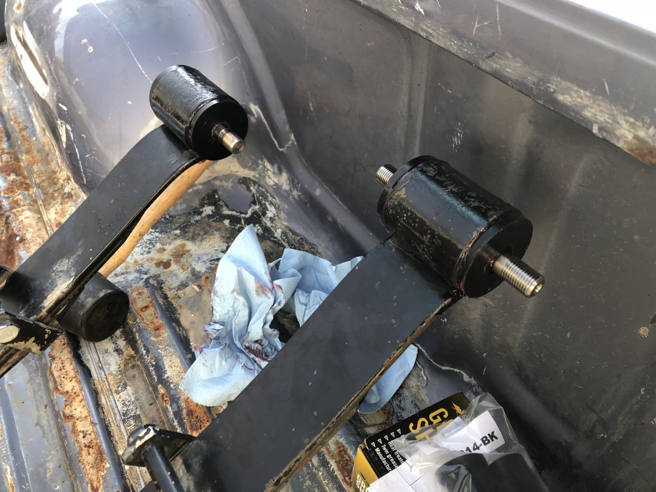

    The Wheeler's greasable shackle kit comes with OME shackles & black bushings to fit stock leaf eye size. If you purchase just the OME greasable shackles it doesn't come with any bushings. And as you all know OME bushings are yellow & don't fit stock eye size.

    Not for OME leafs. Not sure about All Pro but it sounds like stock eye size too. My Deavers have the stock eye size too which I prefer rather than something proprietary having to use only specific bushings.
    Yup. I bought the kit too.

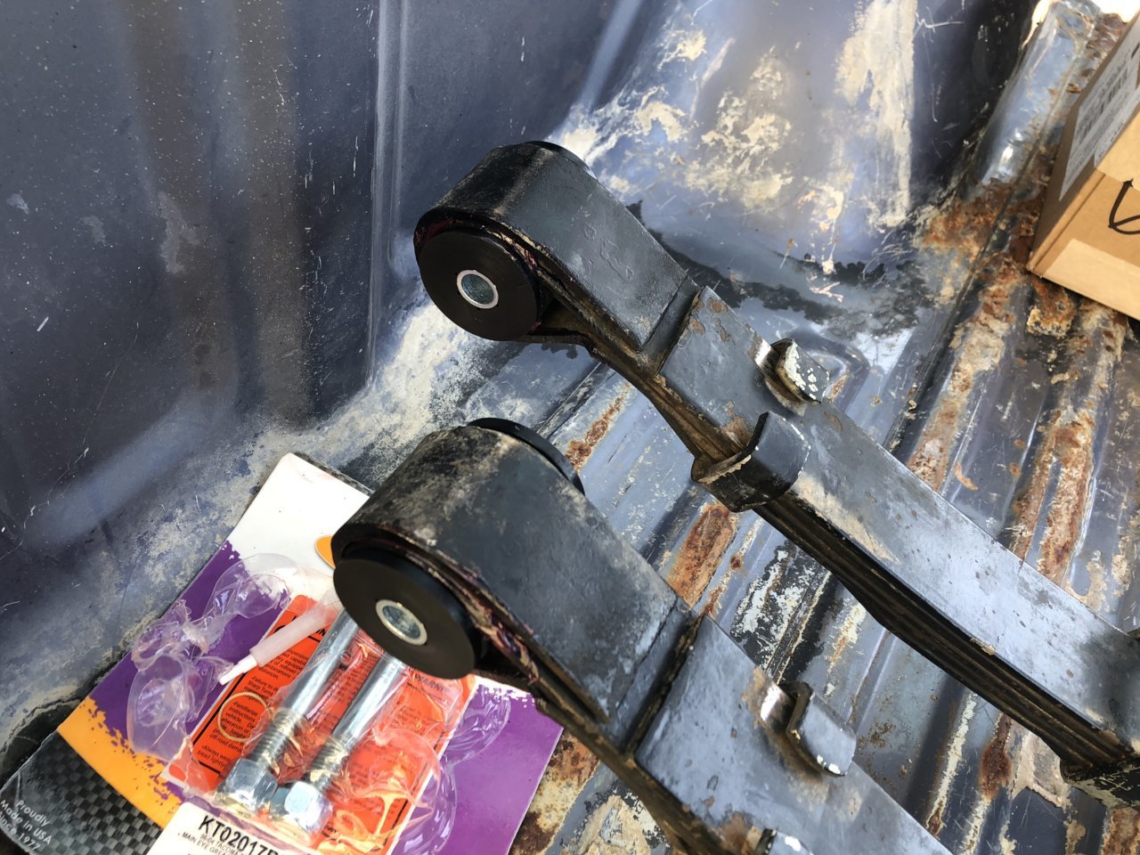

    I took a look at the stock leaf spring bushings and they’re completely different. Looks like a pain to remove them.
    I have a 2nd Gen Leafspring laying in my scrap pile, and it has the same bushings as the 1st Gen Leafspring.
