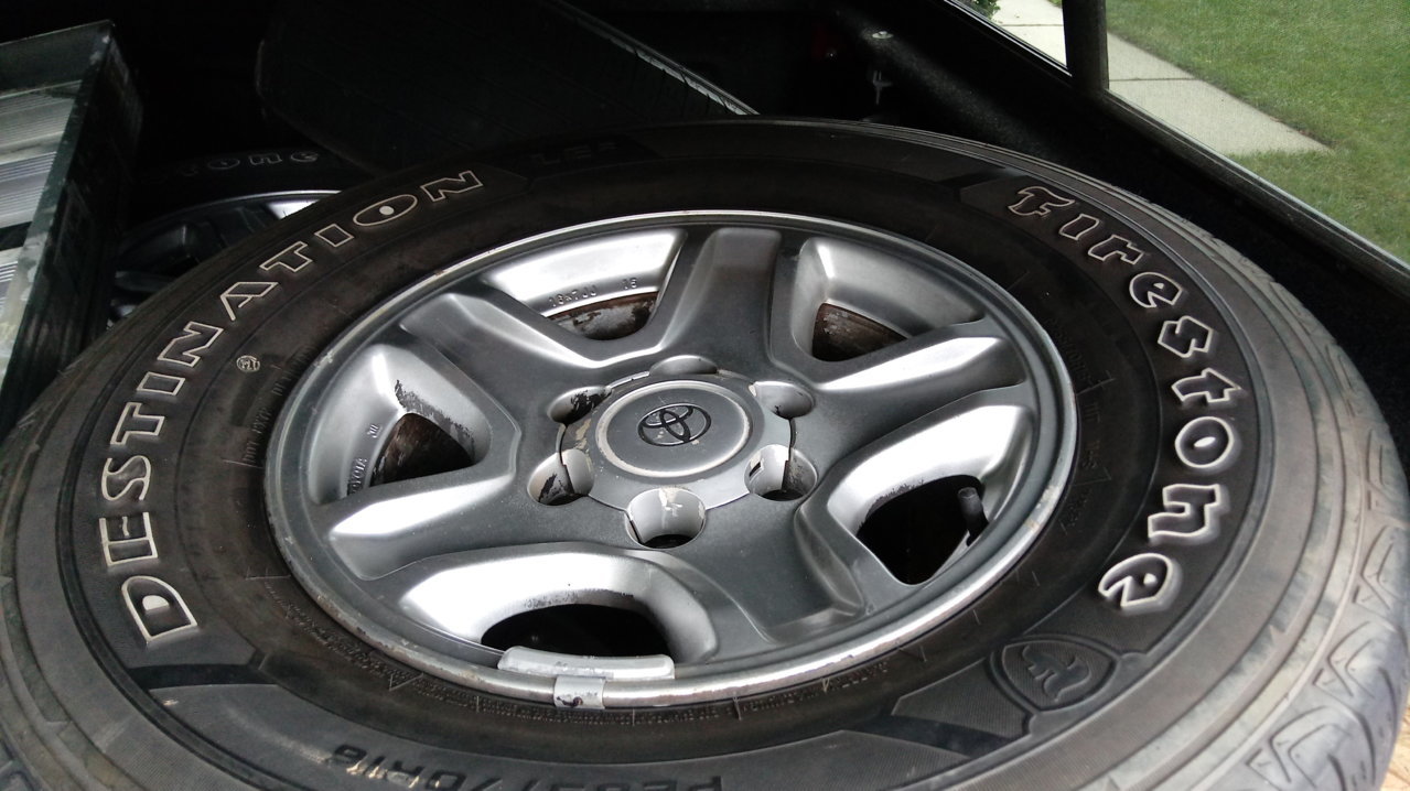

    Sounds like its time for some 3rd gen 4Runner wheels. Or FJ cruiser wheels. I cant wait to get mine powdercoated, I miss having space between my UCA and tire. Got some center caps off craigslist today. 0818181750.jpg

    I loved my 3rd gen wheels. They look great, but cause too many headaches once you start lifting and want bigger tires. Im probably gonna have to sell my 3rd gen sr5's to pay for the powdercoating, definetly gonna sell the 2nd gen TRD off road wheels Im on now once I get these 4Runner wheels mounted.

    Exactly why. I have 265/75/16s now and the stock UCA, no rubbing at all on stock SR5 wheels and 3rd Gen 4Runner Limited wheels. The SR5s are 4.625 BS and the 4Runner wheels are 4.5. @BartMaster1234 dump those 2nd gen wheels. Unless you are going to try spacers, not worth the hassle, just my opinion of course... :anonymous:
