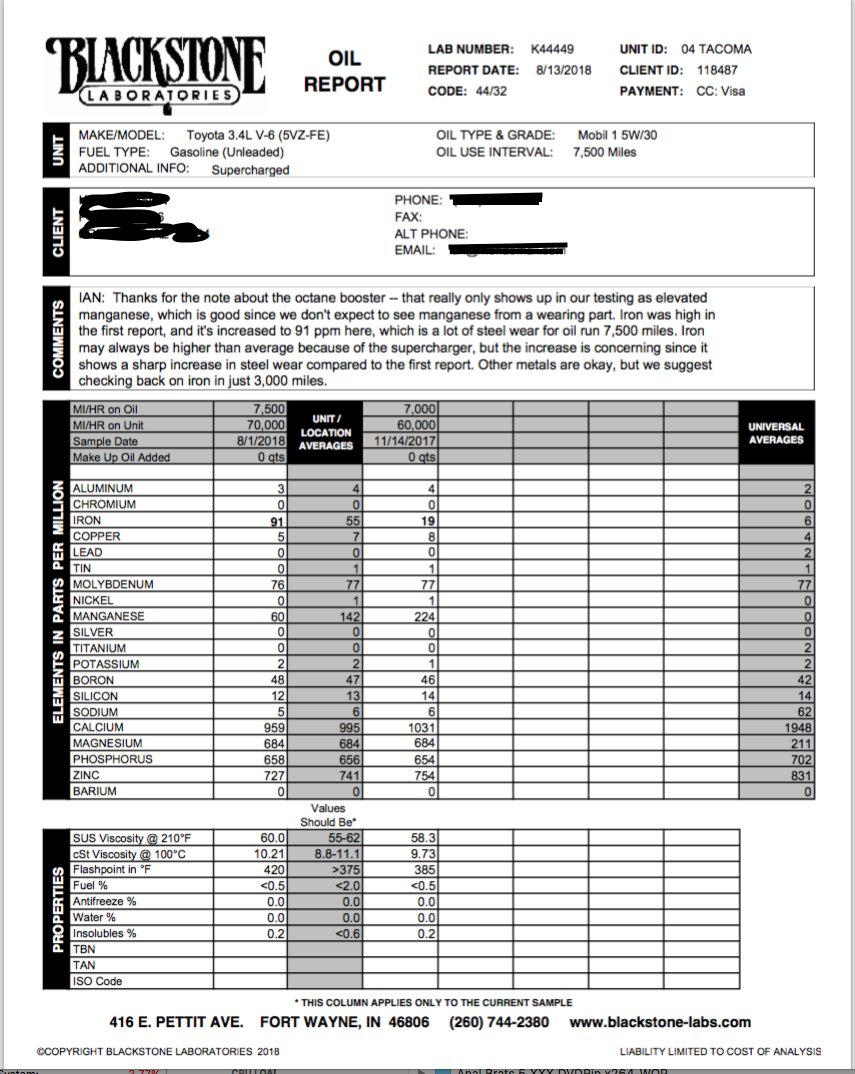

    I'm getting high iron in my oil analysis. SC'd & 1700# over stock. It just may be the reality, that this engine is going to wear in this fashion. So. I'm wanting to hear from folks who have any oil plug/filter magnets to keep as much iron as I can from cycling through the engine.
    Anybody?

    Feb 20, 2014
    #123587
    58,557
    FCQM+VG Cheney, Washington
    It's less Tacoma and more mod
    Yup

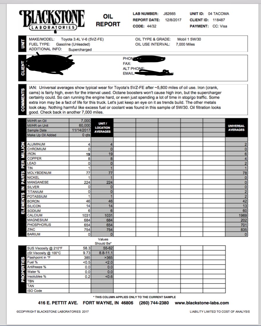

    I'm in the same boat. What oil are you running, and what oil change interval? The most common advice I've gotten is use a high quality oil, and change it more often.
    The particles that make up the majority of the suspended solids in the oil are small and dispersed enough that they'll never come in close contact with a magnetic plug. You may remove some of the larger stuff that would settle out anyway, but that's not what you're seeing in your oil analysis report.
  16. Aug 22, 2018 at 9:51 PM
    License2Ill
    License2Ill Woke like a Coma Toyota Tacoma
    May 20, 2012
    #79174
    2,252
    Ian
    It's a dry heat thou, AZ
    2004 SC'd 5VZ DC 5spd 4x4 TRD.GOV
    Bailing wire & Duct tape
    Thank you sir for replying.
    I'm seeing the same in the research I've done.
    Running Mobil 1 syn 5-30. 7k intervals. Mobile 1 seems to draw flack on the high iron in used oil tests.
    Prior to (the 2)7k intervals, I was doing 3-4k changes.
    I'm going to start with dino or blended vavoline 10w-40.
    The test before this one was slightly high. This recent test was about 5x higher.
    I made sure to dismantle the oil filter (oem). No noticable debris.
    I'll edit my post to include my two uoa's when im on by computer.
    drr[QUOTED] likes this.

    Yeah my most recent UOA's got progressively worse as well. I was running 7.5k intervals with M1 5-30 also.
    I have since switched to Rotella T6 5-40, all the research points to the "diesel" oils to be much better at suspending particulate matter, as well as having additives that decrease bearing wear, which accounts for a lot of the iron content. I'm also going to a 5k oil change interval.
    I'd be curious how the dino oil compares.
    I think high wear is also just a fact of life with forced induction, considering you're putting things under a lot of pressure that weren't really designed for that in the first place. We may not hit the million mile club, but I think these motors will last for a long time regardless.

    Well, good lord. I've found exactly the same thing. Only spent about 14 hours doing so. :bananadead: Thanks for the reaffirmation. Cheers to you.:cheers: :drunk:
    Uploaded my two UOA btw .

    Btw are you showing any other wear? Only thing I'm showing is iron. Nothing else.

    I have slightly high aluminum as well, but one of my heads is kinda fucked (ejected a spark plug, had to drill it out, tap it, helicoil, etc.) so I'm guessing that's where the Al is coming from.
    My iron numbers are not as high as yours though. There are also a number of people (I'm sure you've seen) who are fairly skeptical about Blackstone reports, or any UOA for that matter. It may be a case of "take it with a grain of salt."
    Here are my UOA's
