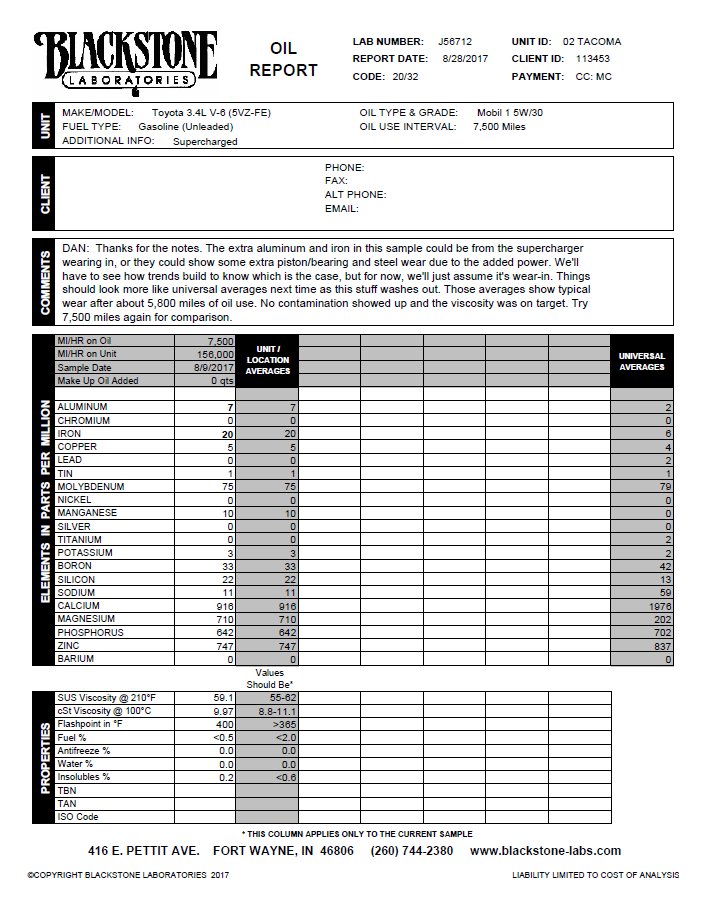

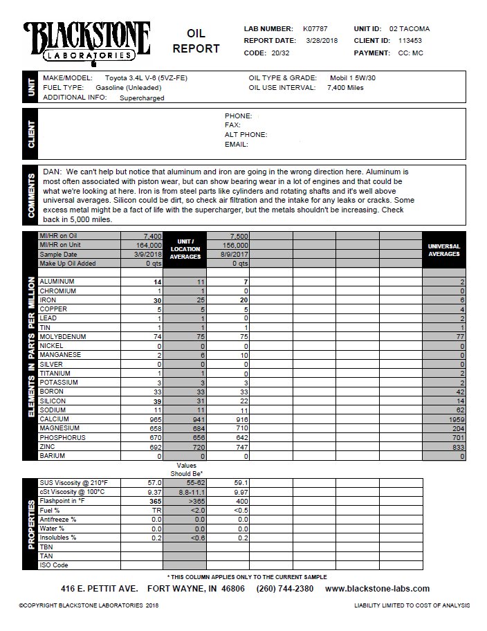

    Yeah I wonder how the two tests would compare. It would be good to have a discussion about this, but I don't think most people even bother with UOAs. The most information I could find was on bobistheoilguy, but I didn't see anyone with a SC'd tacoma specifically.

    Supercharger life. Those numbers aren't excessively high honestly, its just the 3.4L is a low wearing engine. There is no timing chain and it operates where the engine is oftentmes lugged along (Under 2,000 RPM) as opposed to a high strung 4 or 3 cyl engine which needs to be at 4K regularly. Its also a 16 year old vehicle.

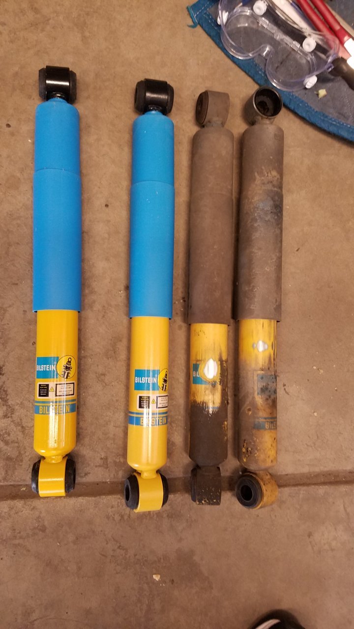

    Sometimes I just forget what a beating shocks take .
    70,000 miles on them and didnt realize how beat they really were until I took them off

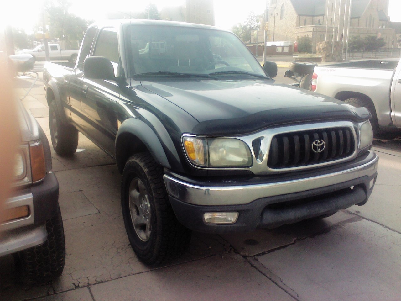

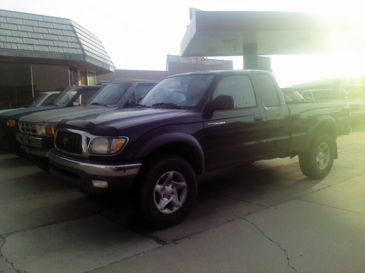

    Picked up this '01 SR5 TRD yesterday after a 3 year sabbatical from 1st gens. Bought it cheap, knocking engine, so we'll be doing the swap soon.

    That level of Aluminum and Iron really isn't anything that would shorten engine life.

    What's it cost to send in a sample and get back a report like this? Interested in doing it myself.

    Yeah it would be interesting to see what your wear numbers look like. I’m not concerned about my slightly elevated wear, just going to keep an eye on it occasionally as a diagnostic tool.
    It’s $28 from Blackstone, it’s more expensive from Dyson but you supposedly get a more thorough analysis and commentary.

    I bet with the NA motors you’ll see right about the expected wear. That’s another good point though, my numbers and @License2Ill are being compared to universal averages which are mostly NA, when compared to other SC’d motors I wonder how they’d stack up.
