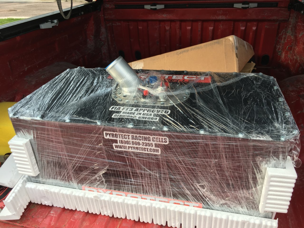

    Fuel for dayssssss....32 gallons. :woot:

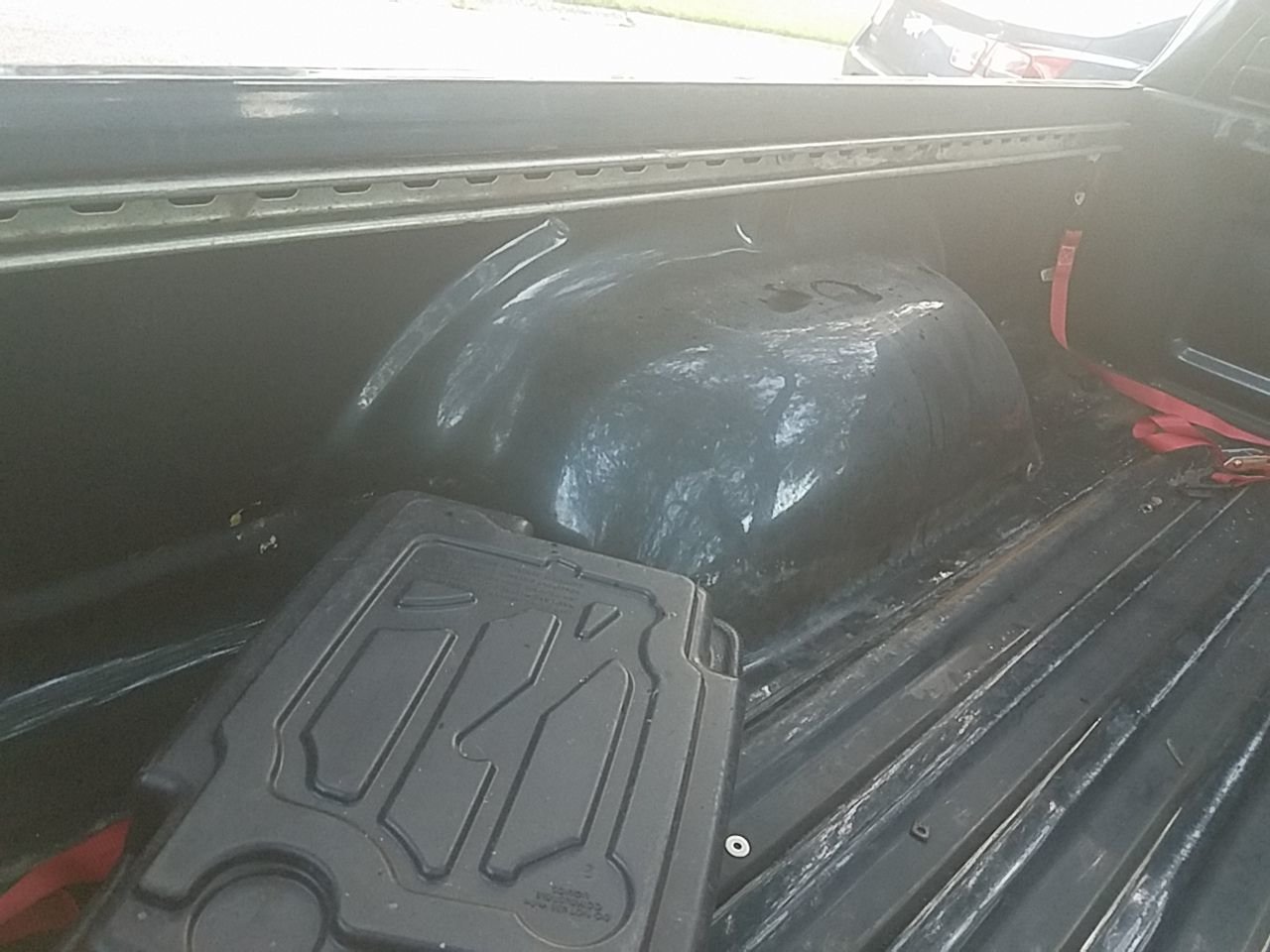

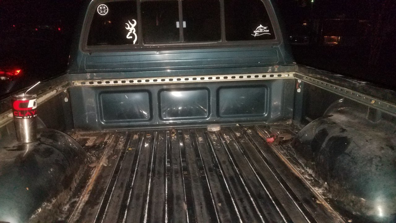

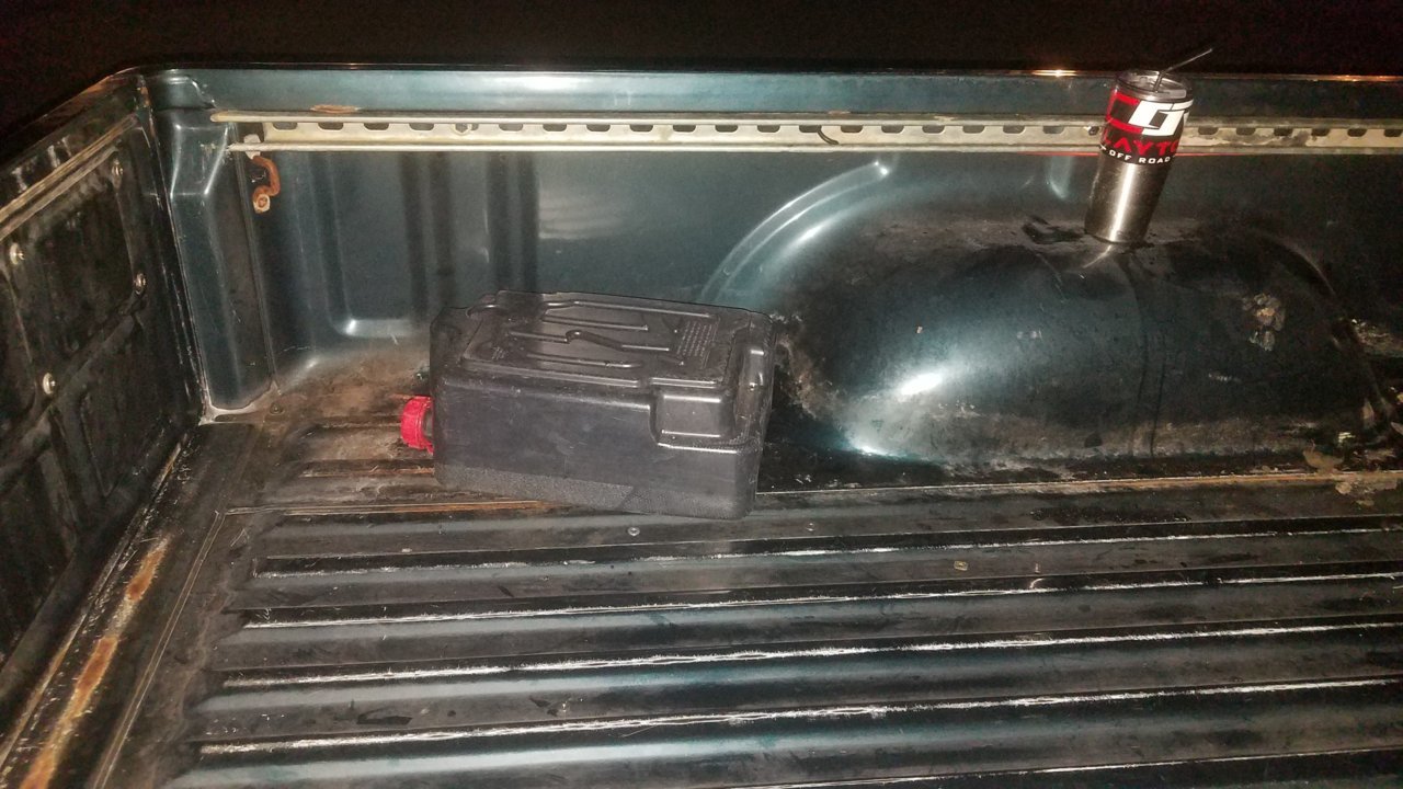

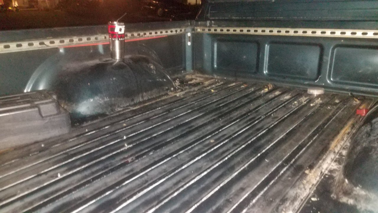

    3/8-16 Nutserts. For now there are two on each side, and two on the front. I used the deep unistrut on the side rails, and the shallow on the front. There is some custom cutting needed at the end to clear the angled bulkhead. I originally thought to add more nutserts at a future date (I only had a handful on me so I went with the surfaces that are flat to the rail first). I am going to use angle brackets to join the three pieces at the front corners, and I bolted up my toolbox into them tonight (drilled through the top of the bed sides, and into the side of the unistrut, then installed nutserts there as well). That along has strengthened the entire assembly like crazy. I am going to add another strip of shallow unistrut to the front of the box as well, to attach my hilift and odd and sods. I will probably grab a half dozen or so spring nuts and put them in the front strut rail and bolt the box in there as well.

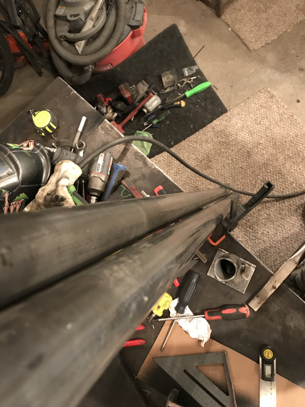

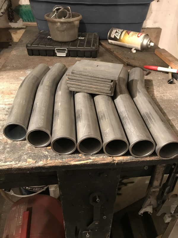

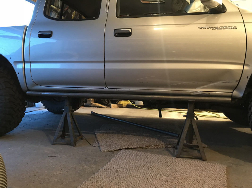

    Got cracking on some sliders.
    Found some plate
    I’ve got this planned. A little different than the old Tacoma and a little different than the 4runner sliders I made.

    You mentioned using a plasma cutter, was that to cut the unistrut? Not cutting into the bed, right?

    Correct. I was freehanding the ends of the strut, but a cutoff wheel on a grinder made it much easier. I only used the plasma because I had it (and now the damn contactor circuit is acting up, so I will be putting my Electronics Guy hat on soon to address that).
    This is completely doable with hand tools. Drill motor, drill index, angle grinder, cut/flap disks, ratchet set, that's about it. The only "special" tools needed are nutserts (ok, more of hardware than tools, but whatever) and a nutsert tool. Some folks have success with a couple wrenches and a thrust washer to manually compress nutserts, but I personally don't have 3 hands to manage that, so just bought the tool. It's been WELL worth it, best tool I have bought this year.

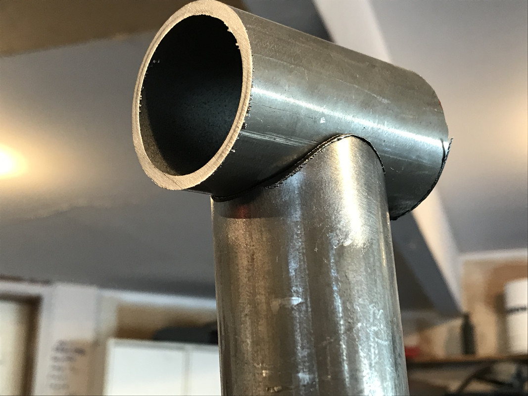

    Oops commented in wrong place. Meant to say "Very nice fishmouth for your connection. How did you form it?"

    Thanks man, 2 cuts with a cut off wheel and 30 seconds on a bench grinder.

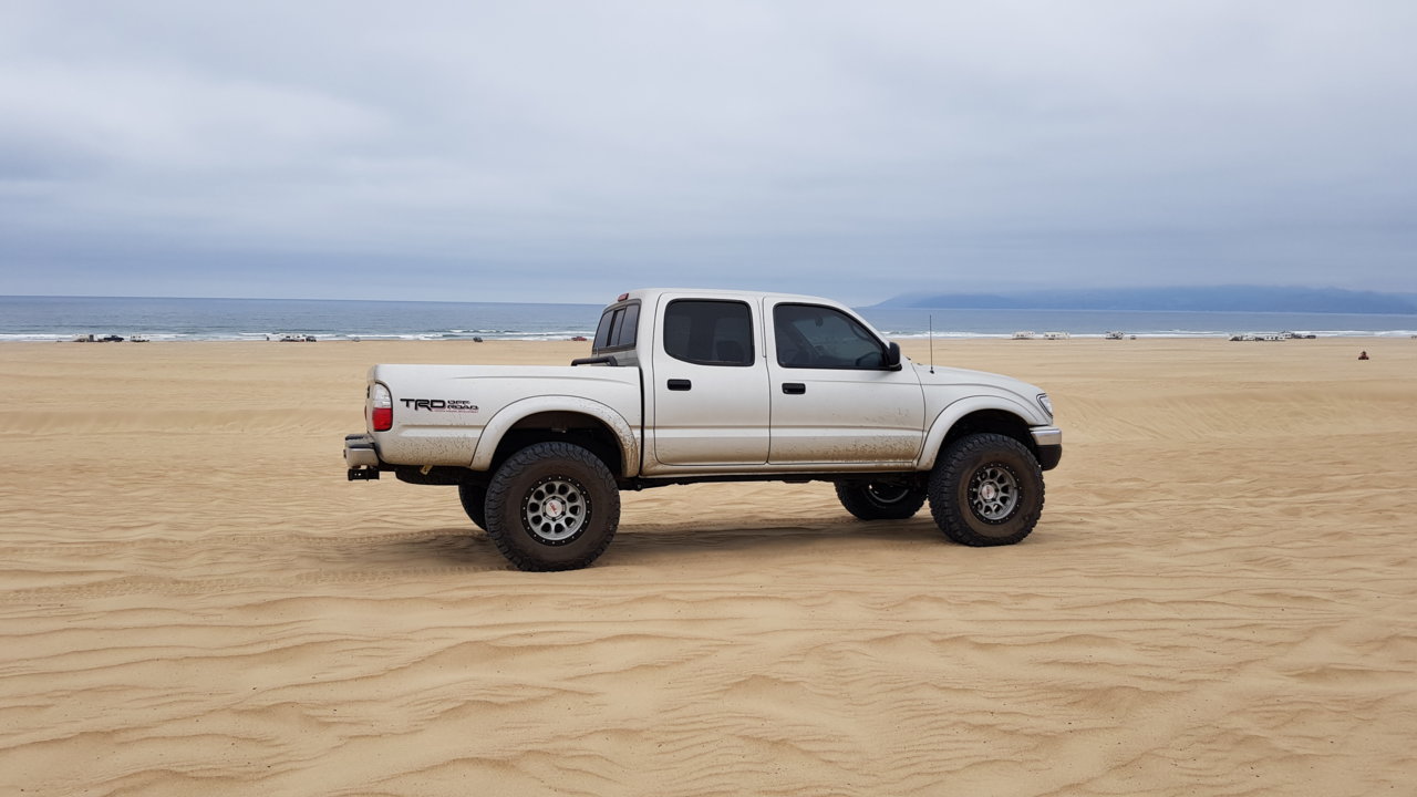

    And stuck. :rofl:
    But surprisingly we got out pretty easy.

    brings up some flashbacks from my Pismo trip. Even with 4wd if you slow down in that deep sand, you're 'effed. Had to air down to < ~8psi a few times to get myself unstuck lol.
