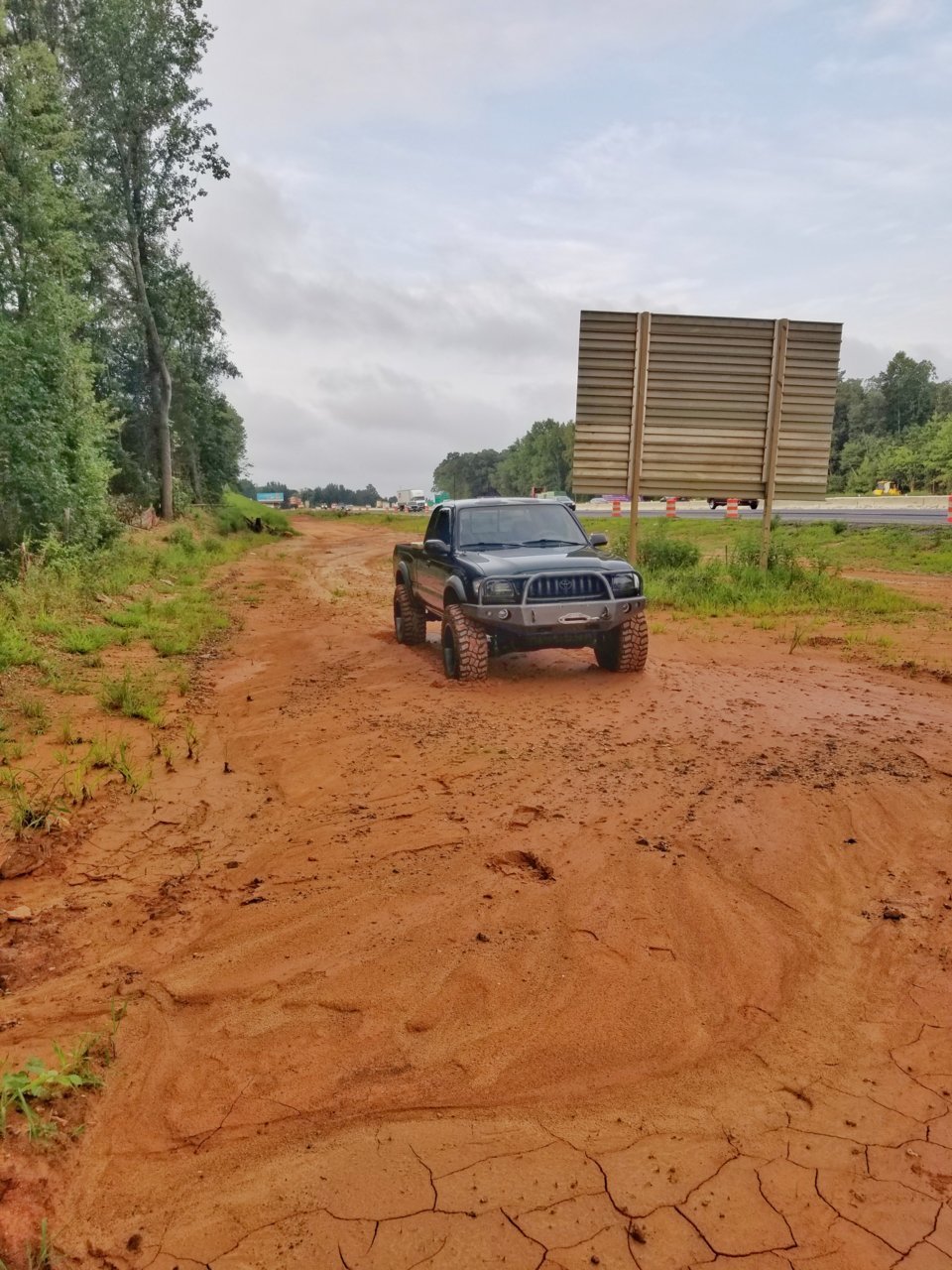

    Yea..that stance is nice

    Only factory 4.5 bs with 10" wheels
    Tires are pretty much a narrow 295
    Now its 8" wheel with 275s

    Those are 275/70r18 (33.4x11.3) on 18x10s with 4.5bs
    It was perfect. Been self clearancing for the past year as well so almost no rubbing

    275/70r17 32.2x11 I think
    Only lost 20lbs per wheel, due to the motometals.
    Should've went with the at3s. Lot lighter and c load

    I think it looks good but I’m partial to those wheels. I got a set just waiting to go on. Been waiting a while now actually...

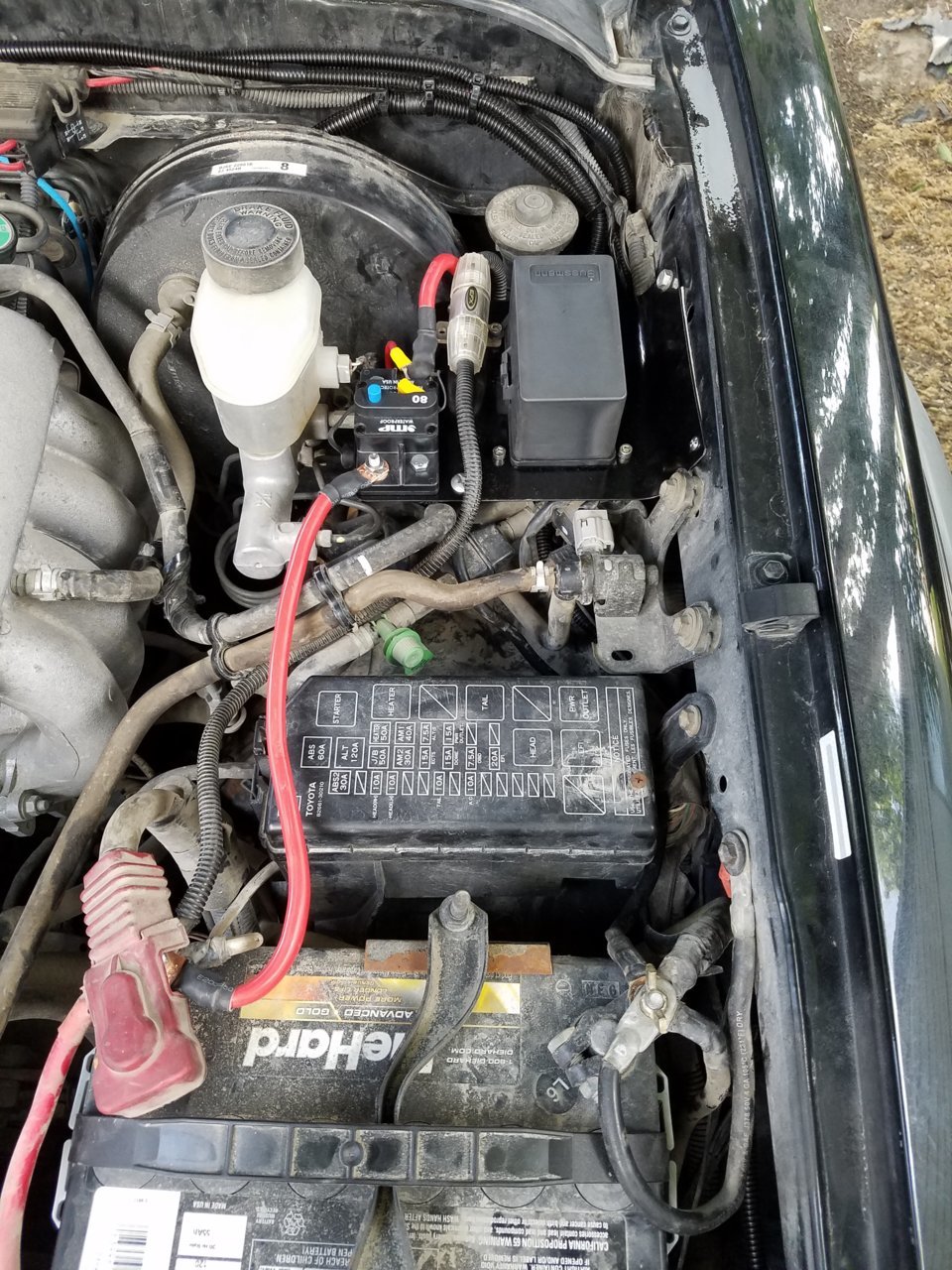

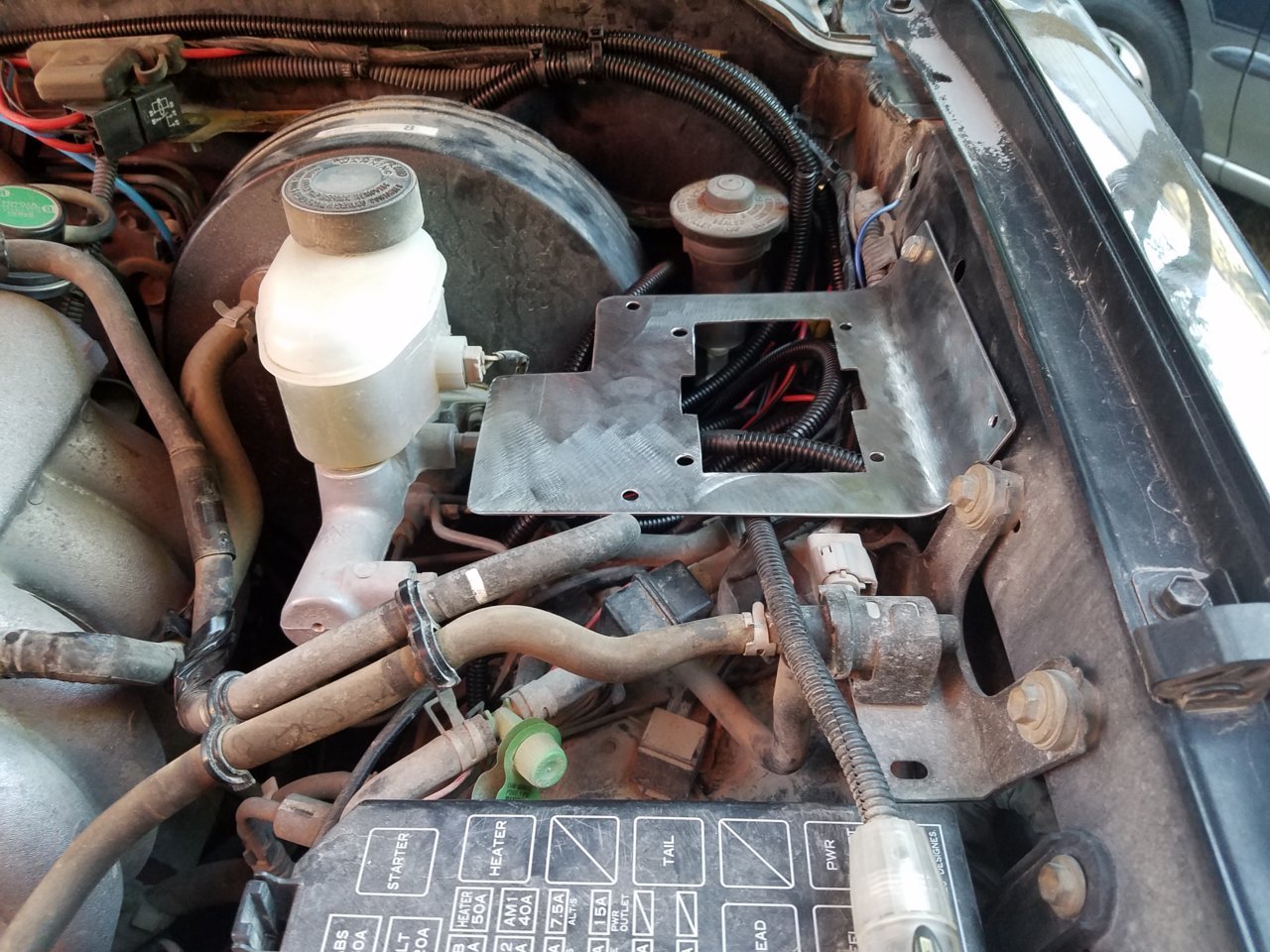

    I made a small bracket and mounted it by the booster.

    Ah okay. I wish I could put mine there but I have the charcoal canister in the way

    Unfortunately for us 1995-2000 guys, the charcoal canister is mounted there. Absolutely no space to mount something like that. Maybe the 1995-1997 trucks can get away with it since it's only a small cylinder as compared to the newer one - but forget about it on 1998-2000 trucks.

    01-04 has space there lol

    I know. On 2001-2004 trucks, the charcoal canister is under the bed perpendicular to the fuel tank.

    Not on Cali trucks

    I have a cali truck and that space is empty. No egr

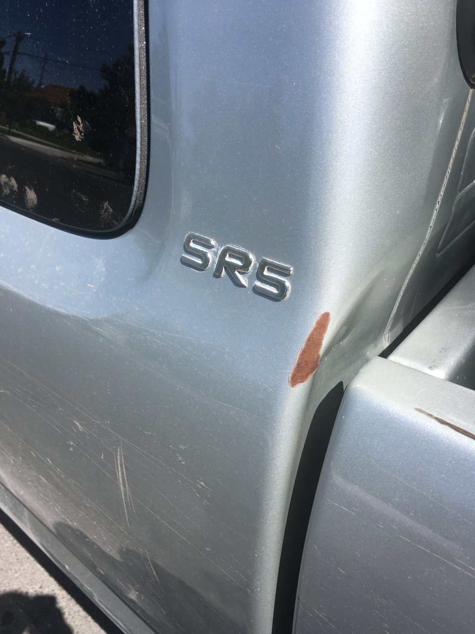

    Frame flex, or possible collision damage. You could probably go inside the cab and work some/most of the dent back out. But then it would likely require some filler and sanding. Lots more work, and probably not worth it (at least not to me, but...)

    Mine's not empty.

    That sucks
    Mine is empty there but the abs takes up all the space on the other side

    Truck caught air and had a hard landing.

    You guys are all saying terrible things haha.
    This is literally the only thing I can find wrong with it, other than the broken door handle.

    02-04 has the canister under the truck.. my 01 and all the other 01 canisters are under the hood.
