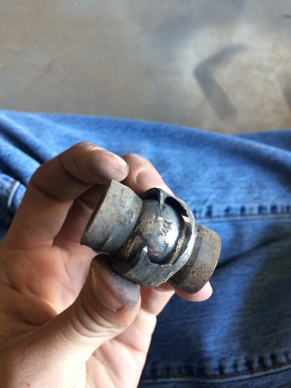

    Regular maintenance is key, or else you get stuff like this lol

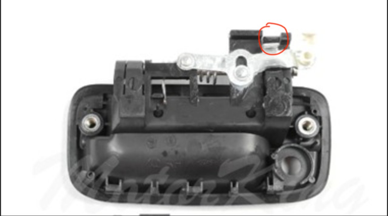

    I stand by the Dorman door handles. I posted a lot about my door handle fiasco on this thread awhile back but I had a few OEM ones break on me all within a couple months of one another...they all broke because the little black/plastic lip inside the handle that engages the opening mechanism is small on the OEM handles but on the Dorman units it's nearly twice as big. Hard to explain without a photo or video showing it. But ever since I got frustrated with how much it was costing me and just bought some lesser expensive Dorman handles, they stopped breaking. Been several months now and the Dormans have lasted perfectly.
    The handle design is just weak to begin with...my original ones broke because the plastic handle itself cracked from use. The further away from the lock that you grab them, the more stress it puts on the plastic. Gotta open the handles from right next to the lock.

    Found a pic, for me it was the red circled part...that black lip that presses down on the metal arm that opens the door. It would always start to slip and not engage the arm at all, but the Dorman units have a bigger lip that won't slip off.
