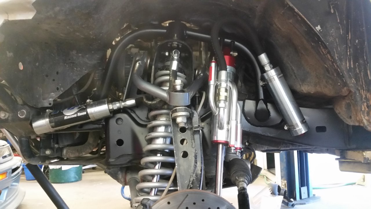

    Love the engineering here, but I personally can't see putting that much in an IFS system.
    Don't get me wrong, love the truck. That just seems like it's going to constantly require maintenance.

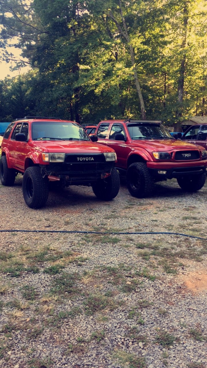

    It’s my honor to present you my Tacoma’s new bae. She’s a 98 4Runner Limited 4x4 with 350k miles. Purchased her for 800$ in May. Since then she’s gone green to red, replaced valve cover gaskets, lower control arm bushings (worn out because of the valve cover leak), transmission solenoids, rear main seal, rebuilt starter and alternator, driver side rear wheel bearing, front passenger side wheel bearing, CV axles, differential bushings, windshield, and finally the leather seats! She’s come a long way since then and I’ve spent a little over 1800$ Including the purchase of the 4Runner.
    Was it worth it? I say yes since I have a sunroof :D
    All work, except the paint job, was done by me:muscleflexing:
    And no, I haven’t been able to track down a used bumper for a limited and yes my turn signals are zip tied. :rofl:

    Oh yes, there is lots of up keep. I try to take care of things before they can be a problem on the trail. Just comes with the territory

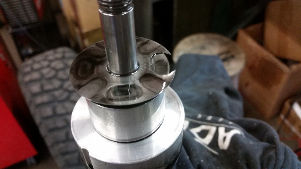

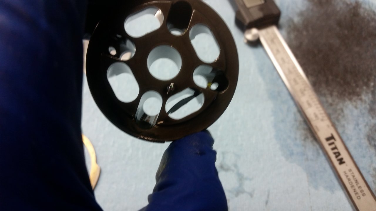

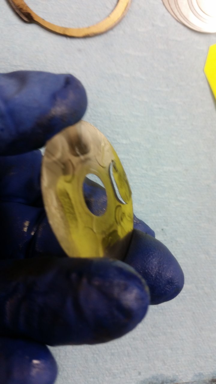

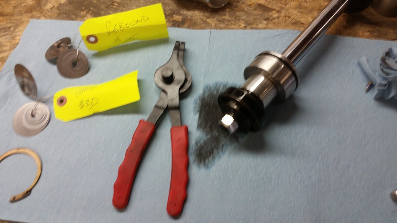

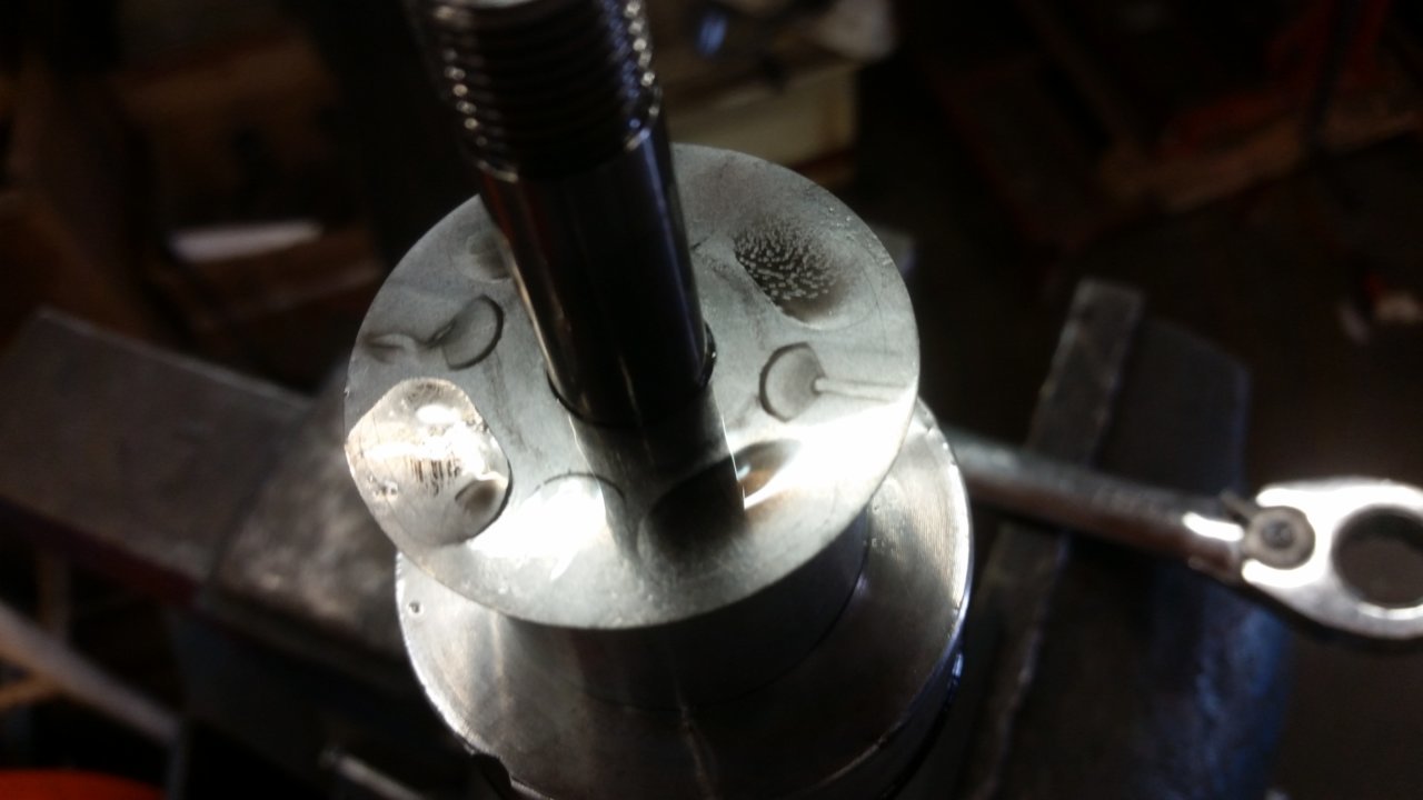

    I'm glad I added the bypasses, during revalve of passenger shock I found this...
    Even better was the hole punched shim was wedged in the piston. Guess next time I add flutters it will be after two shims. I'm back on base pyramid scheme valving to start with the bypass tube tuning, so not worried about this again.

    IFS isn't as bad as people say it is. Don't get me wrong, the amount of torque you can get out of solid axle is crazy. But IFS handles speed so much better. I like speed.
