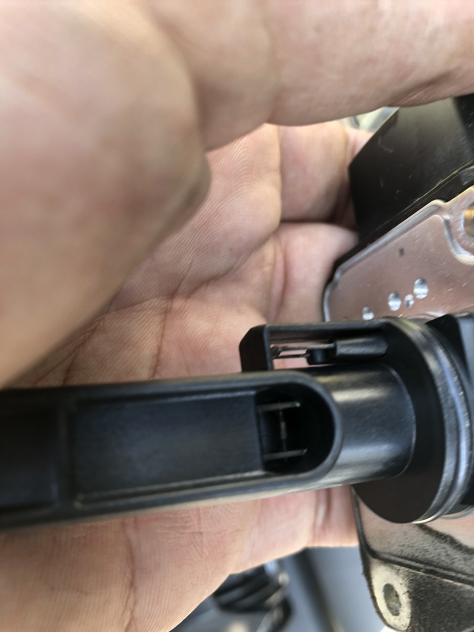

    @tony2018 So I pulled the MAF out and it was dirty and oily from the K&N, as expected. I cleaned it off with MAF cleaner and took it for a drive.
    It still does shake in Drive at idle. When you put it into Neutral, it stops.

    How old are your spark plugs and wires?

    They aren’t that old, they were replaced right before I got the truck about three years ago. I’d say 30k miles.
    Idle is rough in park.

    TBS?

    Haven’t checked the throttle body yet. Could be dirty.

    Readiness monitors... if any of them reset then you're going to idle funky until they all pass. Either that or that MAF is wonky because of that oil residue from that K&N. My non-stinkbug stance opinion, DUMP that K&N and its oily crap and either put the stock back in or use an AFE Dry.

    It’s been idling like that for quite some time. I suspect it’s the junkyard tranny I used.

    I might go for the AFE dry. That’s a good idea.

    Have you checked the atf

    Dry filter is worth it. Thats what i have

    Whats wrong with stock? There is no power increase seen in the 3RZ by running a ricer intake.
