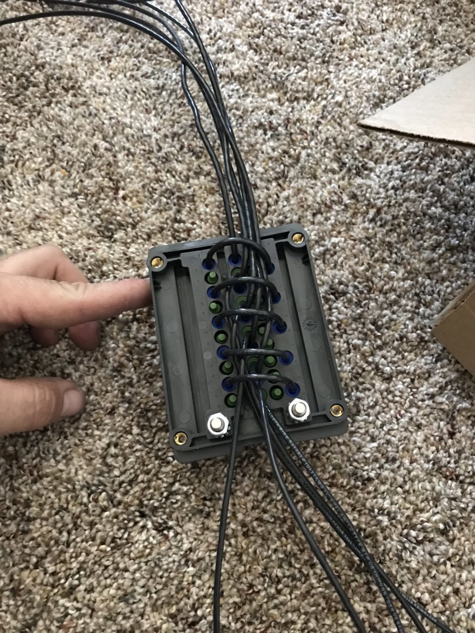

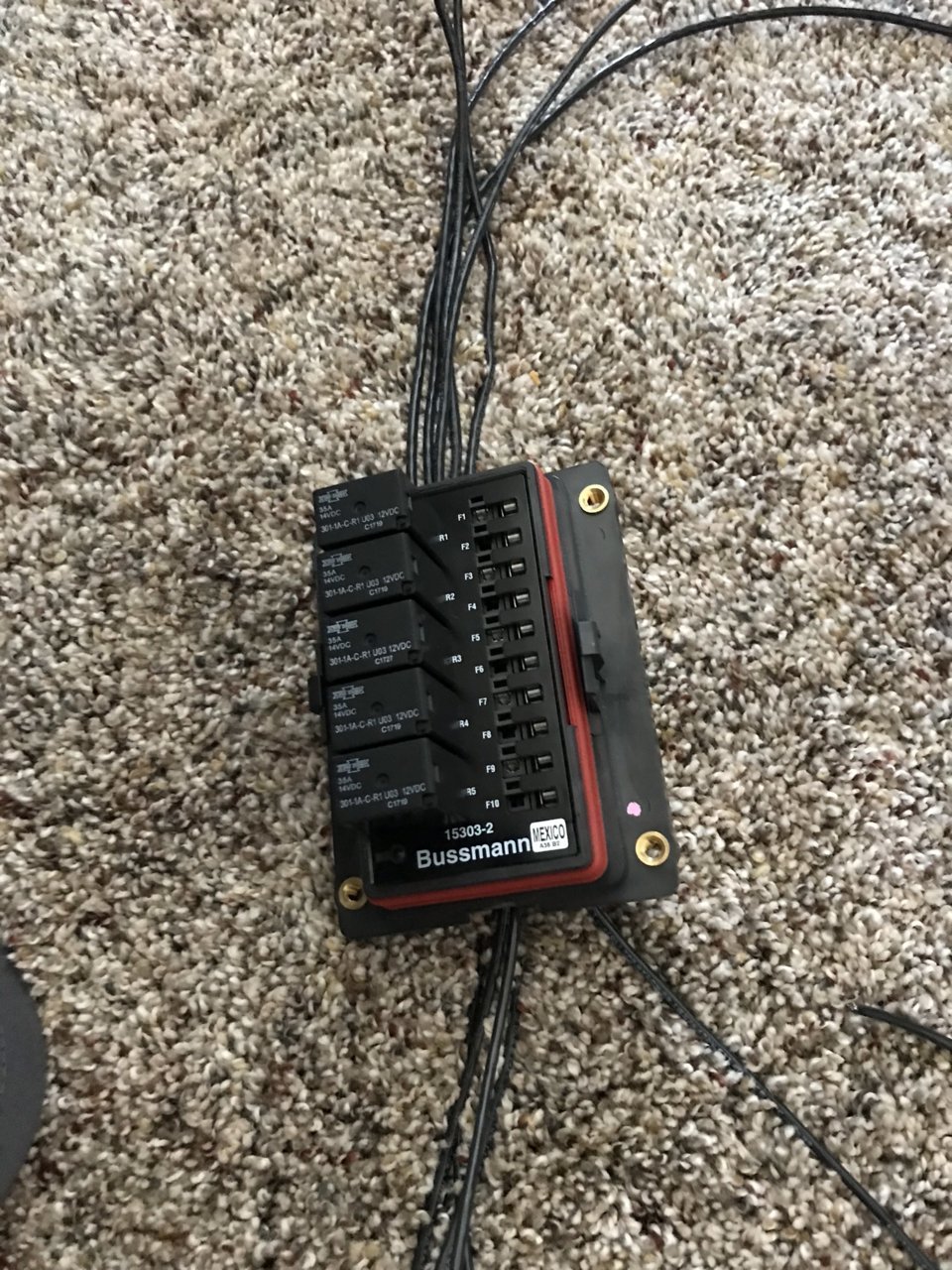

    Do one of these @Uphillshunter
    burntkat, Dan8906[QUOTED] and SR-71A like this.

    Ok... WITAF is that spaghetti? lol
    I think a more acurate statement is >WE< should do one of these. If I tried to do that on my own, I'd do it wrong and lite my truck on fire.
