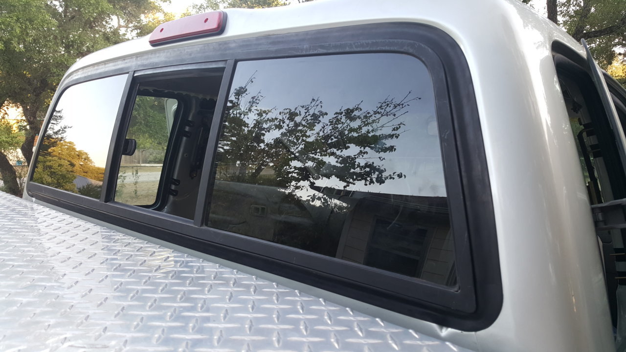

    I just swapped my solid for a OEM slider 2 weeks ago. Love it so far!
    I did it myself, and let me tell you....Next time I'm paying someone to do it, my fingers fell off from pushing the seal into the frame...:bananadead:

    I can't wait to get mine out back in with a new gasket after the repaint. The state of your gasket show how much my gasket has shrank.

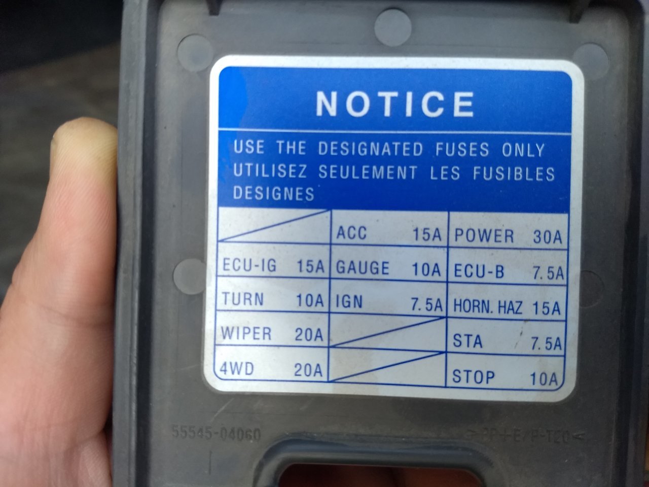

    I'm looking for a power source inside the cab that will power both in the "Accessory" and "on" positions. I want to potentially make a small fused connection to power any other low-draw devices too. I pulled this mirror from a 3rd gen 4runner and it was spliced into a connector behind the driver-side kick panel. I don't know if our trucks have the same power source there or not. Either way, I want to do it right to prevent any battery leeching or electrical problems.

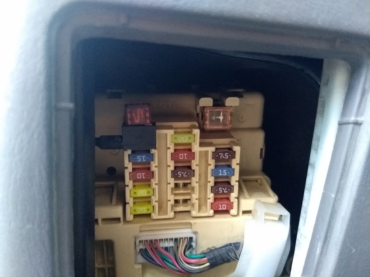

    Okay. I'd use an mini blade atc add-a-fuse. Add it to the interior fuse box and run both circuits off that. You'll have to run the grounds to a cab ground point.
    It'll be Alot easier than removing the seat. Just the lower valence under the steering wheel.
    On my truck the top left fuse holder had an available spot during ACC key-on.
    The slot directly above the 15A ECU-IG fuse.

    Thanks for the pictures. that helps a lot. I like to run off the fuse box if possible to keep everything tidy.

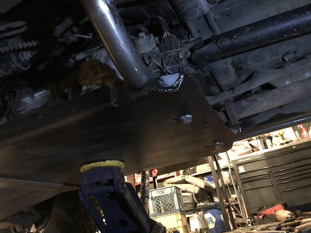

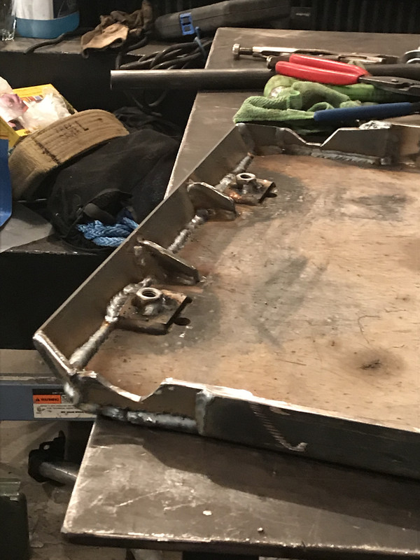

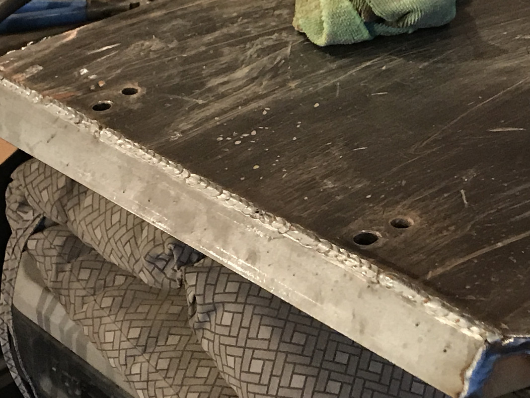

    I had concerns the rear of this skidplate was lacking. And it was a really well functioning dirt scoop. Should be more solid and slide instead of scoop now.
    Now might do my carrier bearing

    I'm not a huge fan of add-a fuse's, but at least they're not a quick-splice which nicks your oem wiring harness. They're fairly clean and completely removable.
    The one I have the picture of is to power my fridge monitor. I ran the wire up the A-piller behind the Oh-shit handle bezel and tucked it up underneath the head-liner. Worked out pretty well.
