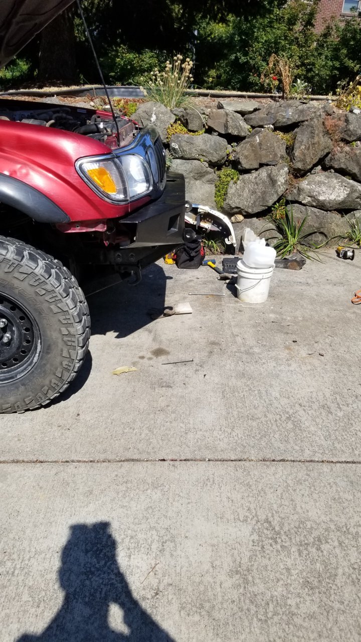

    Trucks officially going back together, got a huge start on it today.... I installed the spare tire carrier. At this rate it’ll be done before 2024.

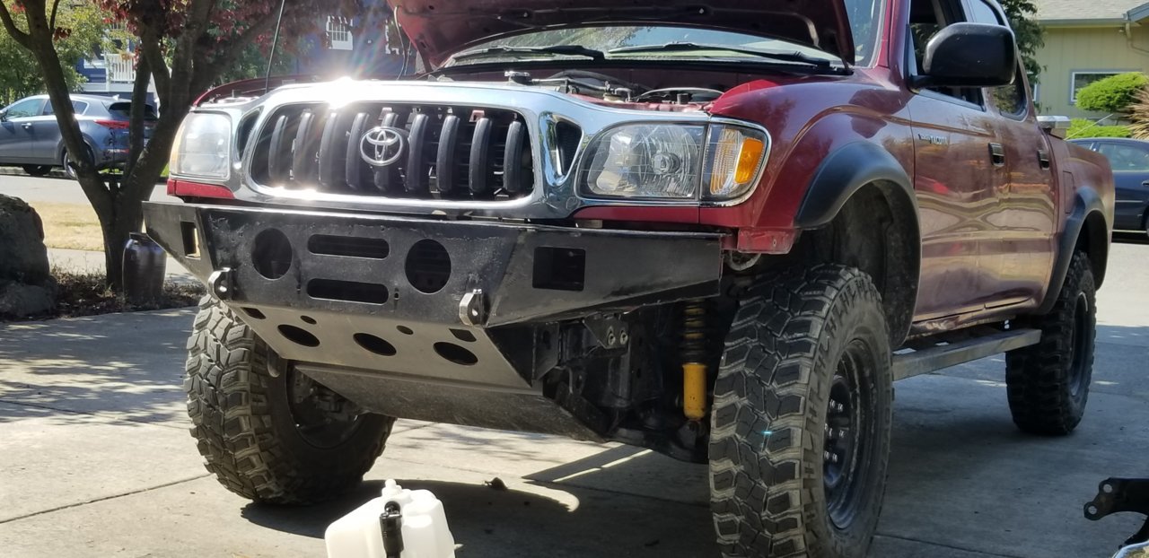

    @Speedytech7 i trimmed both the side wings out personal preference. It fits up good though. I still want to plug weld all the mounting holes and re drill them so they are not slotted, then add the stiffeners inside. It is attached solid and has a new adventure now. Thank you man much appreciated. A shot from up at the lake the other day. Finally made mounts for my shocks from @joshcook if I remember right. Time to ditch the OEM leafs.

    Damn, good job dude. It looks so much better than the mangled mess I handed yah haha. Looks awesome without the goofy tubes and the chopped wings are bitchin. Glad it's gonna continue to get use! Thanks again for all your help with the welding on my beater!

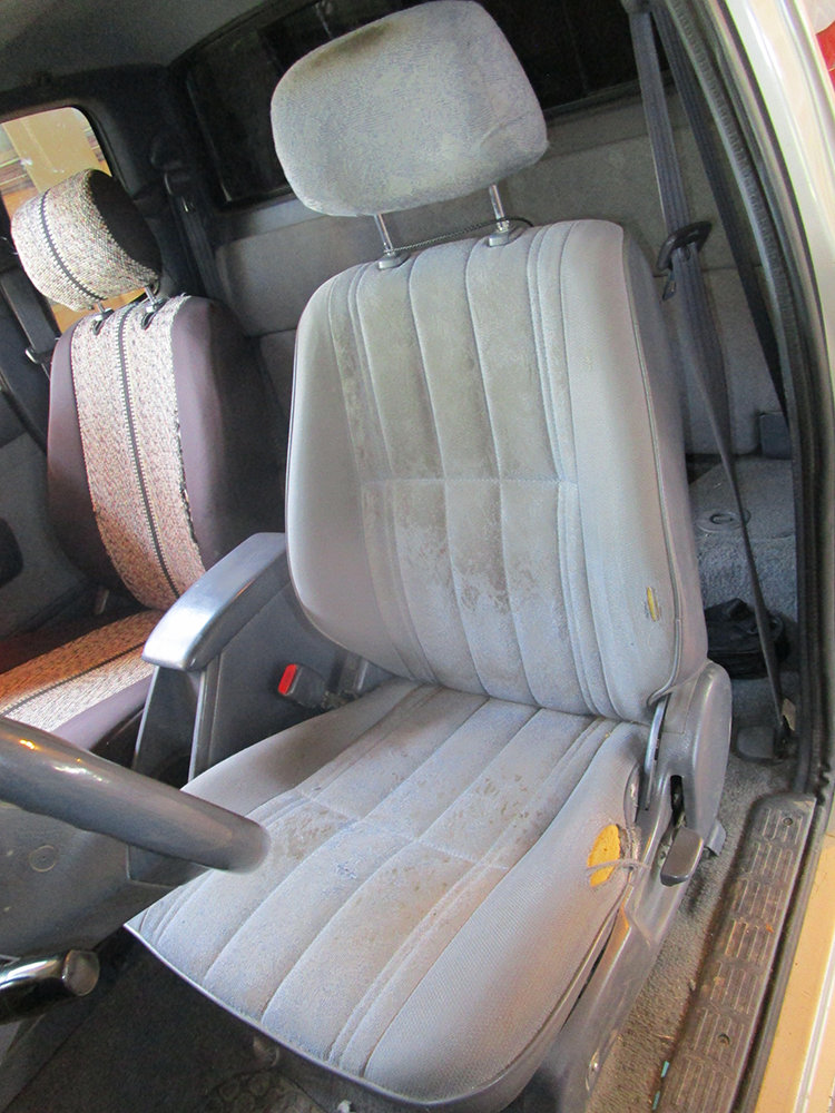

    I reupholstered my seat with leather.
    Before:
    After:

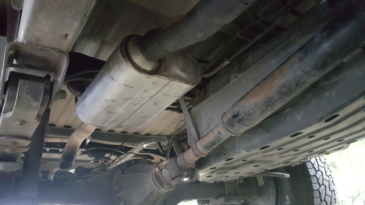

    Installed a Flowmaster 40 tonight.
    There was a dynomax on and it was rusting on the seems pretty badly. I scored this and installed it with no problems.
    Sounds great! :thumbsup:

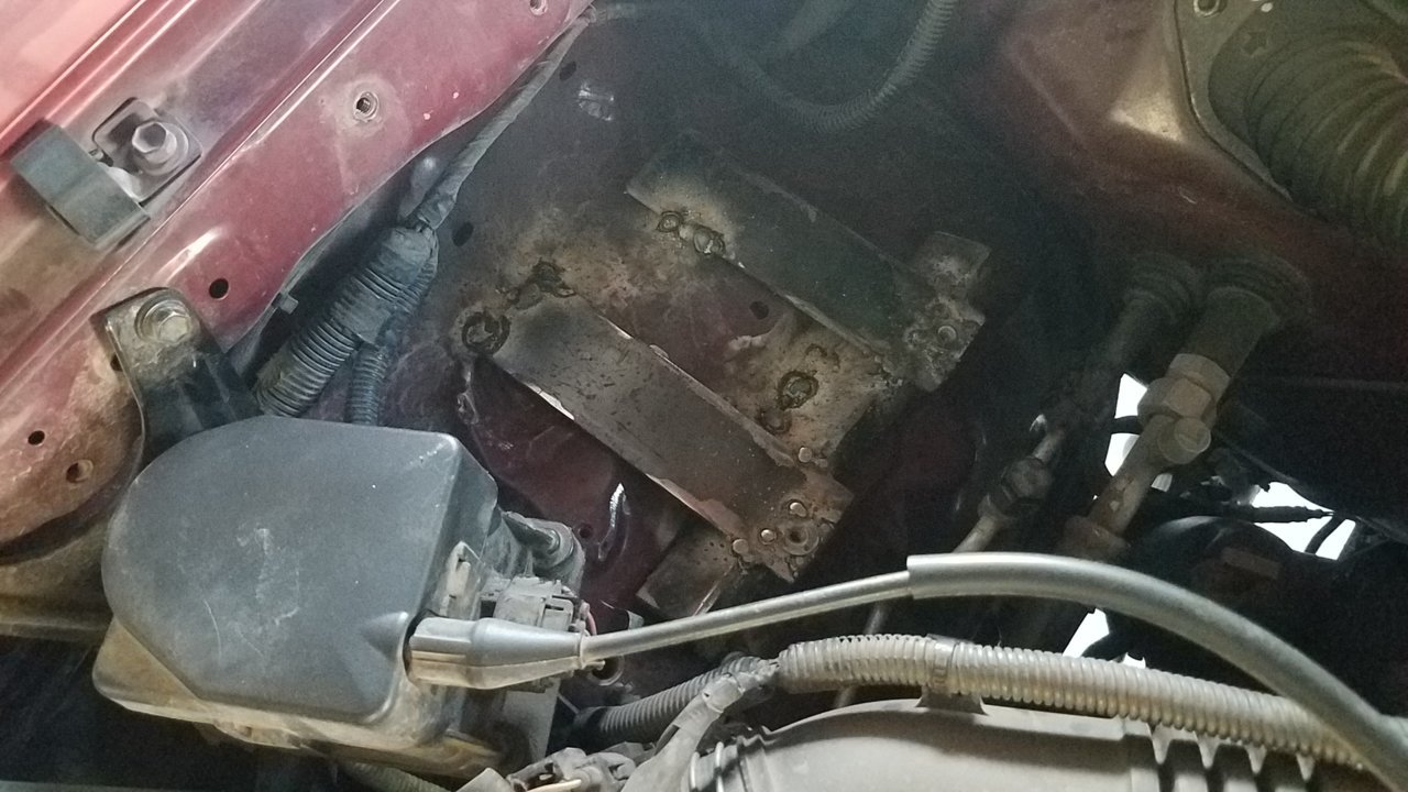

    Here you go.
    Used a piece of 1x1 angle iron and two pieces of 2 inch wide flat. Layed the flat stock in there and adjusted the angle iron to make the flat stock lay flat.
    Welds look horrible cause I'm using a cheap, borrowed, flux welder... space was tight... and, well, I never claimed to be a good welder. But the connection is strong as fuck, and I only almost lit my truck on fire twice (or maybe 3 times)
    Tack welded these doohickies to the base so I have 2 points to attach the battery tray on the bottom.
    I'm using one of the stock bracket screws, that was there before I moved things out of the way for the battery, for the top mounting connection.
    There were a few bumps in the fenderwell (from the factory) that were making everything not want to lay flat.... so I beat those with a big f'n hammer till they cooperated.
    Hosed down the base with Rubberized Undercoating
    And voila!

    That does look real nice though :thumbsup:

    Looks close enough to arc the hood almost.
