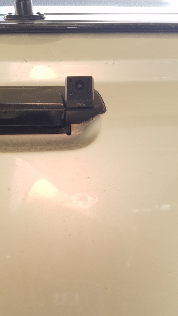

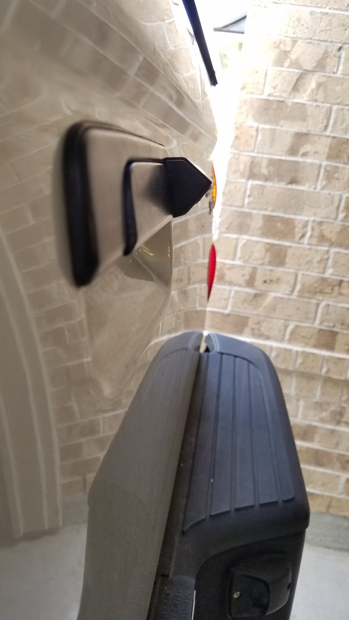

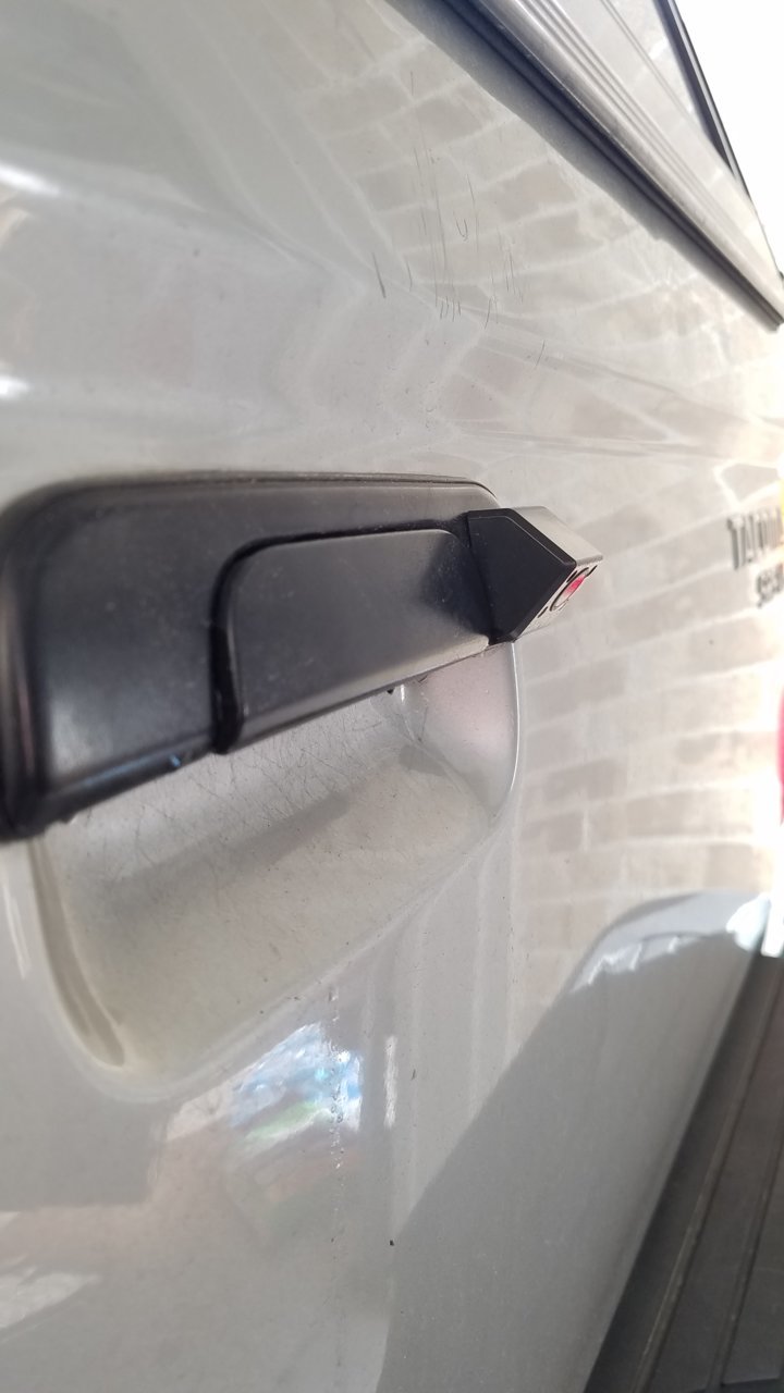

    I really considered this when I was installing mine. Do you have any images of what you can see through the camera with it in that location?

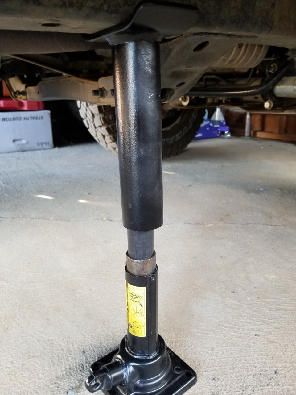

    Figured out that the factory jack wouldn't extend far enough to get the front wheels off the ground. Hi lift isn't an option until I get around to installing sliders I've had laying around. Want to keep factory jack, so made an extension that also fits into the same cubby as the jack. Gave me another 3 1/2" jack height.

    I may fab one of these up... What do you have inside the tube? solid stock or a plate welded in there?

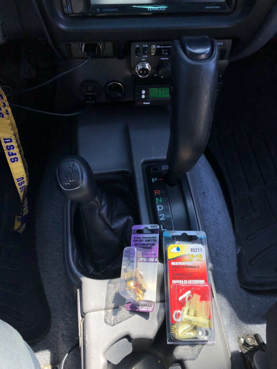

    Killswitch is happening. I think I’m going to wire it in-line with the EFI fuse in the integration module.
    The Tacoma is one of the most stolen vehicles in San Francisco, so I’m taking precautions. Haha. It’s stupidly easy to Hotwire these trucks.

    Solid , welded in top and bottom

    I would wire in the kill switch to the ground wire in the kick panel for the fuel pump. It would start, then die.

    Would this potentially damage anything? I doubt it, but would be nervous that it would put strain on some component in the fuel system.

    That's a better idea. Where would I find the ground wire? Hard to figure out which ground wire is for what since they're all black/white.
