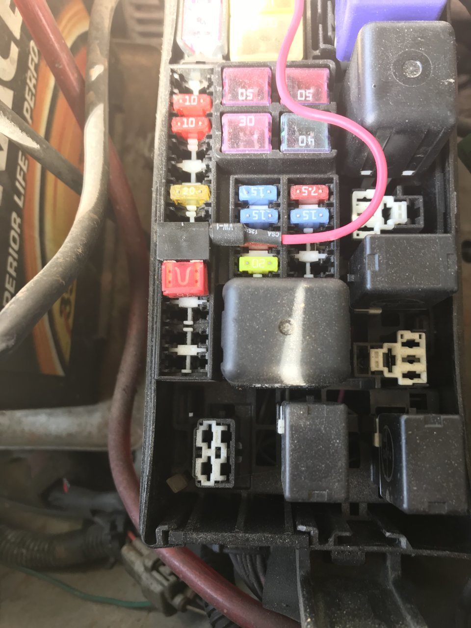

    Not sure if anyone fully answered your question, but here is were I tapped on my fuse block, with an add a circuit, under the hood, for the power to actuate my dual battery relay (and a bunch of other relays for lights, etc. It is the fifth one up on the left side, and I believe it is for the air conditioning. It only has power when the ignition is in the on position, not accessory, which is perfect for separating the two batteries.

    Thank you! That answers my question.
    @foxrcing07 ... this is where I'll tap for my relay/isolator.
