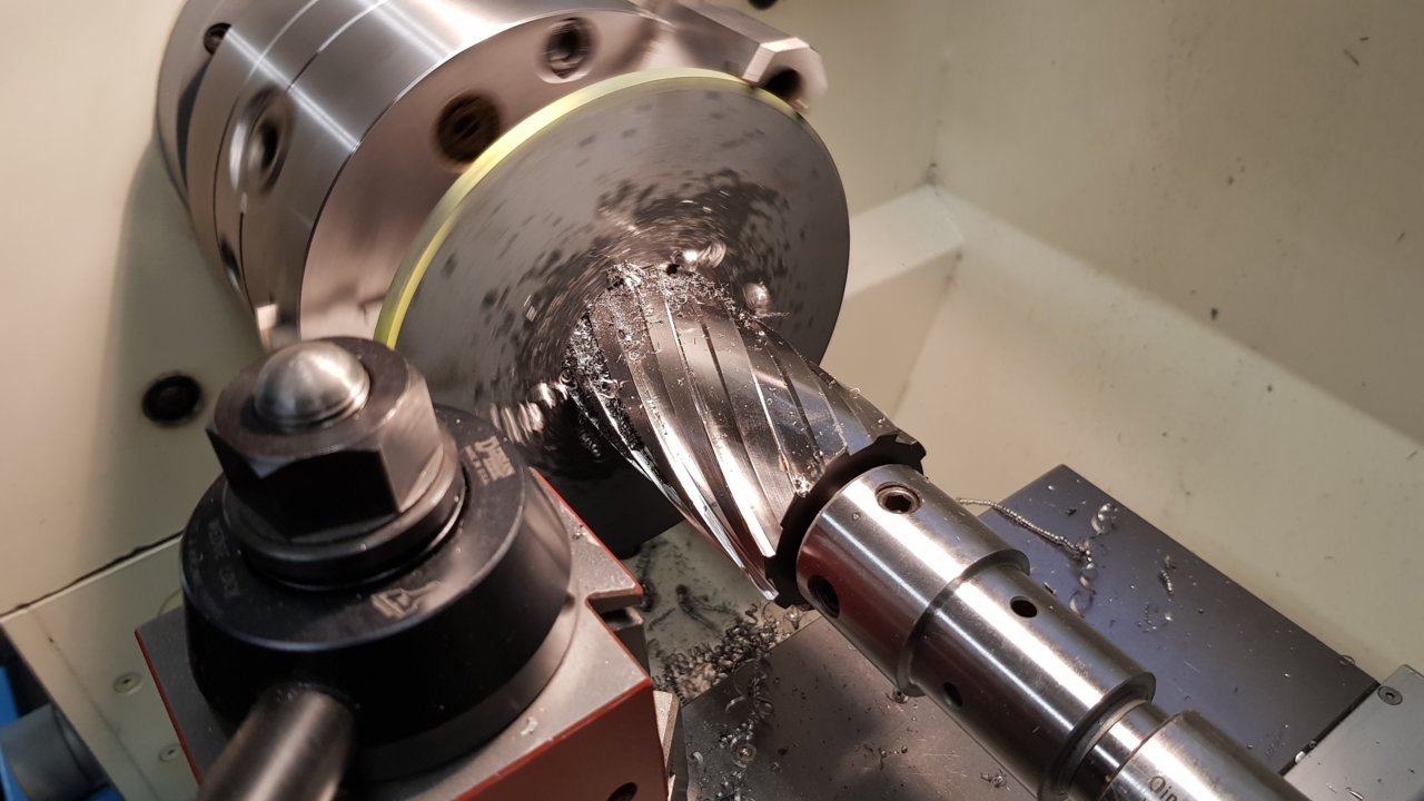

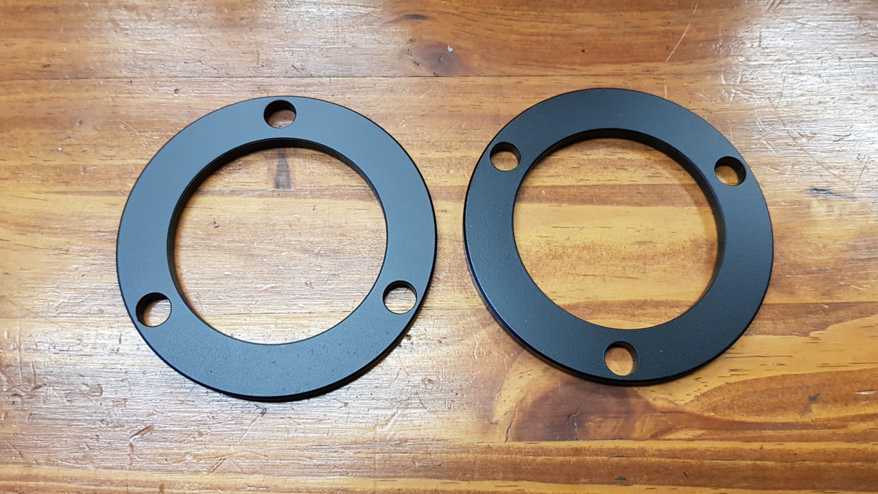

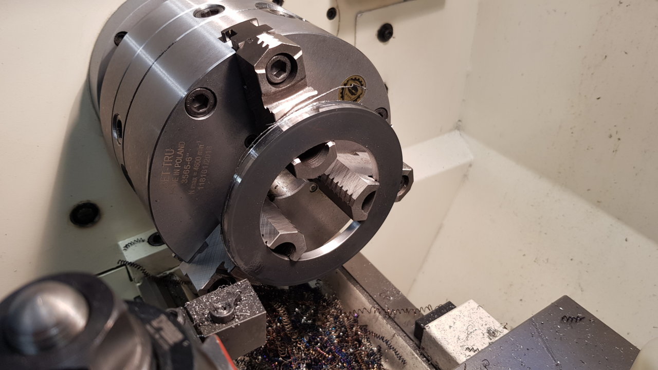

    Thanks for the pic.
    Made me a set last night, now to get them welded on.
    20180914_113150.jpg 20180913_230243.jpg 20180913_164625.jpg 20180913_143846.jpg

    That's a huge counter bore

    Yeah it needs to fit over the raised lip on the top of the shock tower. I didn't make it a close fit since there's a radius there, didn't see a need to spend more time making it a close fit.

    I'm surprised no one makes these. Really easy to make, not by me though.....
    @Speedytech7 I can make them for you but to be honest it won't be worth it if I make them. They not a precision part so they don't need to be machined.
    Just the material alone cost me $27. They only need to be roughly 4-3/8" dia & my local supplier only sells 4" & 6" round plate. So I had to buy 6" & turn it down, lots of wasted material & wasted of time. I have 5" solid round bar but that would have taken me much longer to machine these so I paid the price for the round plates. It took me hours to make these. I don't have CNC machines either.
    Ideally it would be best to have them cut out on a water jet or cnc plamsa. Much quicker & easier. I only machined them cause I can & cause I needed them today. Otherwise I would have had them burned out by someone. Get a bunch of them made so you can make some money on it too.
    With that said I can make em for you but you'd think I'm crazy for the price I'd have to charge.
