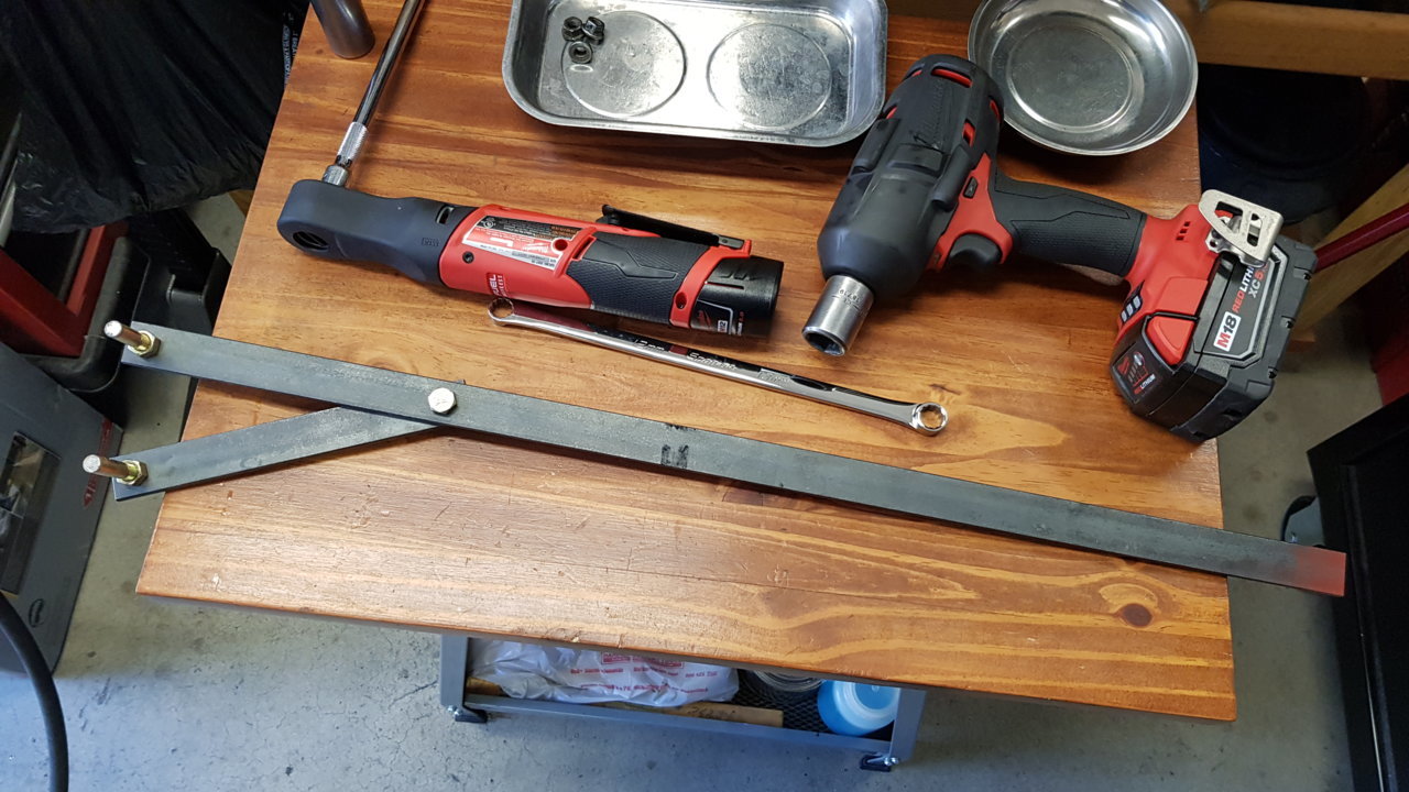

    Donahoe CO, Donahoe Rear Resi, Deaver J59, 16" Pro Comp, 33" BFG AT, Hayden Trans Oil Cooler, Oil Filter Relocator, FM 40, ES Bushings, Beefed CB Drop, Deckplate, K&N Drop-In, DO Bed Bar, Cobra 75 WXST, Firestik Firefly, Philips D1R, Clarion Remote Start, Husky Liners
    Forget 90 psi, try turning your regulator up, as high as you compressor goes.
    If that don't work, does the pulley have 2 holes like the 5VZ? Really easy to make the tool.

    It does indeed have two holes. I might have to try that.
