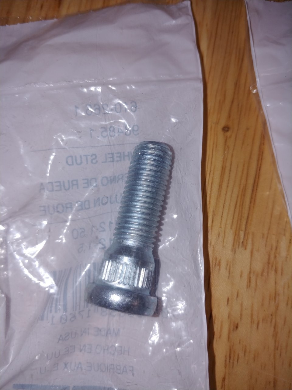

    Are they really that easy to change? I remember on some cars we had to pull the hub out to change them the proper way. I watched a buddy in my high school days grind his spindle down on a Honda Civic so he could change it without pulling the hub. :facepalm:

    Air hammer FTW! Then spin a nut on and hit it with the impact to reinstall.

    Yup, hardest part was removing the stuck brake rotor haha

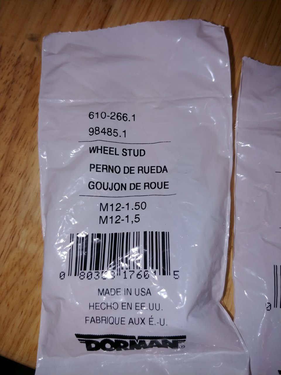

    By no means do I condone all Dorman products... Hell I don't even use any others that I know of because they're usually so shitty. But their wheel studs for our trucks are just fine and the only thing from them I've ever seen printed with Made in USA, usually it's the most bottom dollar garbage part from Guangzhou or something.

    Toyotas are easy to do studs on. Some cars are not

    Yep Hondas are not, those were the most common when I worked at a shop. I never had to replace any on a Toyota yet.

    I like cars with normal taper roller bearings in the front, you can usually replace the whole hub and bearing for the price of doing one or two studs
