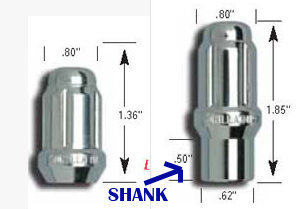

    I would grab some extended Gorilla lug nuts. You can get them in OEM style or keyed. My old steelies used the ones on the left of the pic. My aluminum wheels use the extended type.

    I have acorns (the ones on the left of the pic, right?), but not extended acorns. I believe I may need the latter. It will just be a matter of getting a caliper out and seeing if that is called for.
    Of course, the spare is a steelie. So I would have to carry spare lugs in the glovebox. I like to think I'd be smart enough to go ahead and swap those out if I had to go to a spare. But I also REALLY like the looks of steel wheels, and these aluminums are seriously abused- no gouges, but the clearcoat is long gone and they are severely oxidized. I am tempted to just scrap them out and put the money to new steel wheels and be done with it.

    I'm really curious how the ones on the right will work with a steel spare when they are designed to hold the seat away from the thin steel mounting flange.

    Idk, i was on the side of the road. Drove 50 miles like that. It may be best to get a set of the ones on the left, but its good to know the extended ones will work.

    Just FYI those aren't the only types of lug nuts. Stock Toyota wheels use a mag style lug nut with integrated washer.https://www.discounttiredirect.com/learn/lug-nuts
    If you use an acorn lug nut on a wheel designed to use a mag lug nut, you will ruin the wheel.

    Steelies don't use the mag washer type. Just plain ol acorns. Pic stolen from classifieds. Screenshot_2018-09-15-21-23-52.jpg
