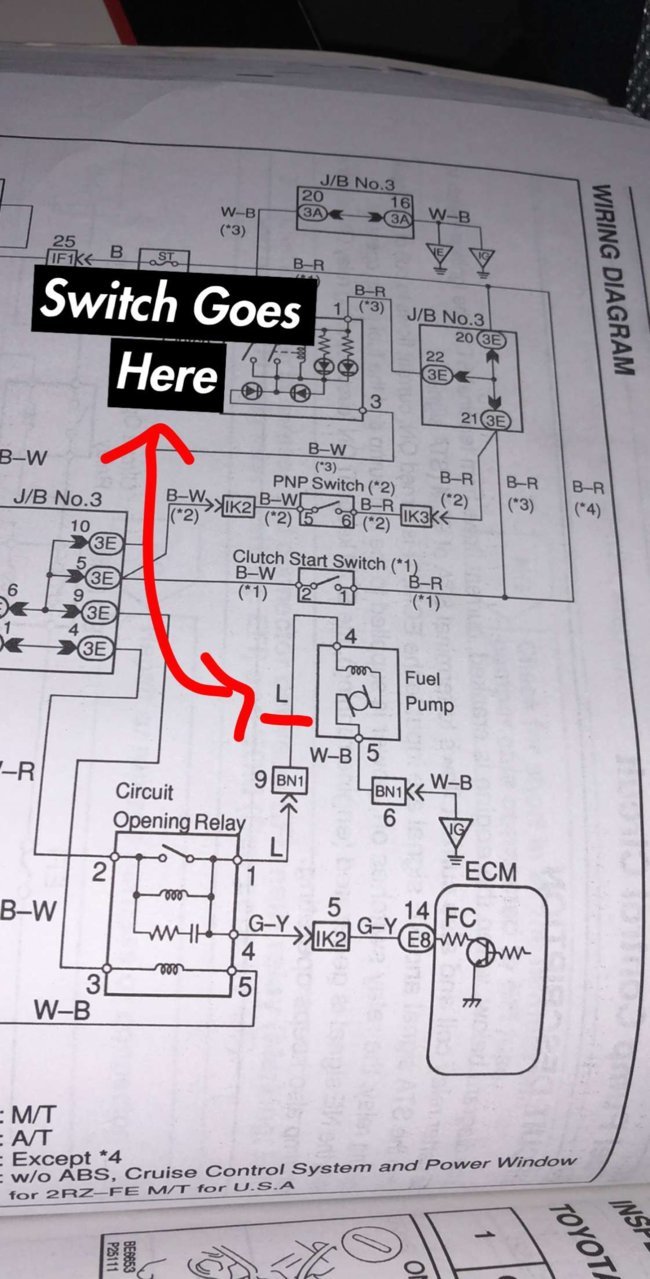

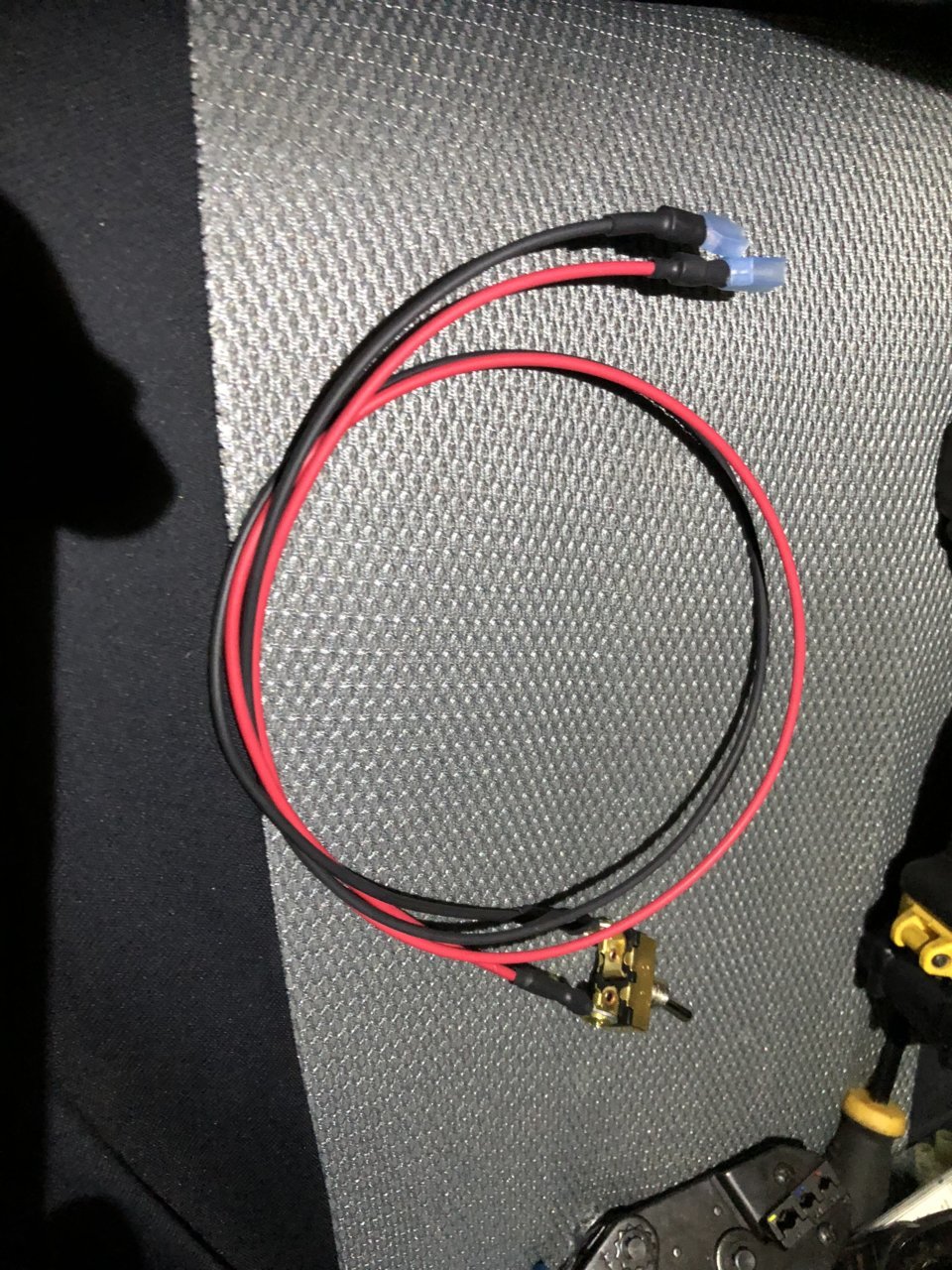

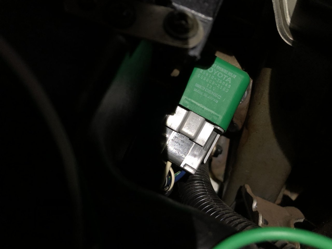

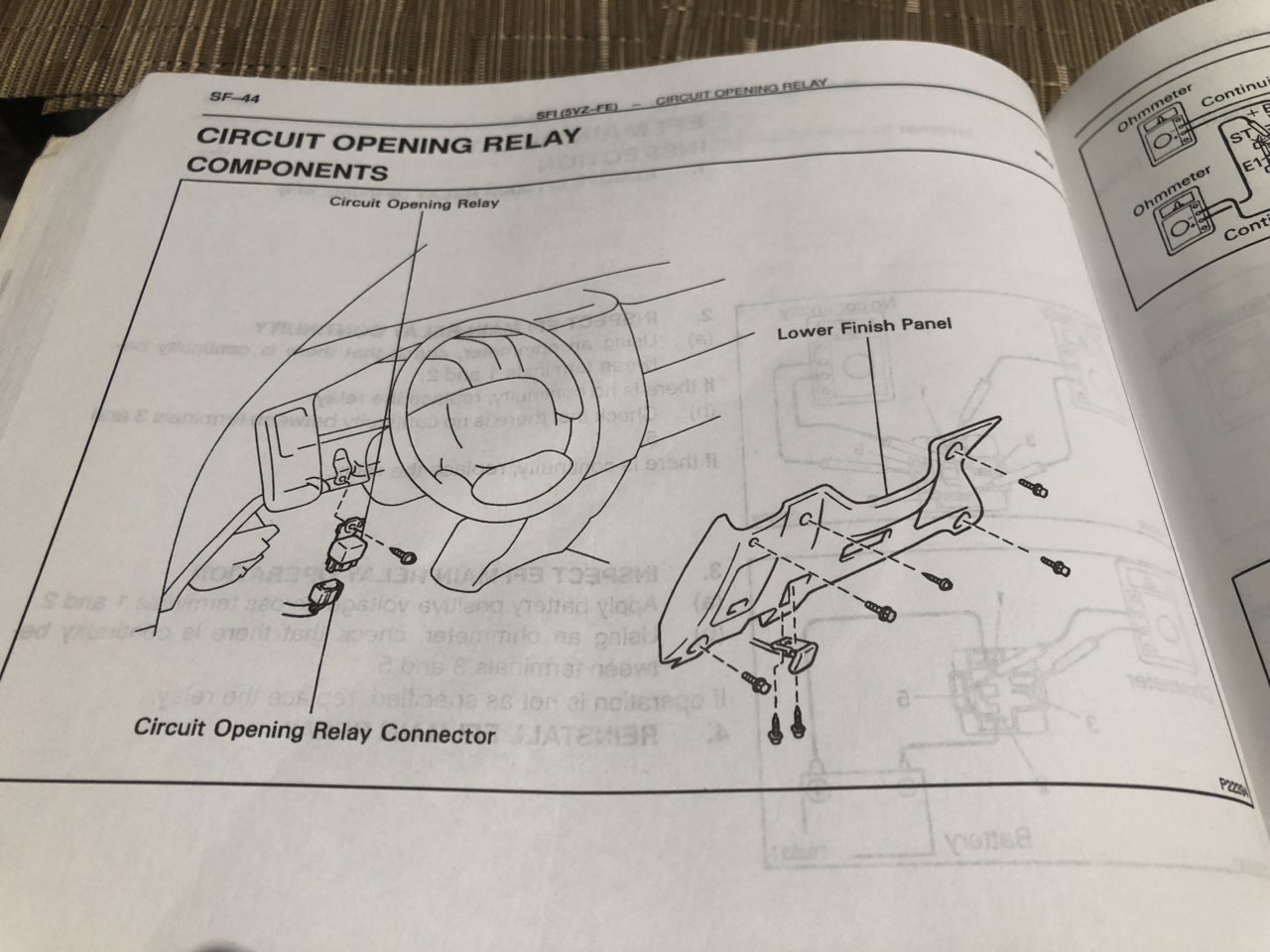

    I installed a killswitch today. I wired it in-line with the Blue wire of the Circuit Opening Relay on the Fuel Pump circuit. No Fuel = No Compression
    This is a commonly stolen truck around here, so I’m being careful. Might get one of those Clubs that locks the brake pedal too.
    Of course this won’t stop someone with a flatbed and a winch. Unless I chain the wheel to the axle or something.

    Why not interrupt the green and yellow signal from the ECU? Less amp draw. Less chance of failure.

    Not sure why I didn’t do that. Most of the write-ups I looked through used the power wire for the pump.
    I might go and re-do it.

    Wrap it in wire loom, make it look factory, and hide it well.
    This doesn't stop compression, FYI- it just stops the fuel. I'd cut the power side, like you did- not the ground like I've heard a lot of folks recommend (the pump can cstill see ground through its body), though I would break the circuit with a switched relay, not a switch, personally. I wouldn't go crazy with worry about stopping theft- do what you can, but realize when it comes down to it, flatbeds are a thing, and NOTHING will stop a winch and a flatbed with a determined thief operating them. This is what insurance is for.
    In short, well done.

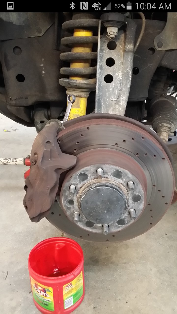

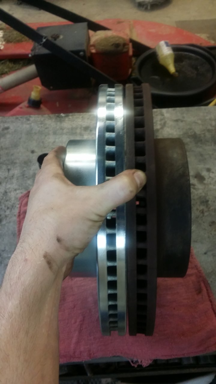

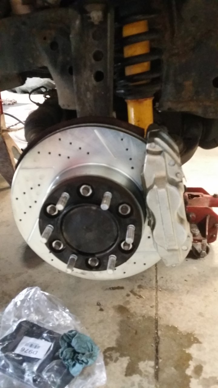

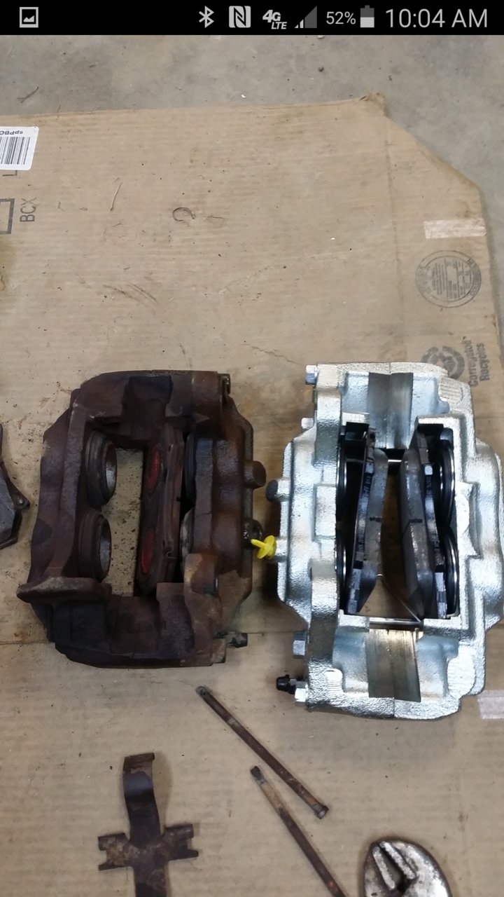

    I've been running the LCE big brake kit for the past few years. It uses the smaller 13WE calipers. It was definitely an improvement over the Tacoma brakes, but I've had some issues. The rotors warped within 2 years or so and I had to have them turned quite a bit to get the back to true. Also, the Hawk pads that come with the kit are nothing more than a brake dust factory. Now the calipers need to be rebuilt due to the pistons seizing.
    For that reason I decided to go ahead and get the 13WL upgrade and see if I have better luck. I was surprised to find that, while the calipers are significantly larger, the rotors are actually the same size. Pics:
    Screenshot_2018-09-17-10-04-55.jpg Screenshot_2018-09-17-10-04-50.jpg Screenshot_2018-09-17-10-04-45.jpg Screenshot_2018-09-17-10-04-40.jpg

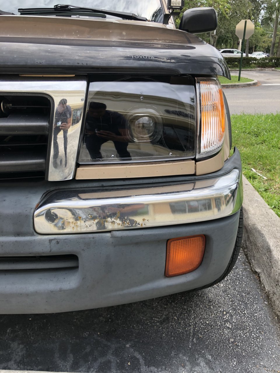

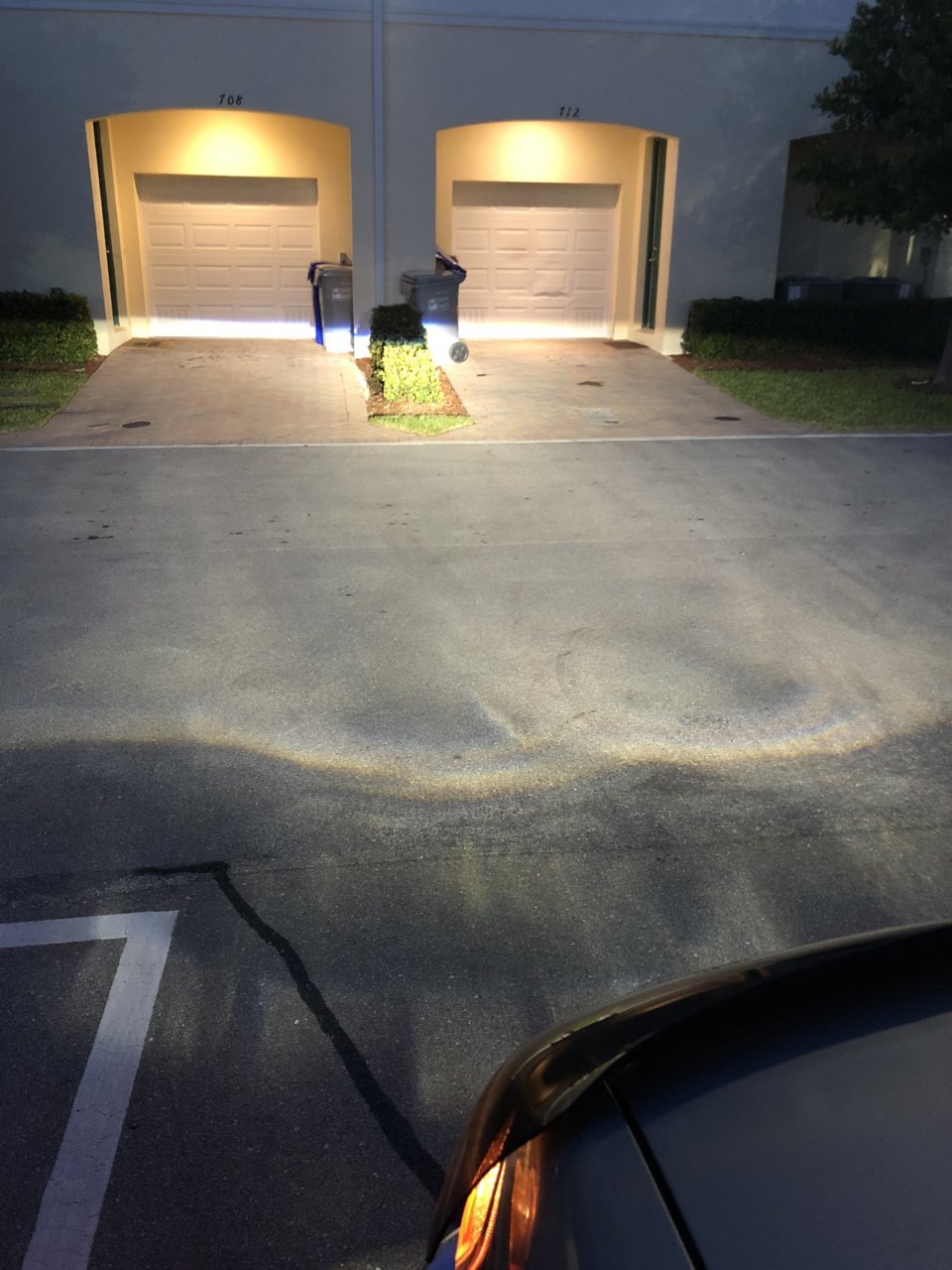

    Another shot of the D2S
