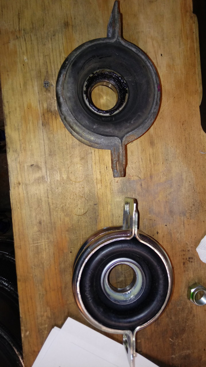

    The outer ring of the center bore is slightly different between the two but the new one fit fine. 0923181400.jpg
