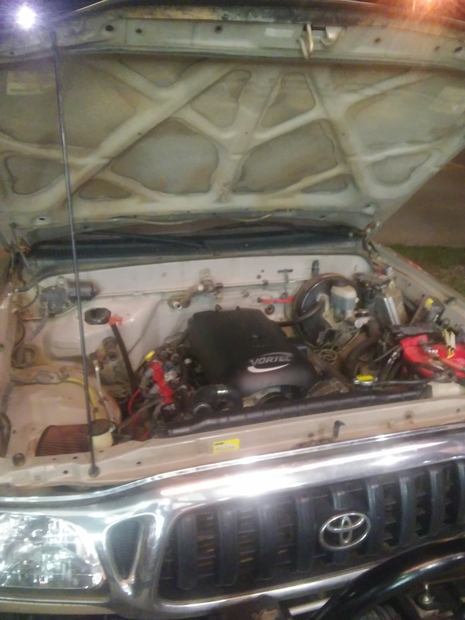

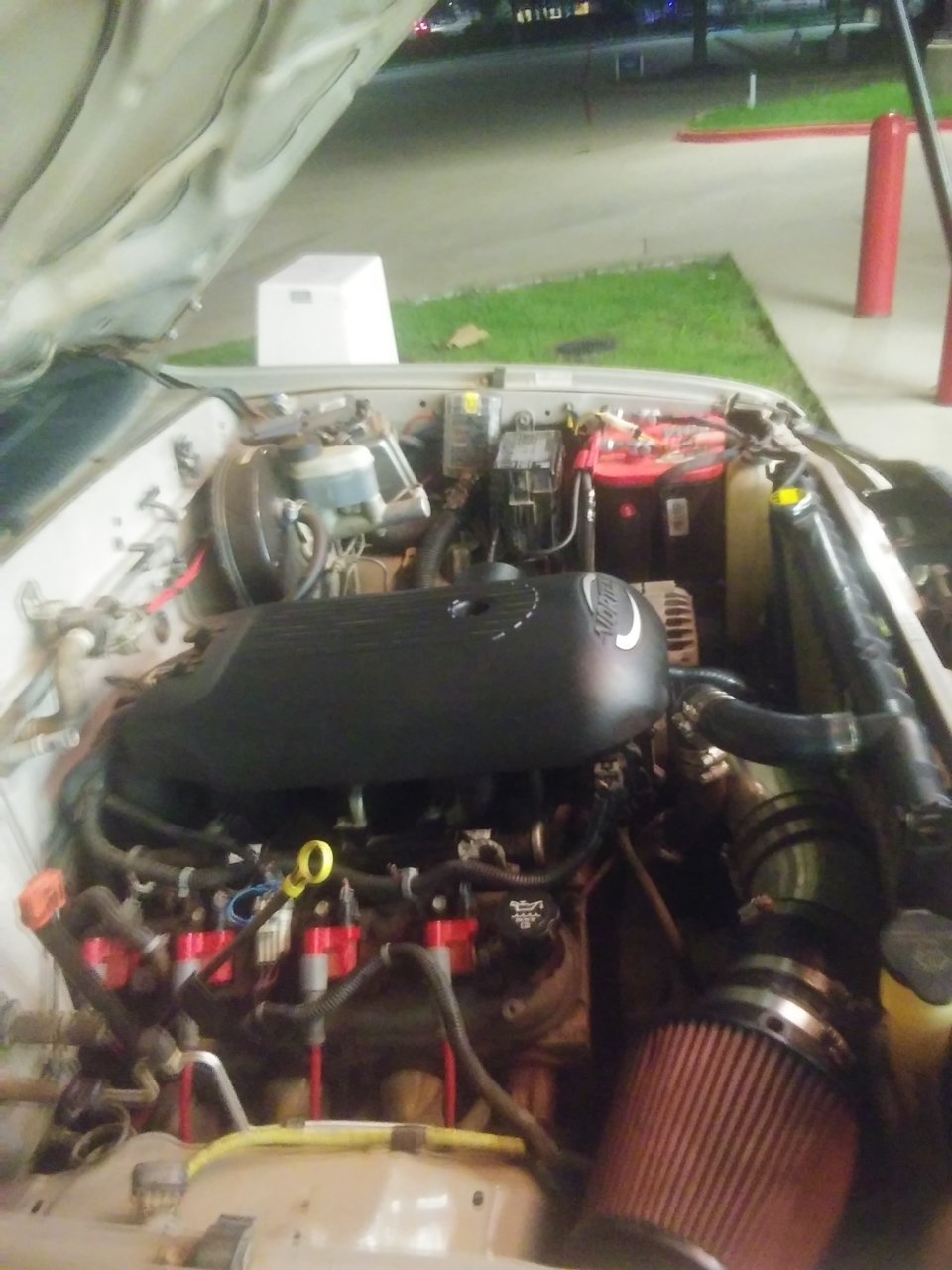

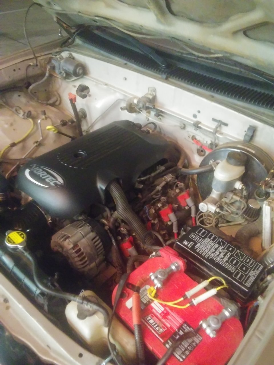

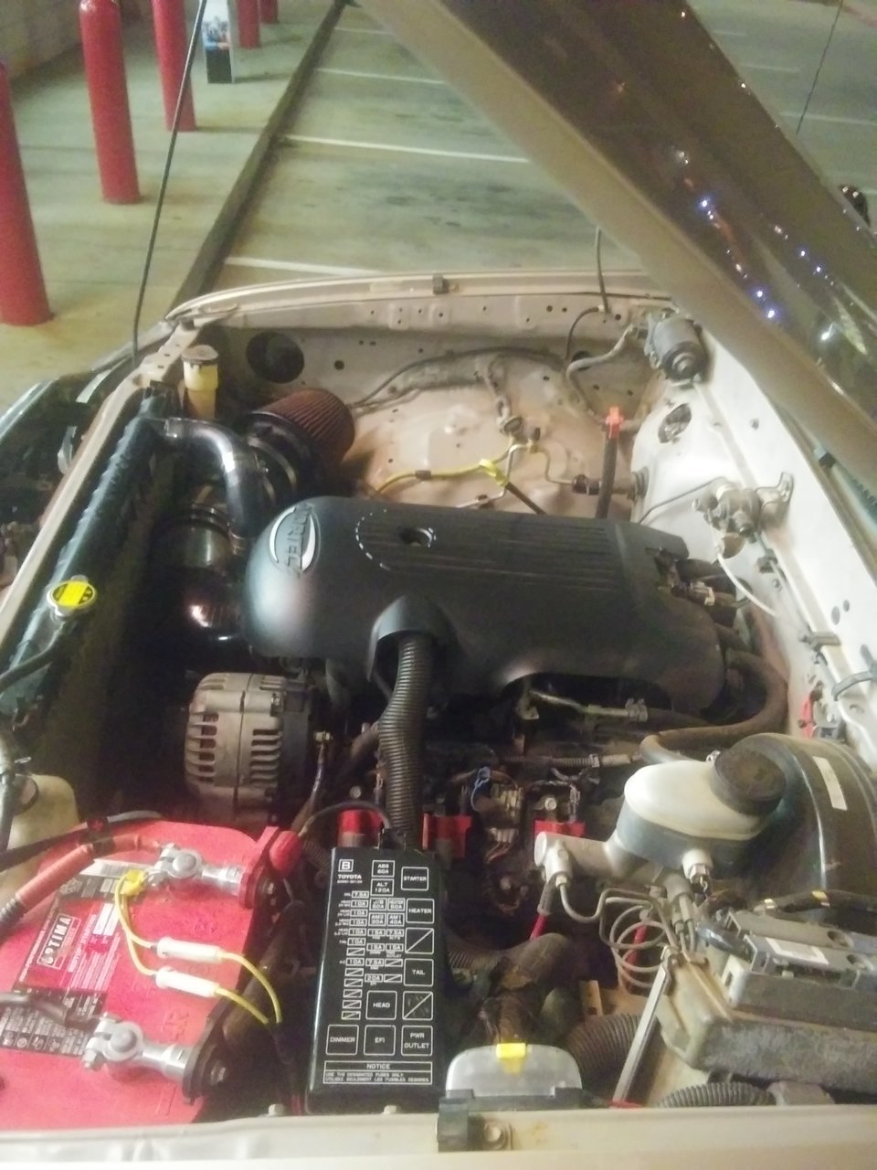

    if i didnt turbo i was gona put an lq4 in mine. maybe if i blow the 3.4 beyond repair.

    cxr makes bolt on motor mounts and exhaust for ls conversion

    if only it was simple with the stock 4wd setup..

    why wouldnt it be

    exhaust routing is a big problem because of the front drive shaft and front diff. Hell the oil pan in a problem with the diff.
    Can't use the CXracing headers with 4wd.

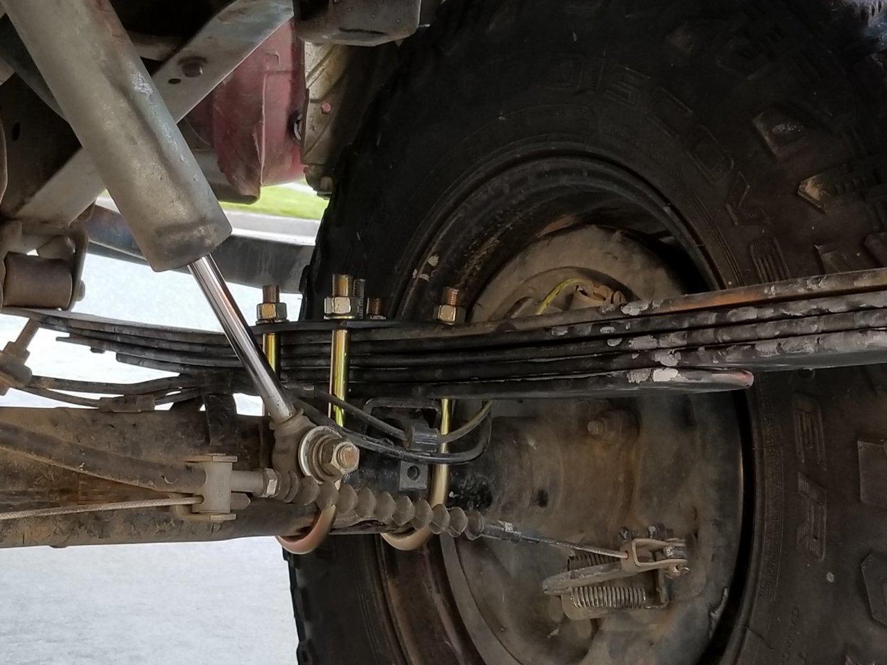

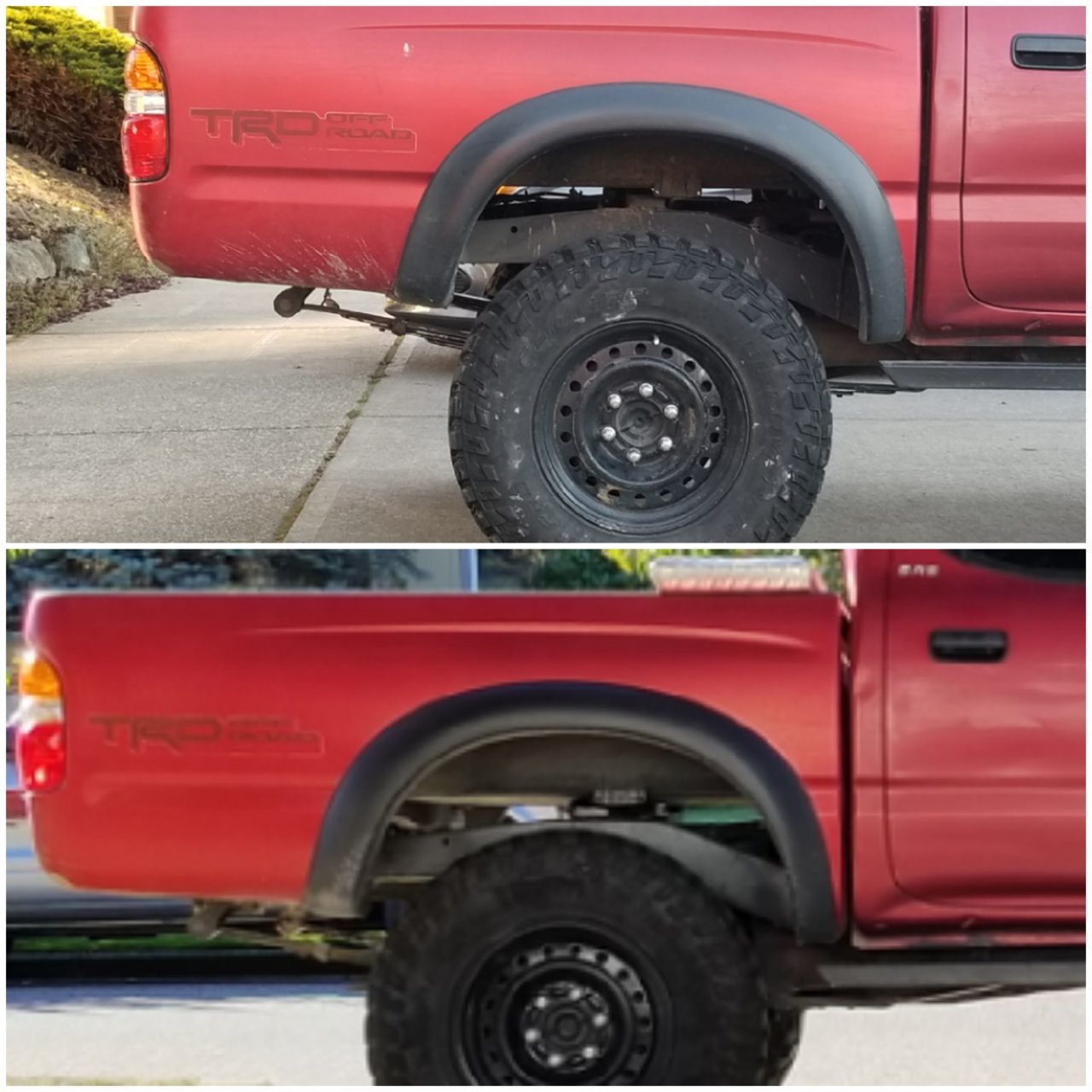

    Back on original subject matters.
    My home made Toyota pack is a smooth ride. No more bucking out of the back suspension going over speed bumps. It handles the full tank and 300lbs of camping gear perfect. Achieving full stuff and max drop without binding. I will be using limiting straps and bumps after adjusting my shock location. And ditching the shitty u bolts. Used my oem, and a 2014 oem pack as well. 2.5 inches of lift and a days work. I owe a great guy some beer for his 2014 leafs.

    oh yea. they do have an oil pan for the swap. i remember the guy in lt thread had to notch the front crossmember with a low pro pan but it cleared front diff.

    What U bolt flip kit did you go with?

    Made my own out of .25 in flat bar I had and some shitty 1/2 orileys u bolts. I will be re making them with 3/8 and step up to 5/8 u bolts it was just to get it mobile. The problem I was having is all the after market plates are way wider then needed so the ubolts dont have positive contact on the sides of the axle.
    1st gen u bolts only need to be 3 in on the Id. Other wise they only contact it on the bottom of the bolt.
