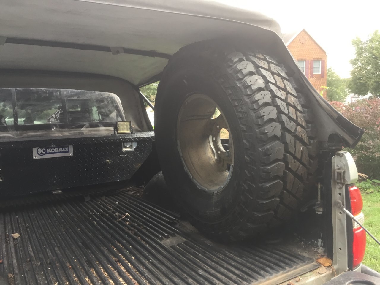

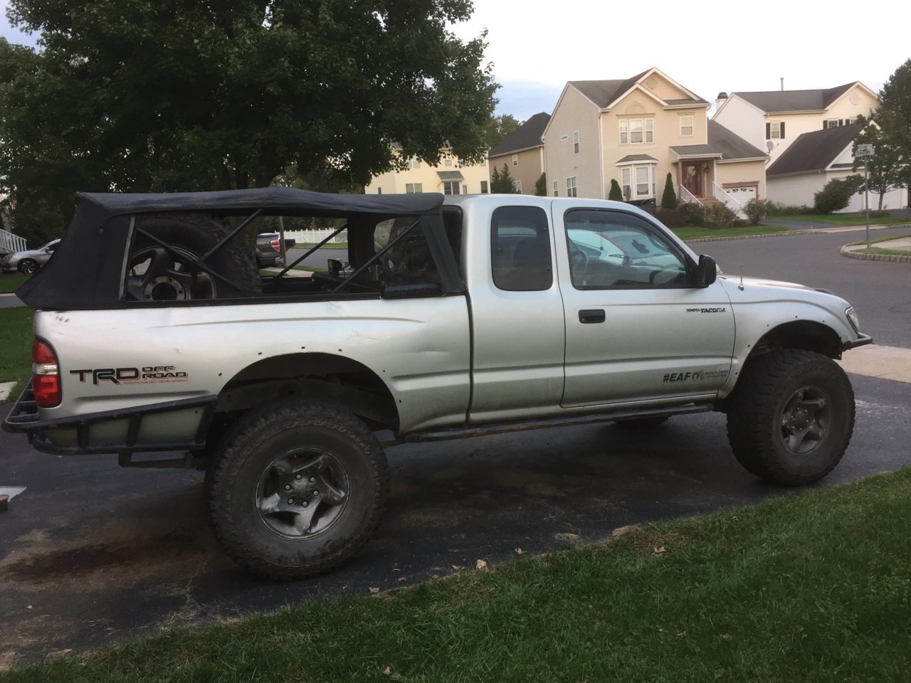

    Got this thing on:
    Trying to make it work with a tool box has been... interesting. Still not sure if the windows will go on. We'll see!
