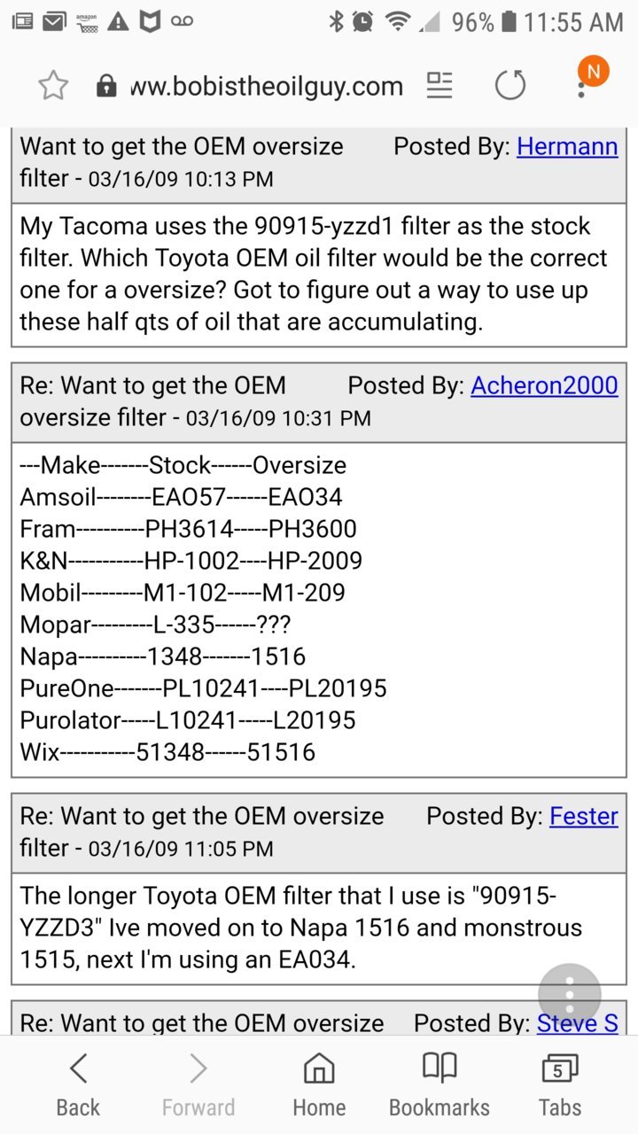

    No baldwin listed but here's some others. I use wix
    myself
    Edit: Baldwin is B243

    I use the 1515 that the next guy is talking about on my cruiser, it is huge
