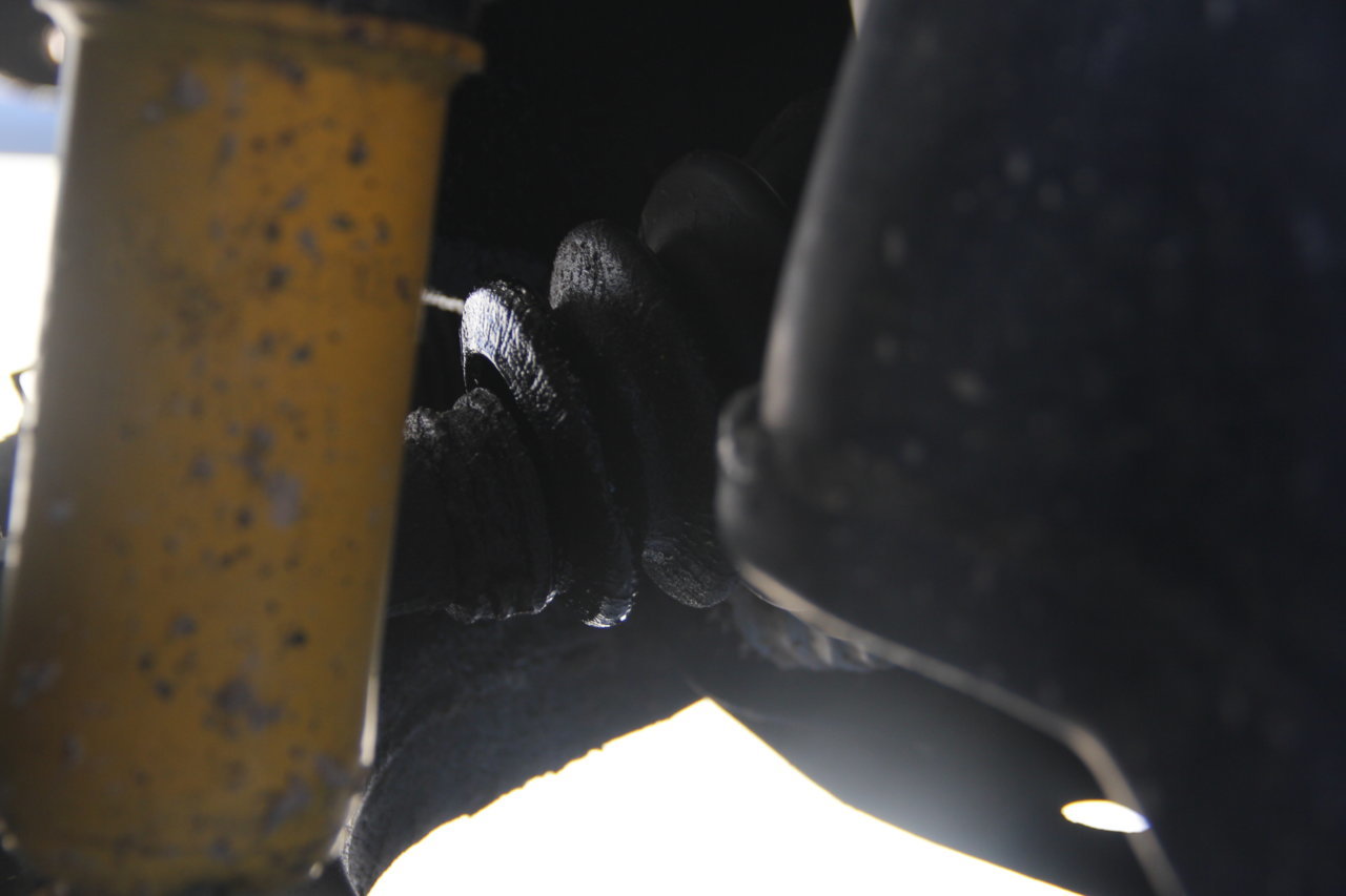

    I had one blow a day before my cousin from down south came to visit. I had promised him shooting and offroading so i wrapped it in plastic and saran wrap, then hit it with zip ties and duct tape. Re-booted the next weekend. All was good

    Yes, but afterwards I still had all my limbs, wasn't bleeding to death and didn't have an APB out for me so how bad could it be.

    Damn I totally missed that... Been awhile since I've been on here too and haven't seen these responses. I'll be fixing that tomorrow lol. Thanks guys. Belt still looks to be fine but I'm sure in due time if left it would fall apart rather quickly.

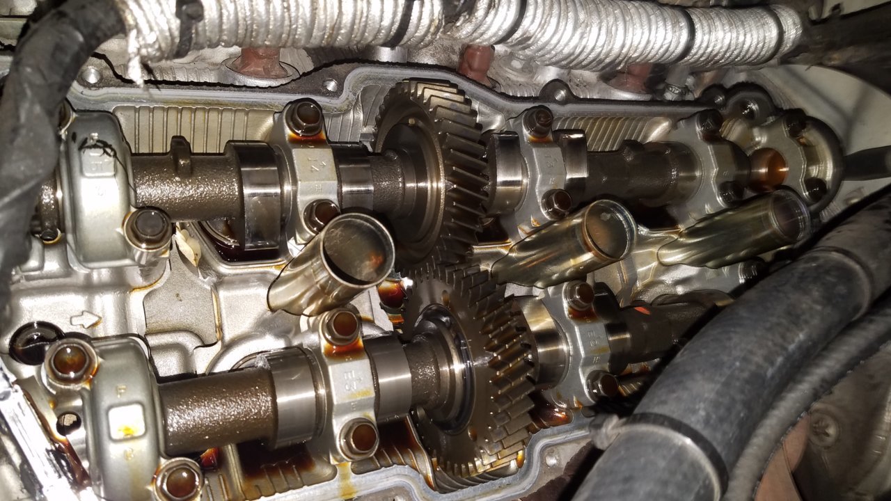

    the torque spec for those is like 5in/lbs or something super super low. The idea is that you don't tighten down the gasket so it doesn't get squished down where the bolts are and create holes where there aren't bolts.
    That said, I didn't use OEM gaskets sadly this last go around and i ended up having to torque a couple bolts really far down to get it to stop dripping oil badly off the back.
    So no don't worry, they weren't working themselves loose, they are just loose as is haha

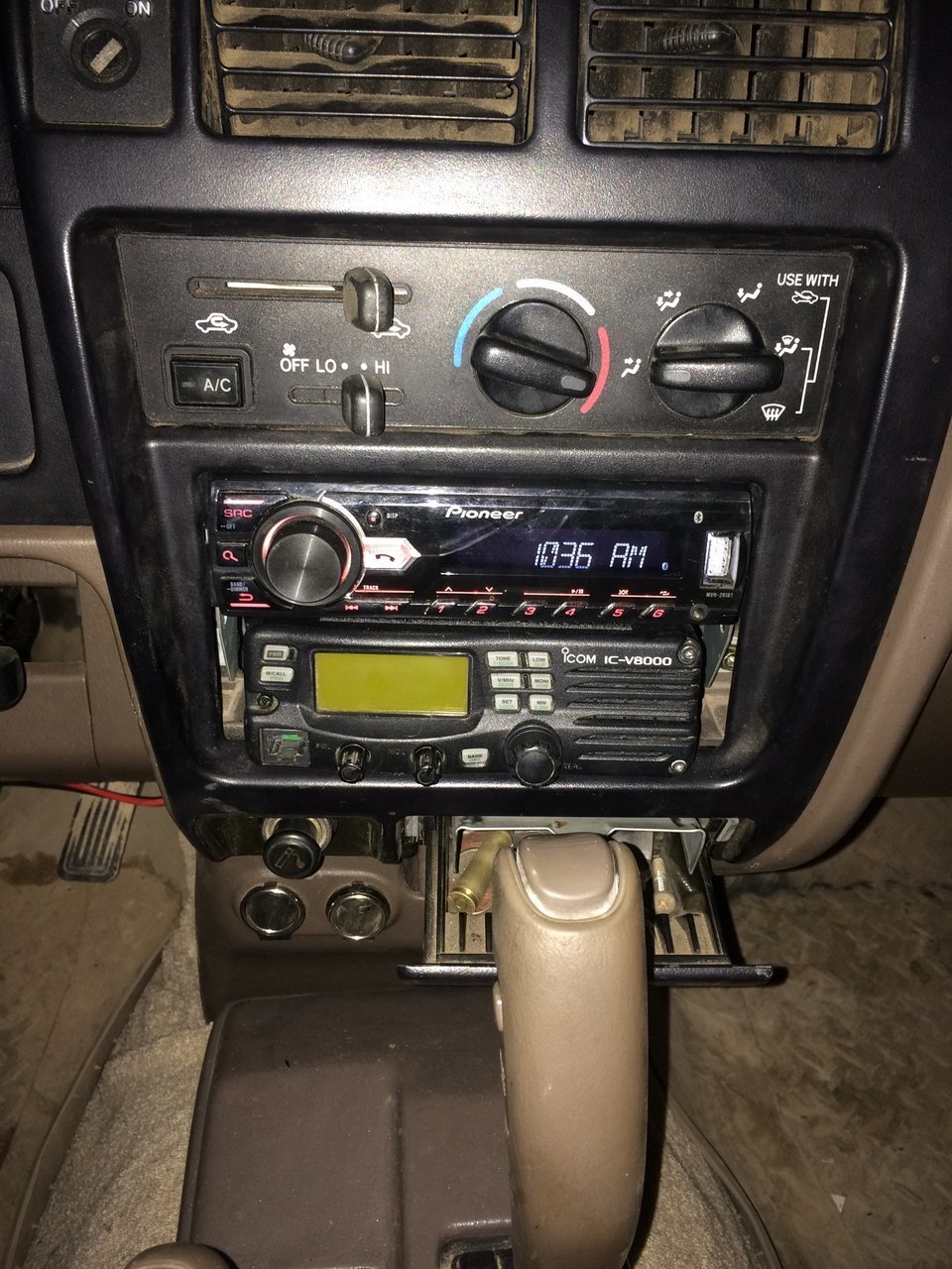

    Did this this weekend:
    1000 measurements before any cuts.
    Whoever said full size CB install is a pain in the ass, yep you are right....

    Can I ask why?
    Not why's it a pain but why bother with a full size?

    You shoulda just replaced your old balls radio with a single din (right word?) and put it under there.

    Try blue lock tight. I would not tighten them more than what the torque spec is. I'm sure you know this but make sure to tighten the bolts in a star pattern and double check each bolt at least twice for the proper torque spec. Another thing that comes to mind are the washers. I can't remember if they are crush washers or not. If so that may play as small role if you didn't replace them. Other than that :notsure:
