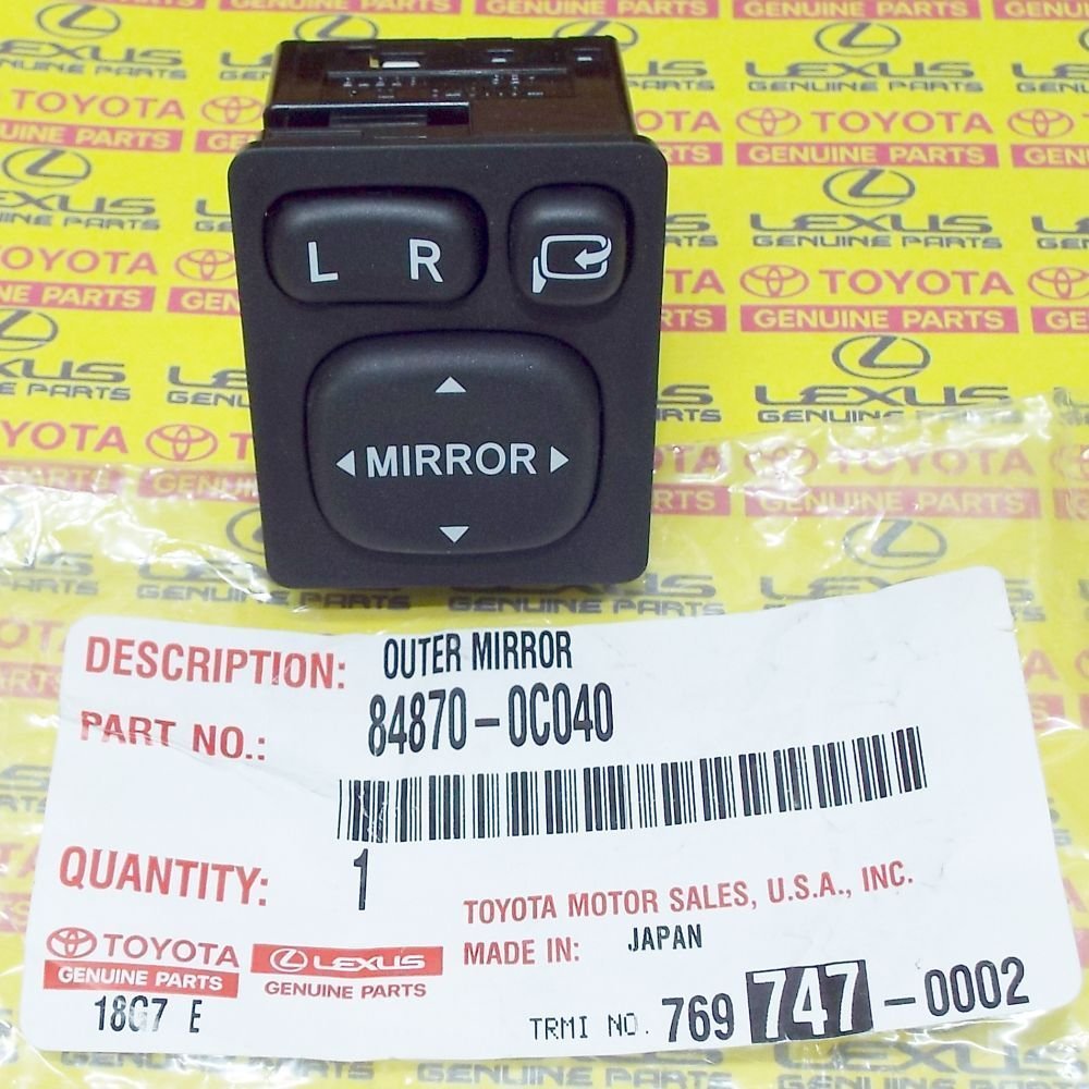

    i'll just have to figure it out. do you happen to have the switch? and see if theres a part number on the bottom of the mirror or in the mount.
  3. Oct 23, 2018 at 10:56 PM
    BartMaster1234
    Aug 21, 2016
    #195197
    45,899
    Tyler
    Pittsburgh, Pennsylvania
    Flux Capacitor
    It's a power folding mirror switch off a Land Cruiser Prado IIRC. I couldn't find one for sale in the US on eBay, I had to order from Japan. Newer Limited Tundras/Sequoias use the same switch.
    They're damn expensive new, but there are cheaper ones (albeit used and/or knockoff). https://www.ebay.com/itm/GENUINE-OE...0:g:p24AAOSw64tblJiK:rk:1:pf:1&frcectupt=true
    Or you can wire it to the Defrost switch like it is stock on 4Runners.

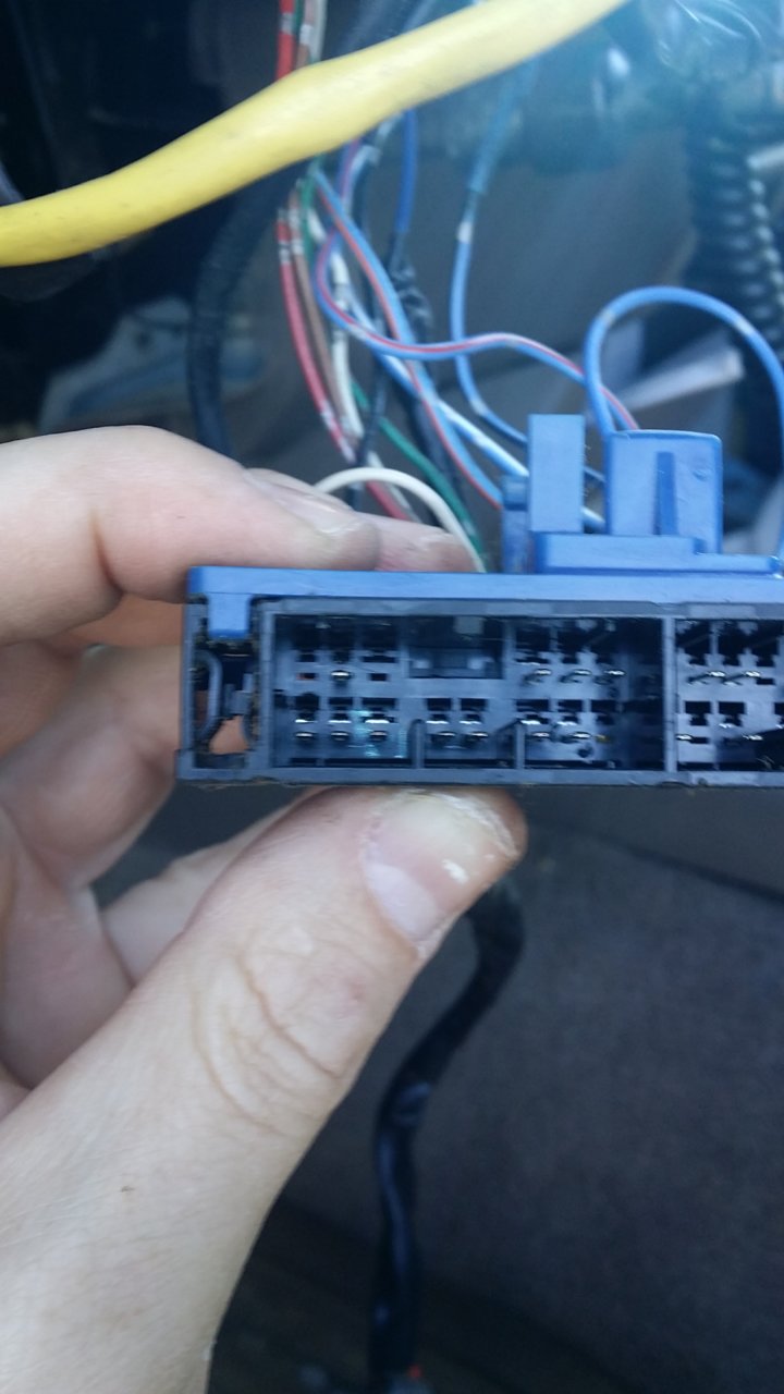

    Hey guys, I'm trying to wire in a new headlight switch, but can't get the old switch de-pinned. Can someone give me some insight on how to get them free? I can't seem to make out where the release is, but I've tried prying up and pushing down, neither of which will release the pin. Please help.

    That connector will most likely have a retaining clip on either side of the housing. I’ve depinned my fair share of connectors, and bigger connectors usually require you pulling up on a retainer and then releasing the pin from the friction lock.
    Do you have a depinning tool? It helps a lot.
