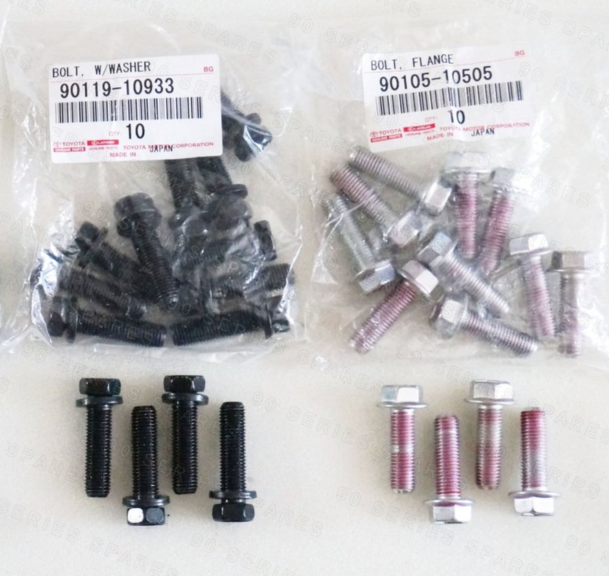

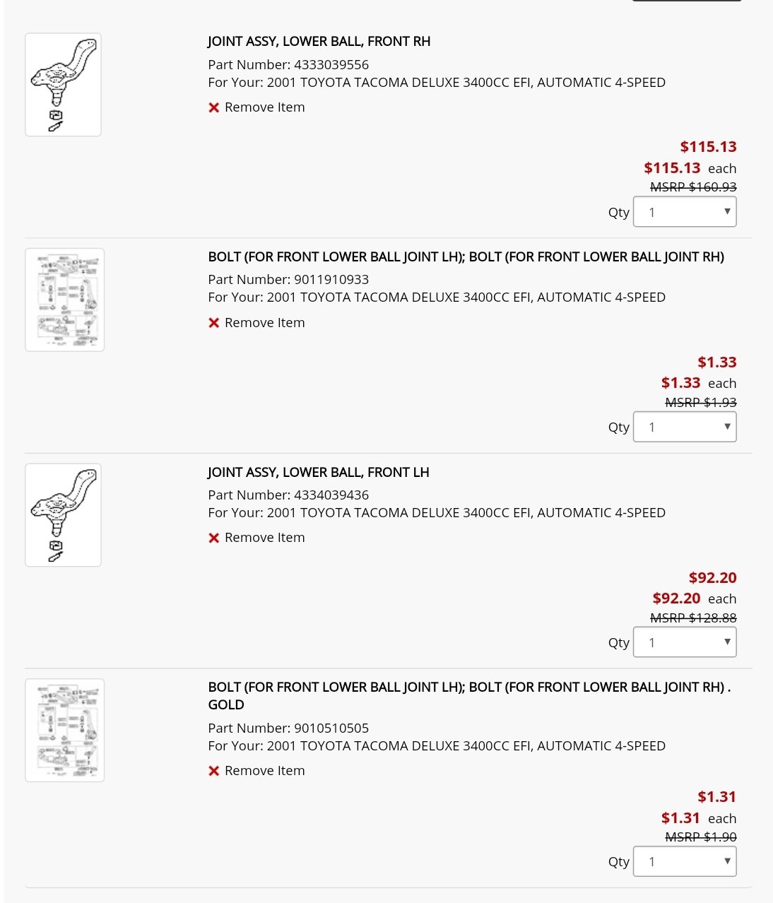

    These are the 2 part numbers for the LBJ listed in the parts catalog.
    The description for 10933 is green & 10505 is gold. Not sure why? There's also another p/n for bolts that work be these 2 are the ones listed in the catalog for 1st gens.

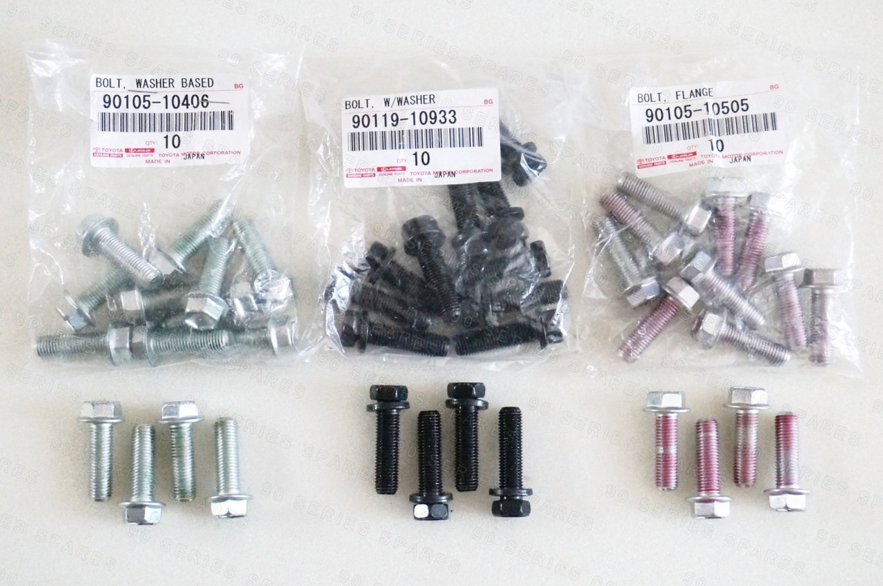

    Don't know what vehicle the p/n phessor gave is for but might not matter much. There's also another part number that some use also, 90105-10406. The photo I posted above actually had these in the pic too but I have a cropped copy saved as those are p/ns listed in the catalog.
