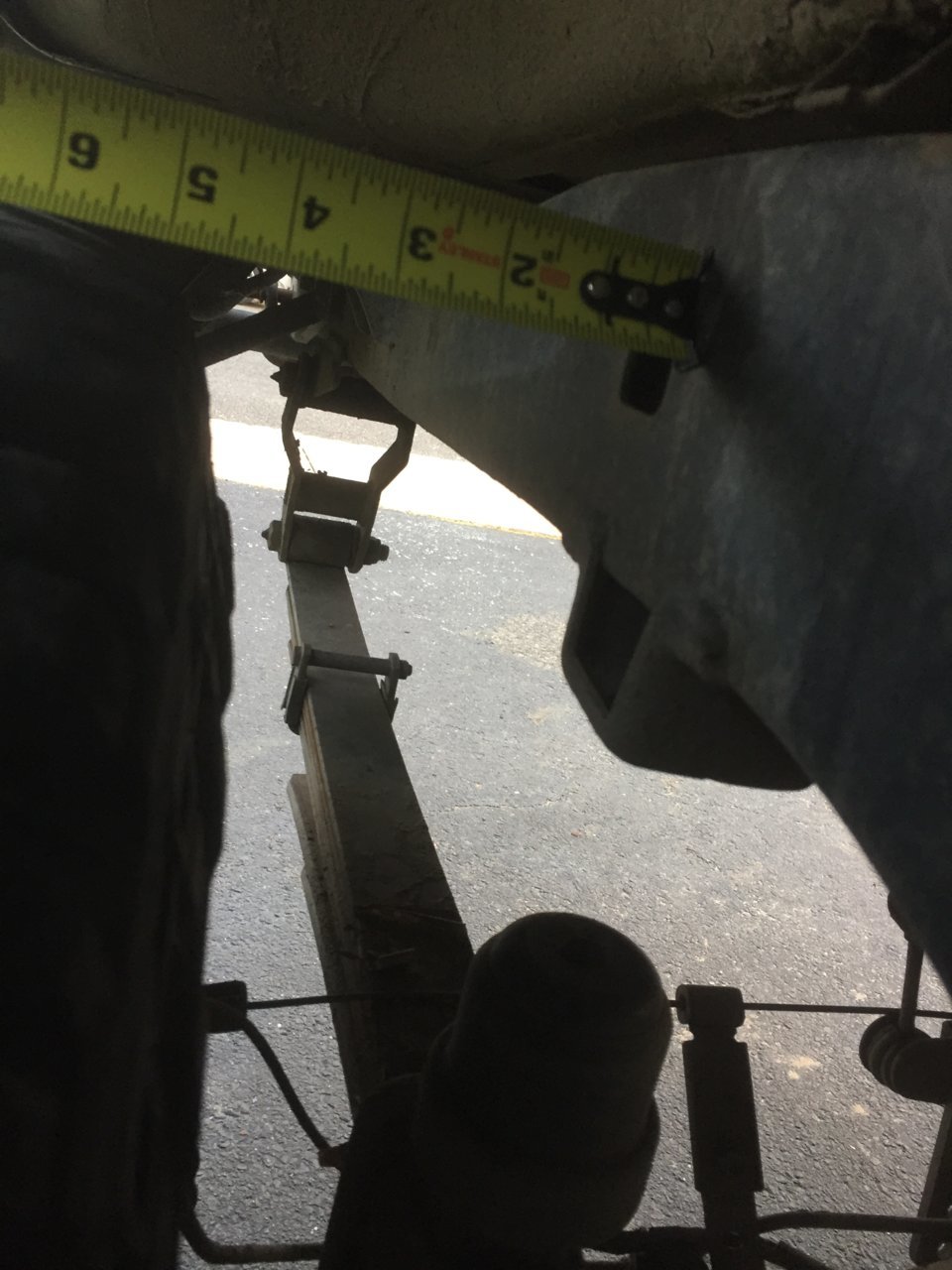

    So go get that measurement so we all have some useful information. :luvya:
    This was done in the garage with a jack, I couldn't get the bumps to compress. Actually have less clearance than this.
