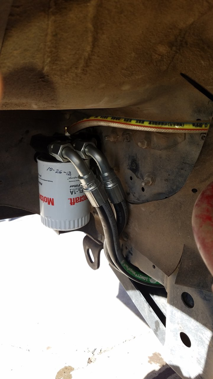

    I got tired of pulling my skid plate off everytime I changed my oil. So I installed a remote oil filter system.
    Now can run full size Ford oil filters.

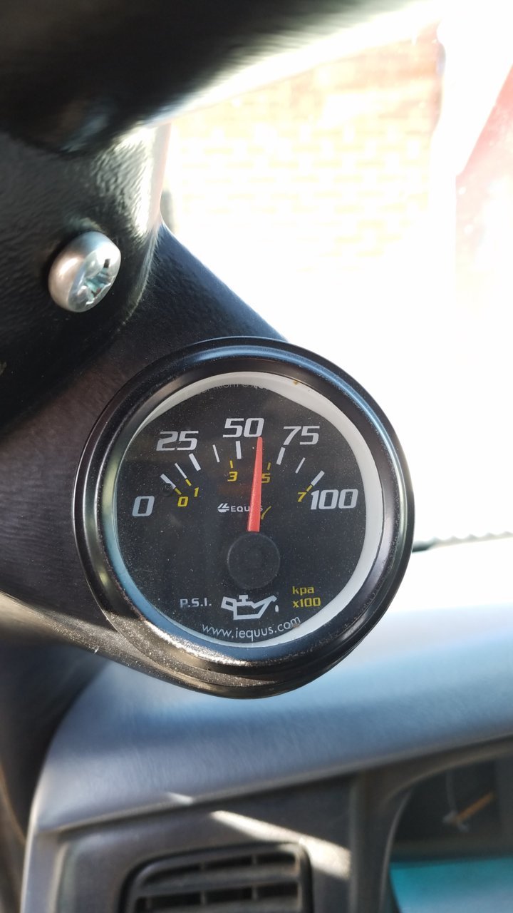

    I now have an analog oil filter gauge, not an idiot light.
    And it holds 6.5 quarts of oil in the system.
    And for the first time in over a year, I have all my skid plates back on.

    What exactly does an oil filter guage measure? You mean oil pressure?

    You would just mount it to the wheel well or somewhere in the bay. You don't want it super far from the original spot. Common mod for car guys too.
    Why do you think its not possible to mount in the bay with this?

    Probably just cause he didn’t put it in the bay.
    The wheel well seems like a weird place to me.

    ah i missed the photo. yeah not sure Id put it where he did either. I meant the wheel well on the inside of the bay. Should be room for that though would indeed be tight.

    I'm mounting the one on my Z to a shock tower, depending on what quality of AN fittings you get to can actually position them pretty easily. But that hose he has looks like a nightmare to bend haha

    Not anymore, I have stuffed to much crap in there already.
    I can always add a shield if it becomes a concern.

    Which FORD oil filter fits this?
    Also the NAPA hoses were AN fittings with the associated male fittings with correct threads/diameter.
    This would be a GREAT kit if someone would put it together.... cough cough -> @Wheeler's Off-Road Inc
    Edit:
    cuz reading is hard... :anonymous:
    Filter (fits Fram PH8A or HP1 Oil Filters)

    It was an FL-1A for a 302 I used to have
    And I went with 5/8 hydraulic hose.
