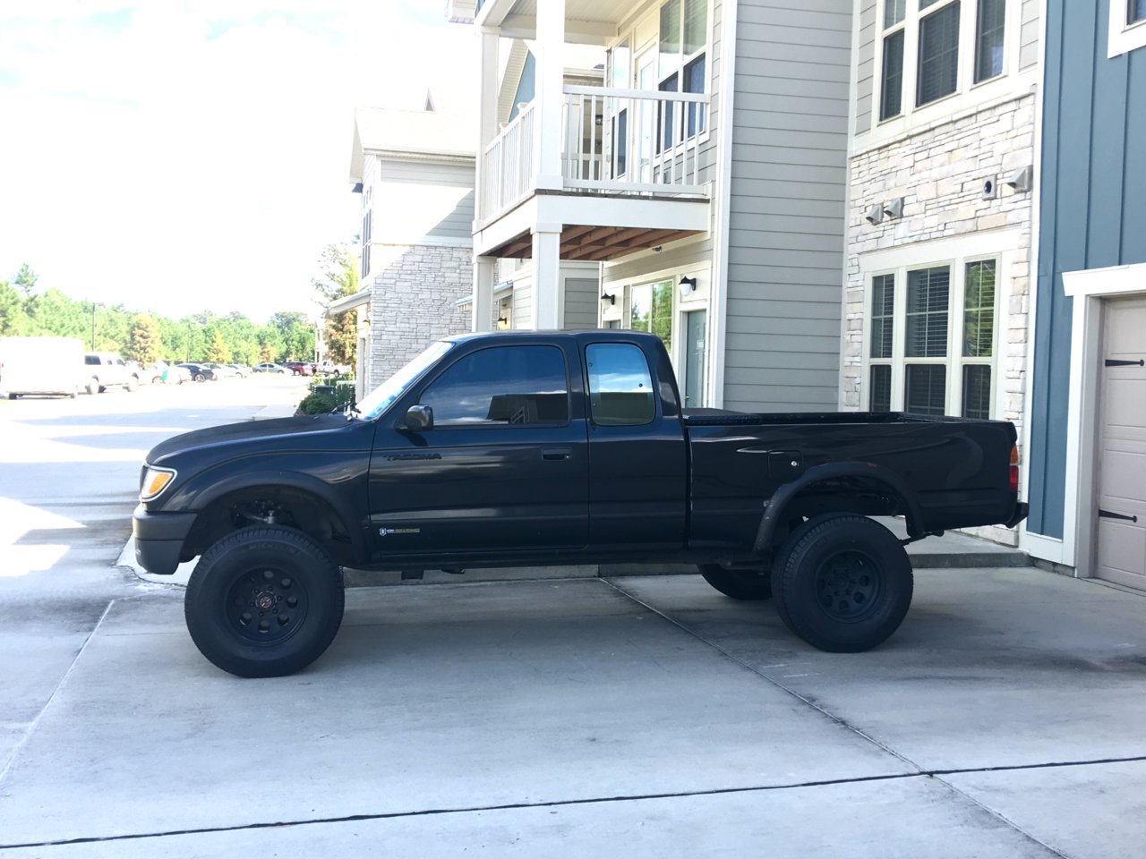

    Been a long time since I been on here or posted. Changed up the truck a bit. Recently moved so my drive to work is a bit longer and I’m still driving my truck back and forth as of now. My 33x12.5 Duratracs were worn and nearly as loud as M/Ts. Decided to go back to stock and got 31x10.5 Michelin ltx defenders. Also swapped back to stock front bumper. Still have the ~3” lift but it doesn’t look as funny as I thought it would with 31’s. Still plan on lowering it 1.5” or so. Just gonna lower the coilovers and figure out a way to get the back down an inch or so. Man I didn’t realize how loud my tires were. It’s so quiet now and I love it. I’m thinking I should gain a little gas mileage too. Truck feels a little more powerful with the SC and 31’s. Overall very happy. Also changed the oil, cleaned air filter, and greased the shafts. A7C94258-1F4B-4670-8563-D8A330F4E644.jpg

    What kind of bumper did you have and is it for sale? :D
    edit NM you're in New Orleans
