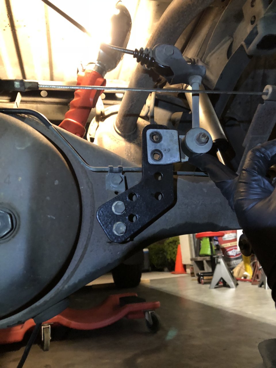

    How much rear lift is that bracket setting accounting for, out of curiosity?

    ~2.5-3"
    With my 33's (285/75r16s) it is about 39.5" from ground to bottom of the fender flare.

    Great, thank you. Just about the lift my rear has settled at.

    Your bracket come with hardware, correct?
    Looks like mine didn’t come with any. Guess I have to finish tomorrow after I run to Home Depot.
    I may have gotten too short of a bracket. I have about 2.5-3.0” of lift and this bracket, hopefully it will suffice.

    If you lifted the truck 2.5" then you'll want the bracket lifted 2.5".

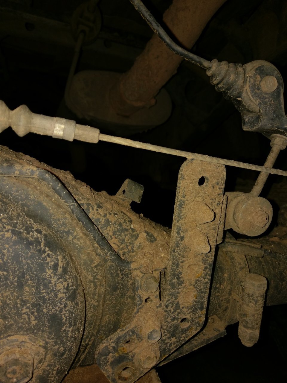

    I honestly cannot remember whether mine came with hardware. It may have. But it has been a number of years. Either way, it is only a couple of small bolts and nuts.
    IMO, setting the BPV arm is subjective. I do it by the way the rear brakes feel. Raise the arm until you start to feel the braking effects of the rear brakes.
