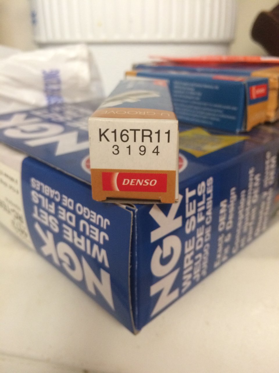

    If I gap plugs at .044 instead of .043 is that a problem? Service manual says .043. Gauge I have skips from .040 to .044.

    The dual electrode spark plugs the V6 calls for should be pre-gapped. .044 will be fine.

    Thanks Jon.

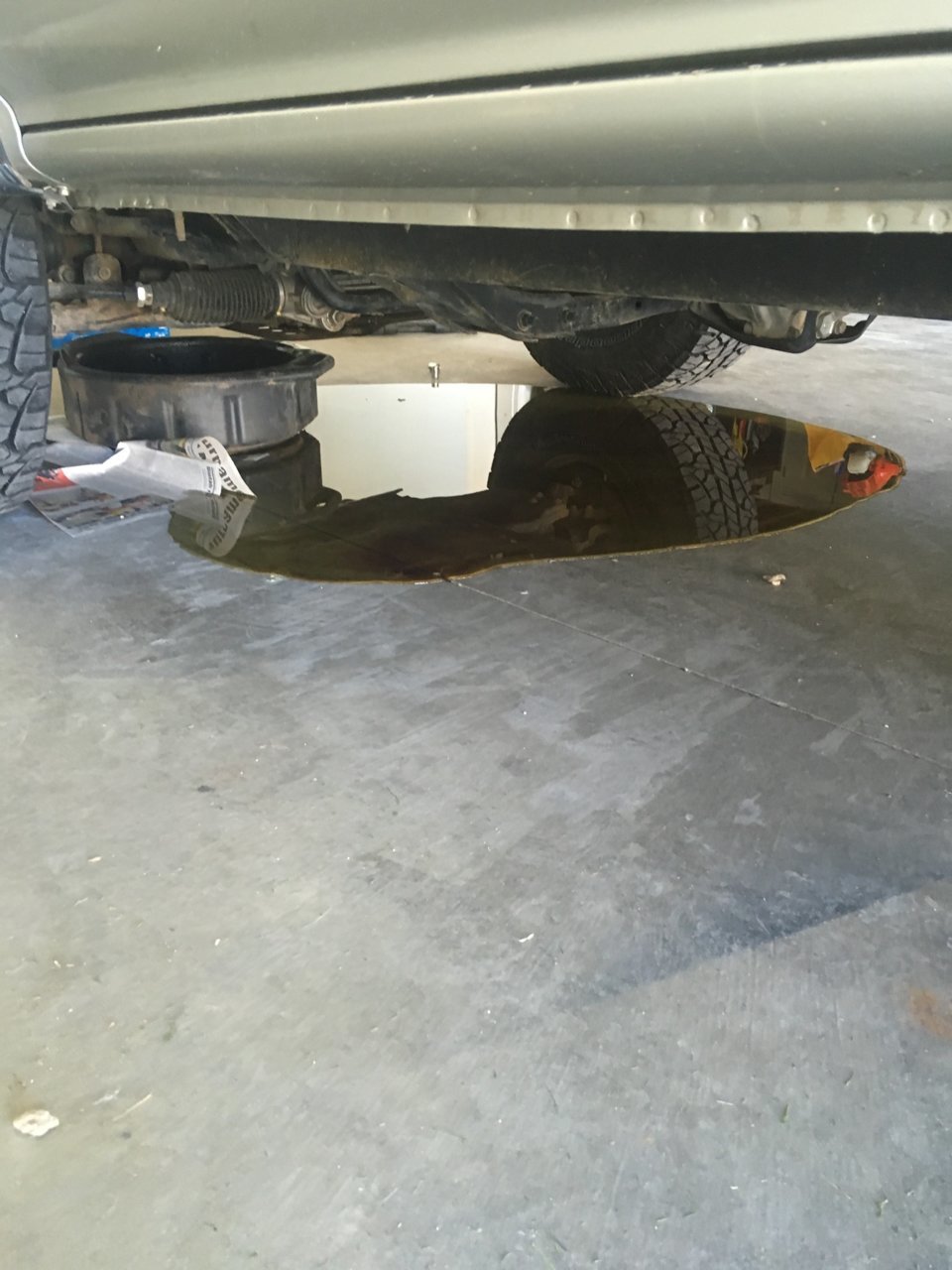

    see floor , oil accumulated, can i drive 20 miles to shop or need to paid tow truck service ?

    Rear axle seal?
    Top off the diff oil and drive it. Won't be a problem, but you probably won't have functional rear brakes. Just be a bit cautious.
