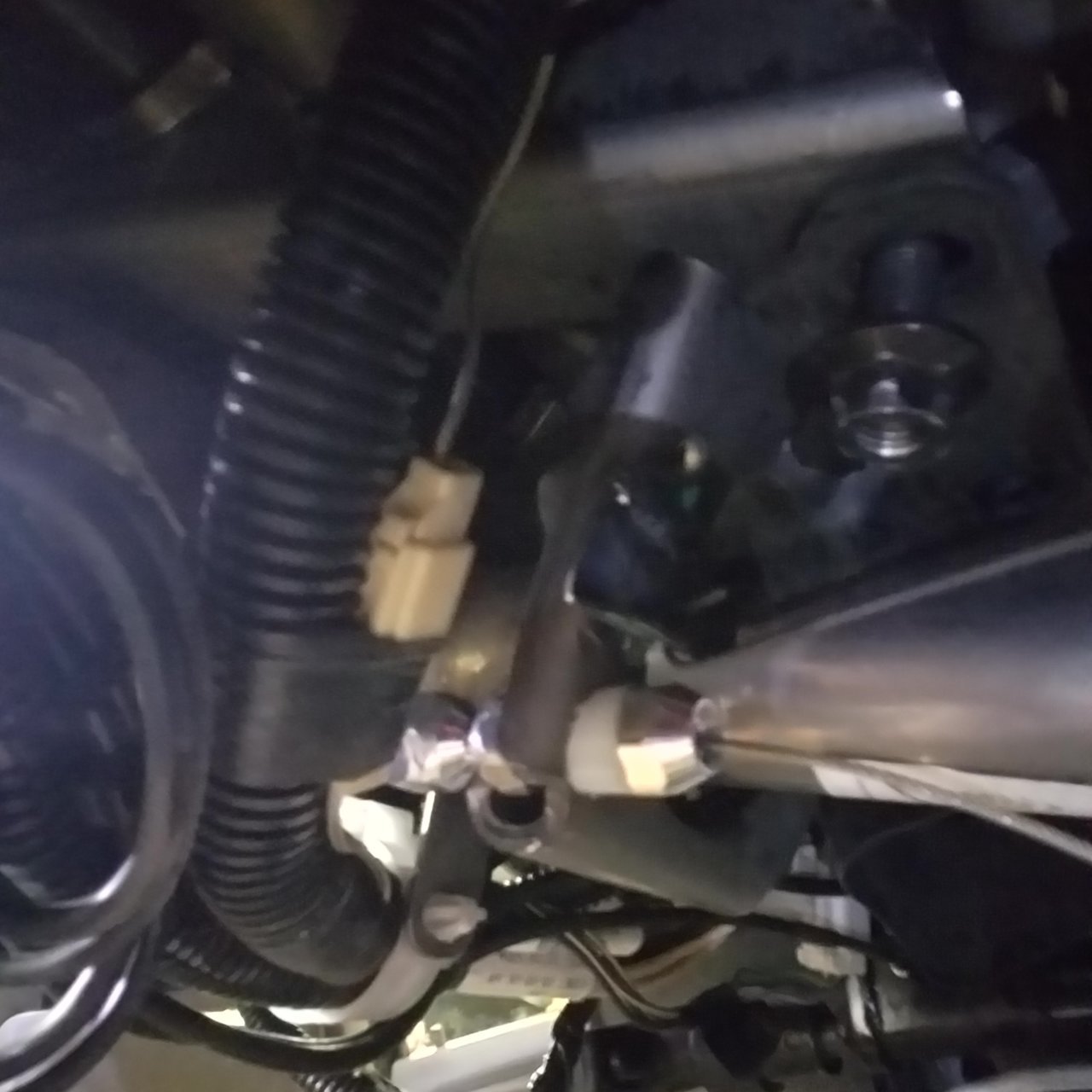

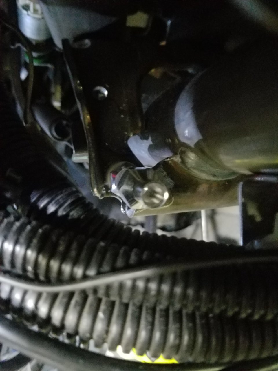

    One side cable mount figured out for the left side skinny pedal.

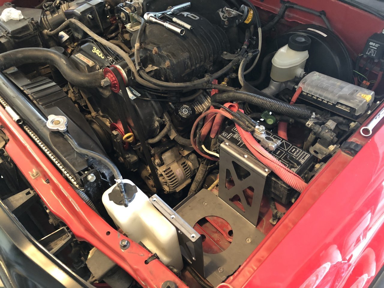

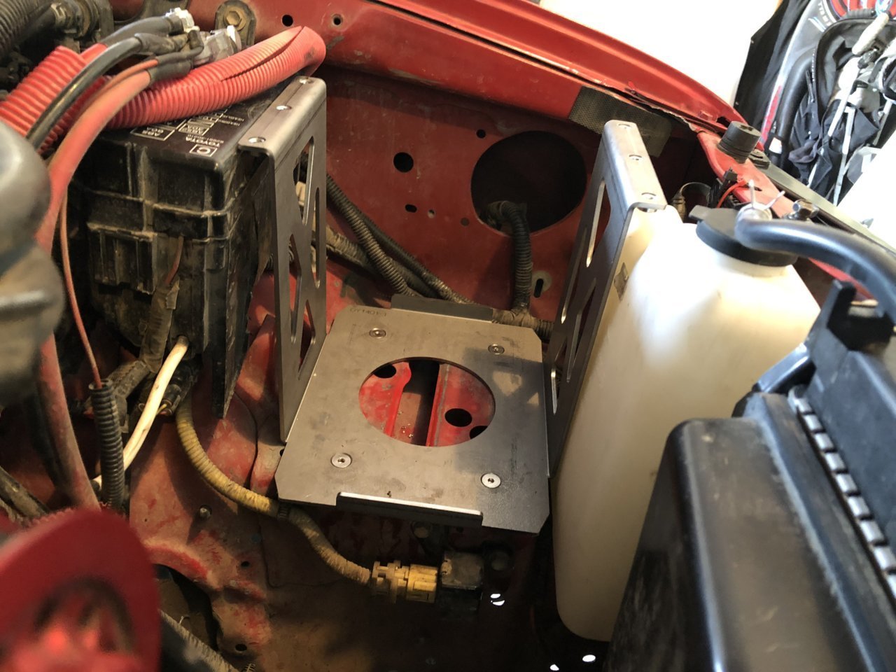

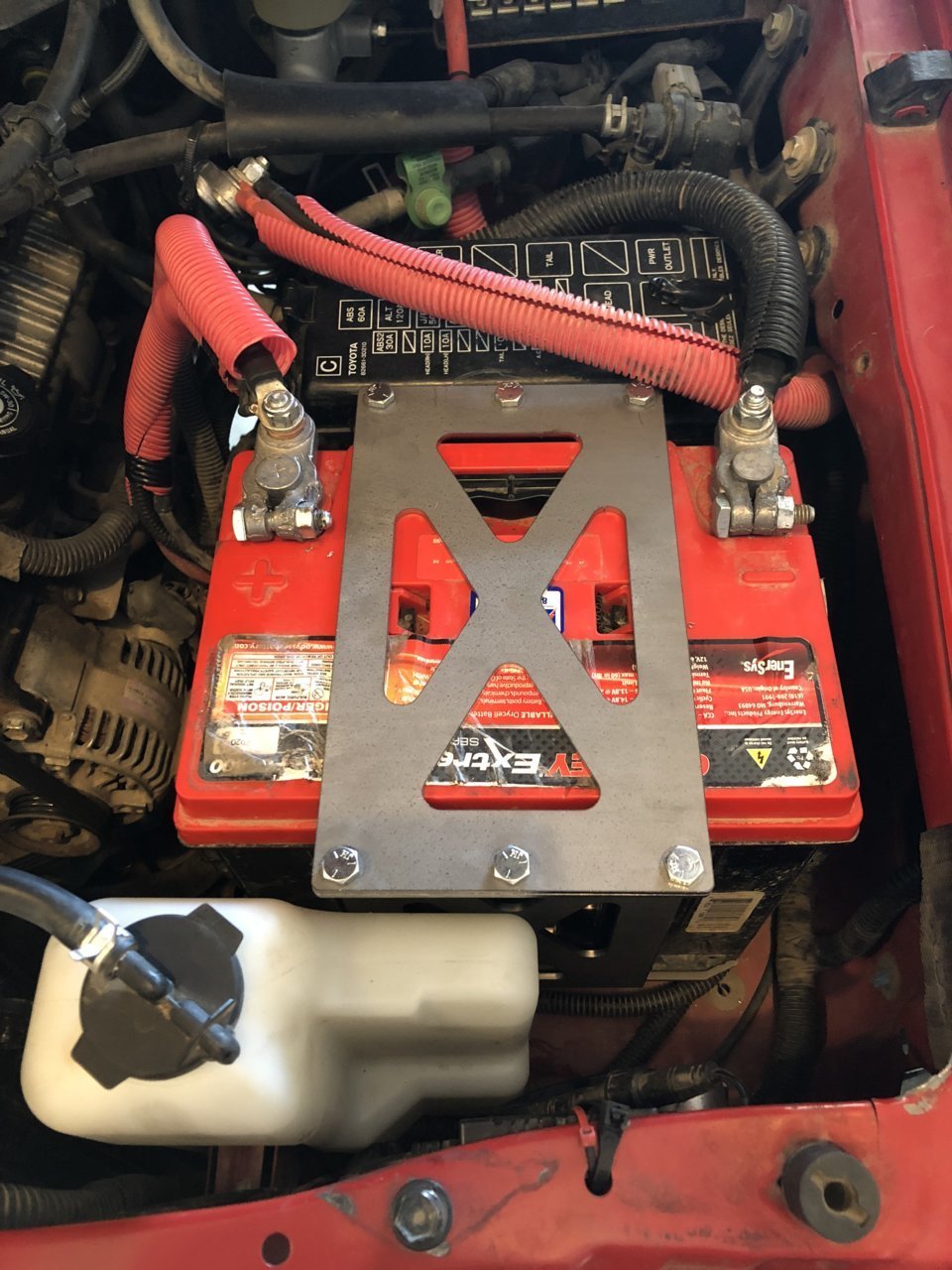

    Installed an Artec Industries battery box. Picked up two of these boxes for $25 each. After looking at the stock battery mounting hardware going for roughly $40 and/or the billet battery tie downs going for $80 a pop, these boxes seemed like a no brainer. Just had to drill 4 holes in the stock battery mount, and then I used some large washers on the backside to keep the thin sheetmetal intact. I’m redoing my dual battery system with a battery on each side of the truck, rather than both on the drivers side. With that said, my Columbia Overland dual battery box is for sale.

    VERY NICE!! $24 each that,s dirt cheap for that. Do you have a link to them?

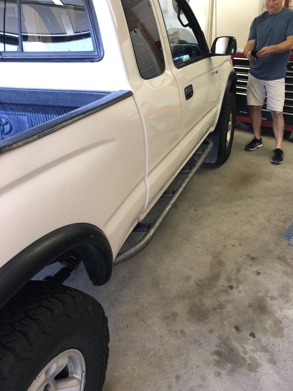

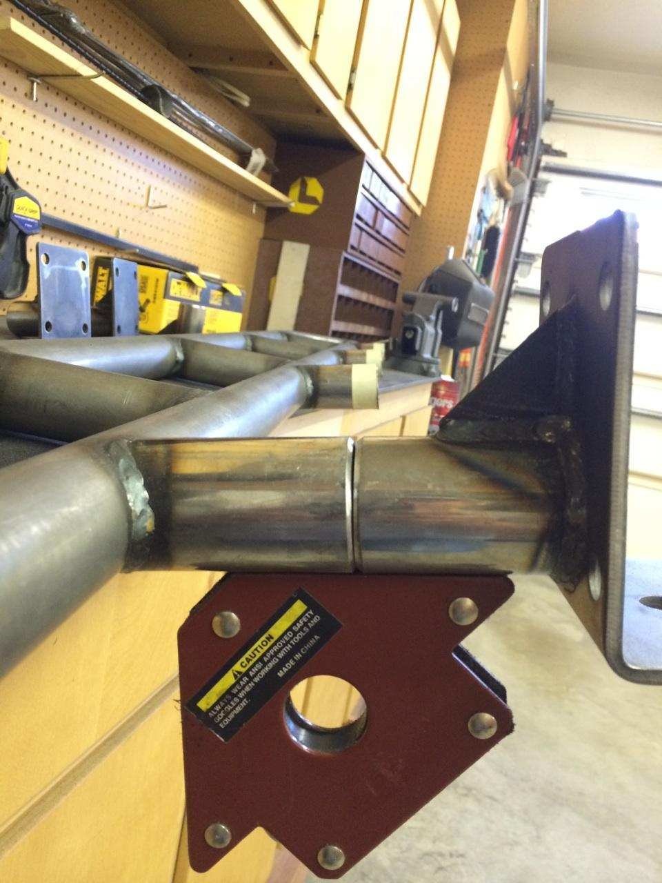

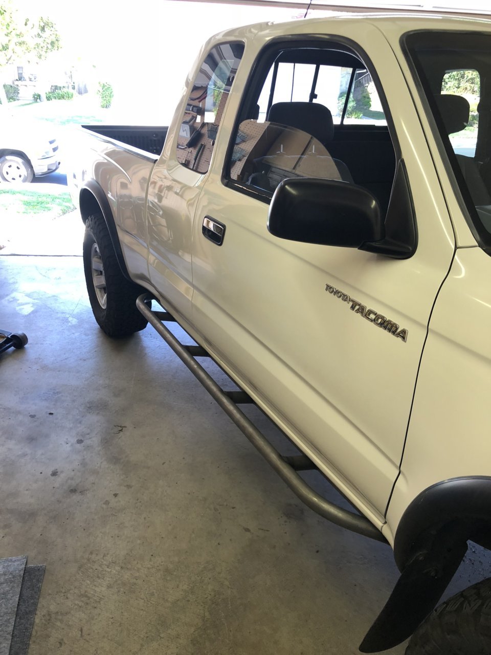

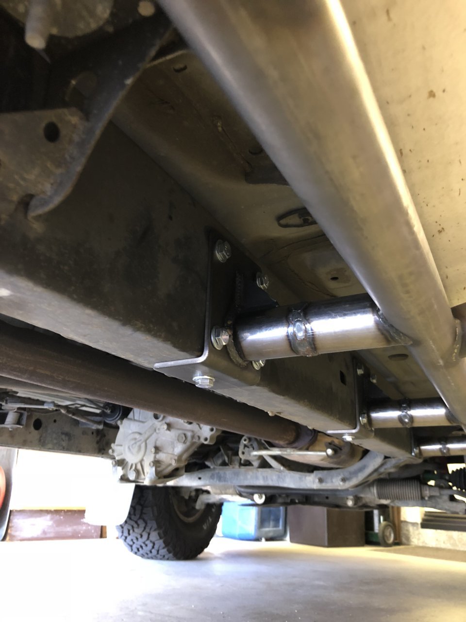

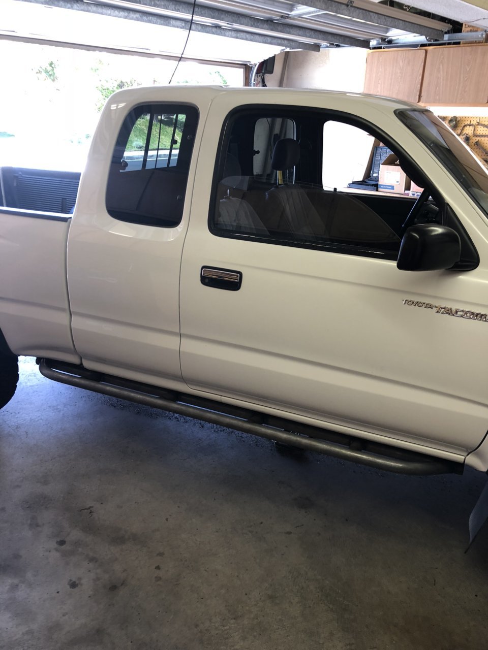

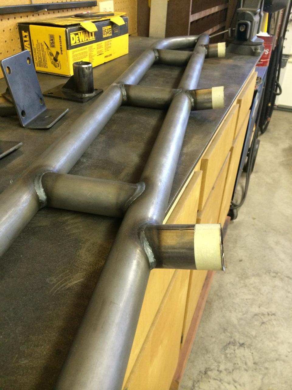

    Installed some trail gear rock sliders. Cut them 1 3/4' and welded them back together so they don't stick out so much and don't get hung up. Decided to do bolt on because you never know when you need to take them off to do work or re paint them. All in all came out great and definitely sturdy enough to jack up on. Getting them sand blasted and powder coated black on Monday!

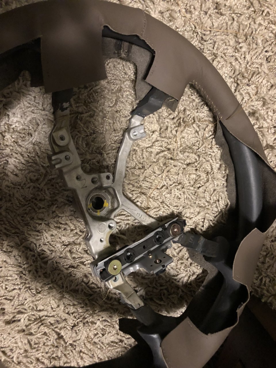

    Got a leather kit for my steering wheel on eBay, pretty good quality.. finally got the stitching figured out, took me so long.. lol.

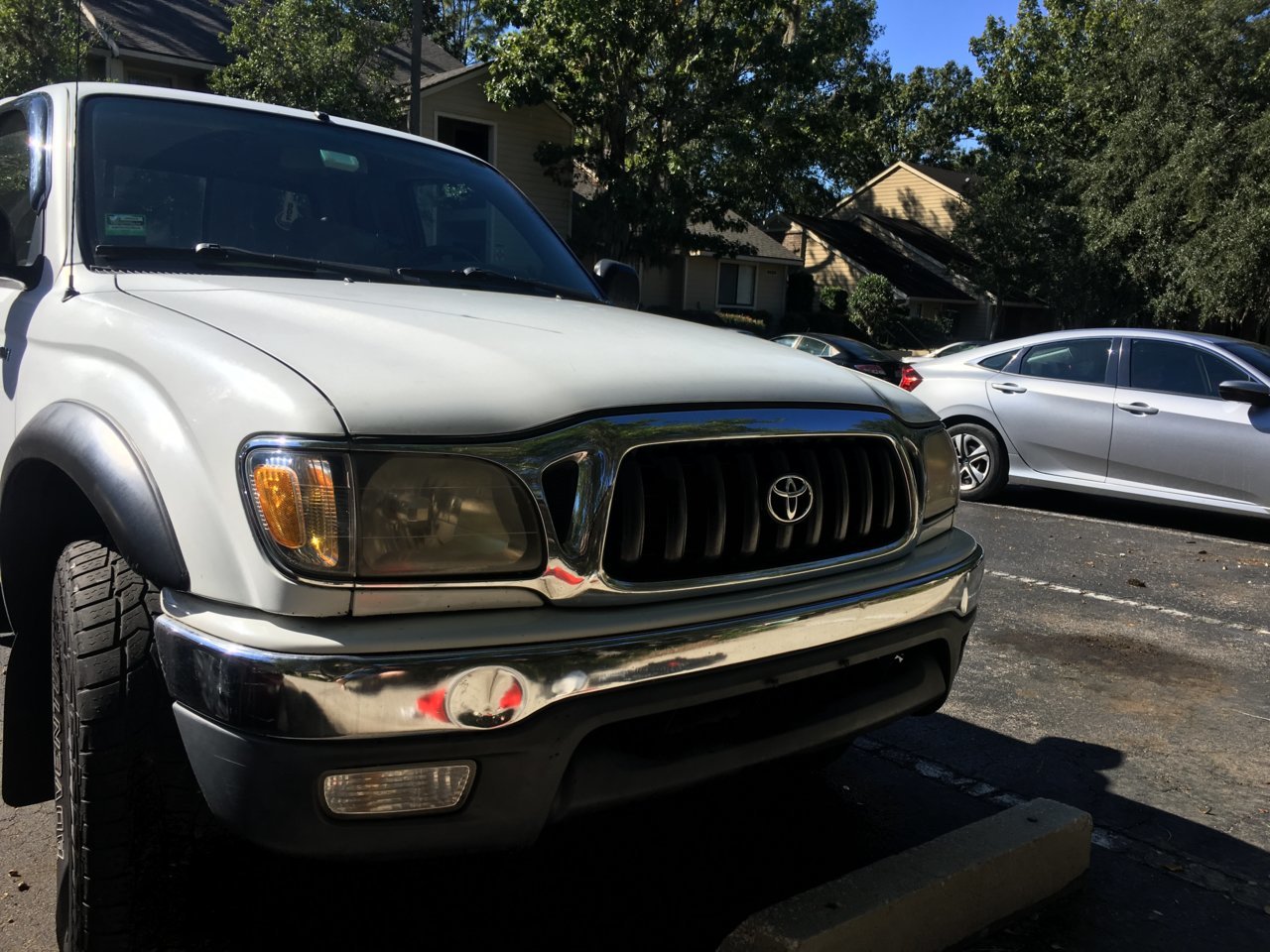

    Removed by bug protector (truck mustache)
