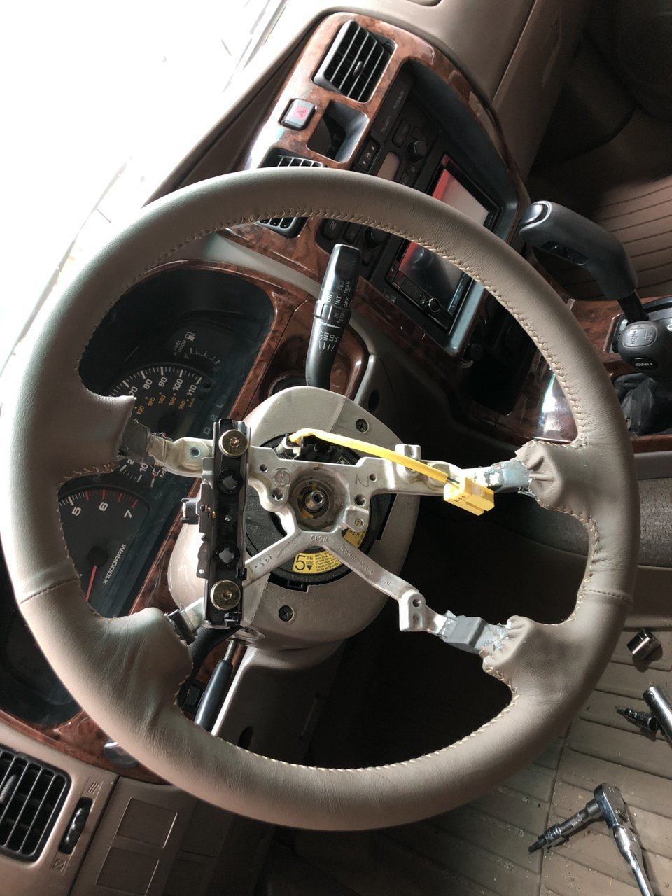

    Finished my steering wheel.. finally.. so painful.. Didn’t come out perfect but it’s much better than it was.

    Looks pretty damn good to me, once that airbag goes it it'll cover the area's you didn't fold under.
