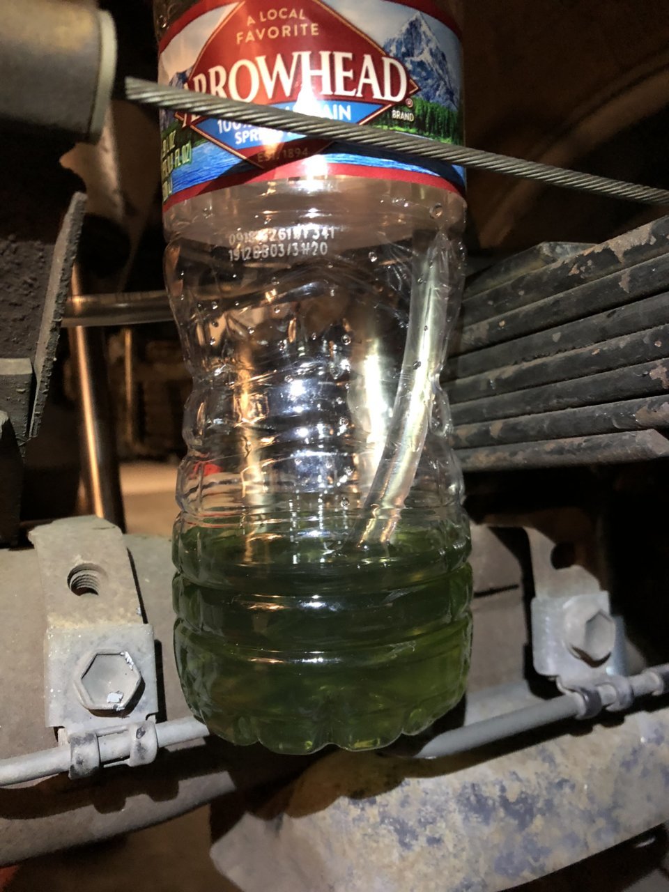

    Also it didn't help my issue. In thinking the bubble could be in the ABS system or still stuck in the master.

    Ah, ABS. I am so sorry.

    Some fluids turn a dark yellow. Some turn green. Just flush it out and replace it with some decent quality stuff and you’ll be fine

    I flushed it all out, I'm just concerned how fast it turned green. I originally flushed the system when I did my Tundra brakes, so about August 2017.

    Water getting into the system would be my first thought. Humidity. But your in Cali.. humidity is rare. Could also just be mixed with shit that was stuck in there
