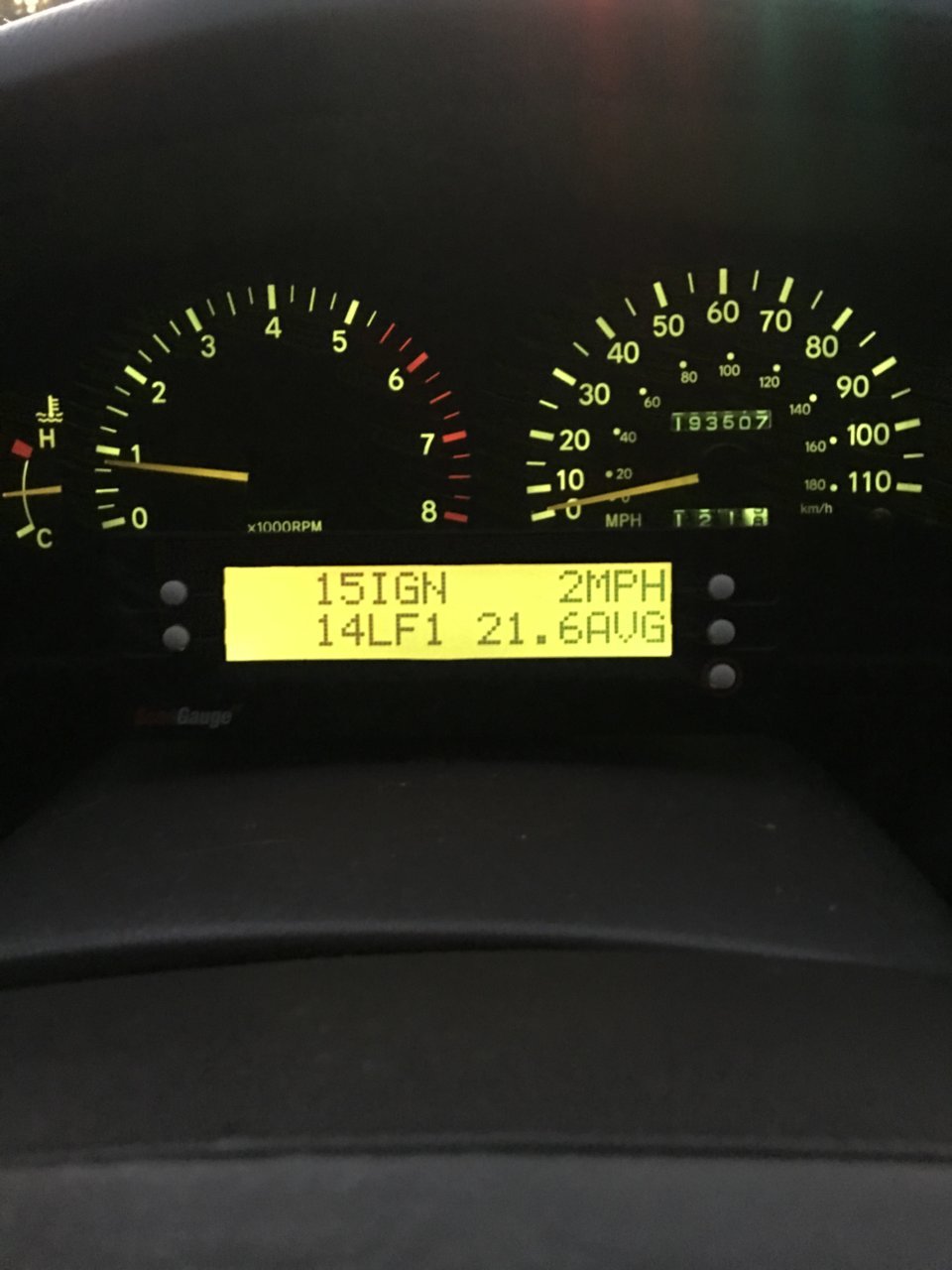

    These 31s aren’t so bad after all. I’ve never actually driven the truck with stock size tires. Ever since I’ve had it it’s had 32-33’s. Truck feels great and gained about 2-3 mpg average. This is from my drive home which is mainly all highway. Now trying to lower the LTFT some starting with vacuum leaks and replacing the TRD supercharger bypass o rings. What are you guys seeing as far as LTFT’s? Mines highest at idle which I believe points to vacuum leaks. Based on research 14 seems pretty normal for an older engine, but I’d like to try to slowly improve it over time through maintenance.
