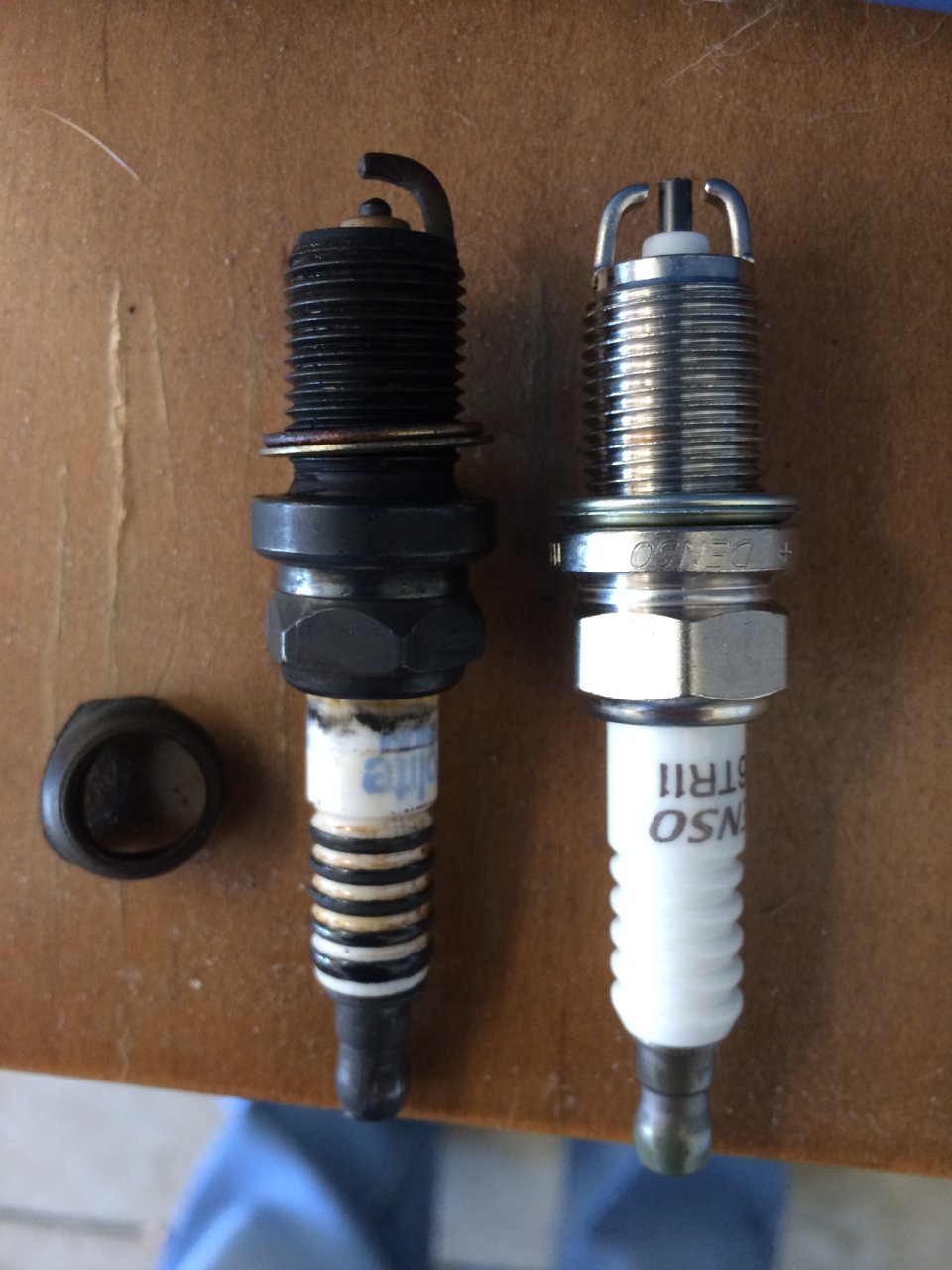

    Well they’ve been changed at least once since single electrode Autolite brand isn’t stock. Also had a piece of rubber stuck to it. Part of the boot I guess?
    Probably why this had the P0304 code and the spark was coming out of the side of the boot.

    Changed the #4 plug and wire, reconnected the battery and started it up. Stuttering has stopped, check engine light is off. Drove a couple miles, no sputtering.
    Now to let it cool down and change the rest of them.
