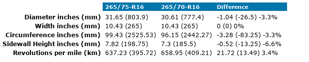

    I'm having a hard time finding a spare with a mounted tire size of 265/75R16, which I have on my truck. Would a spare with a 265/70R16 be okay to use? Only difference is the aspect ratio difference of 70 vs. 75

    I mean it would probably be fine if you swapped it to the front. But you can also search for 235/85/16 which is a common commercial size

    I understand the tire size difference between the two, I was just wondering about the 70 v. 75 aspect ratio difference would be permissible.
    I'll be on the lookout.

    Well the aspect ratio affects total diameter, so here's your answer
    It wouldn't be considered a fullsize spare and I wouldn't travel long or fast like that

    3rd Gen spare steelies are plentiful, and have the same backspacing as my 3rd gen TRD OR wheels. They come with the 265/70R16 tire mounted to it already. However, the aspect ratio on my KO2's are 75 not 70.

    Very well. I'll be on the lookout for a steelie and just buy a new tire to be safe.
