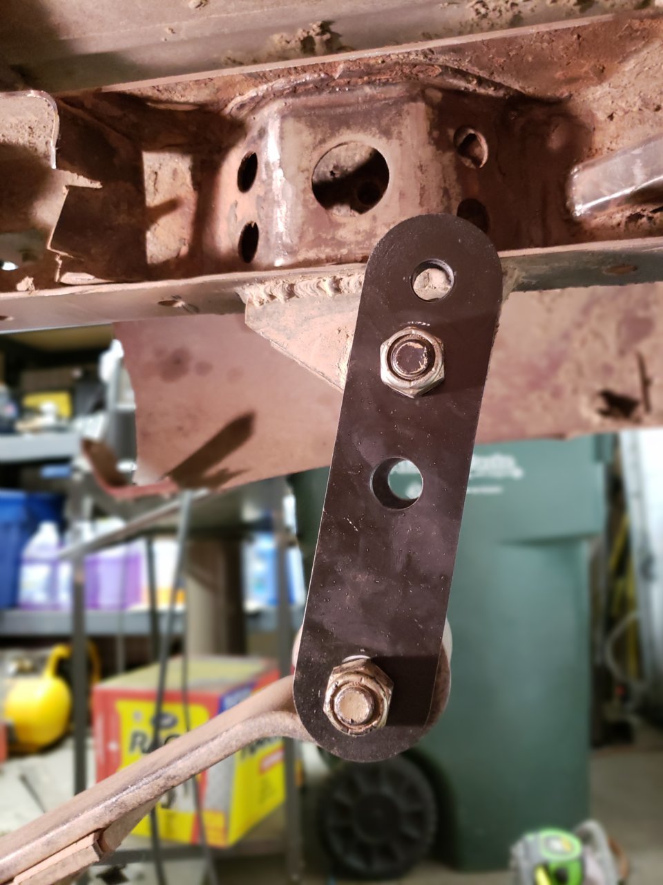

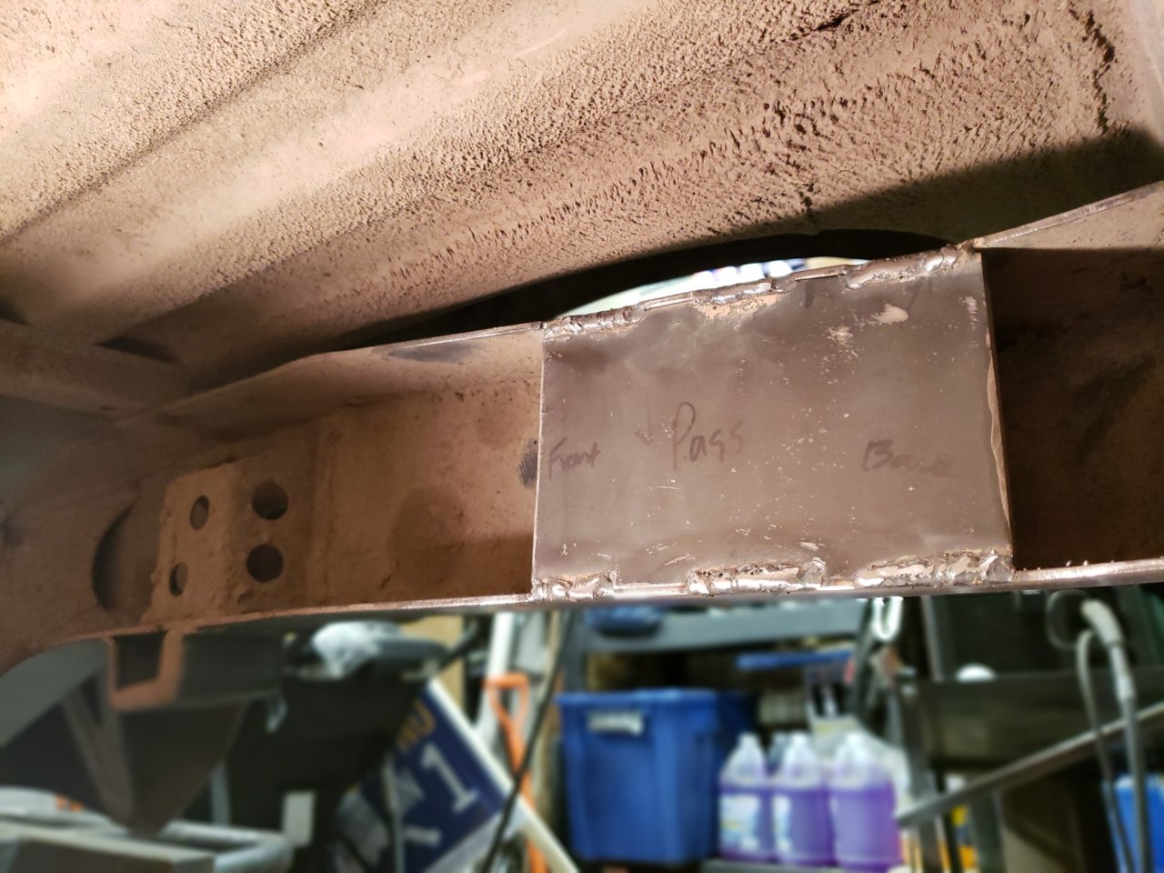

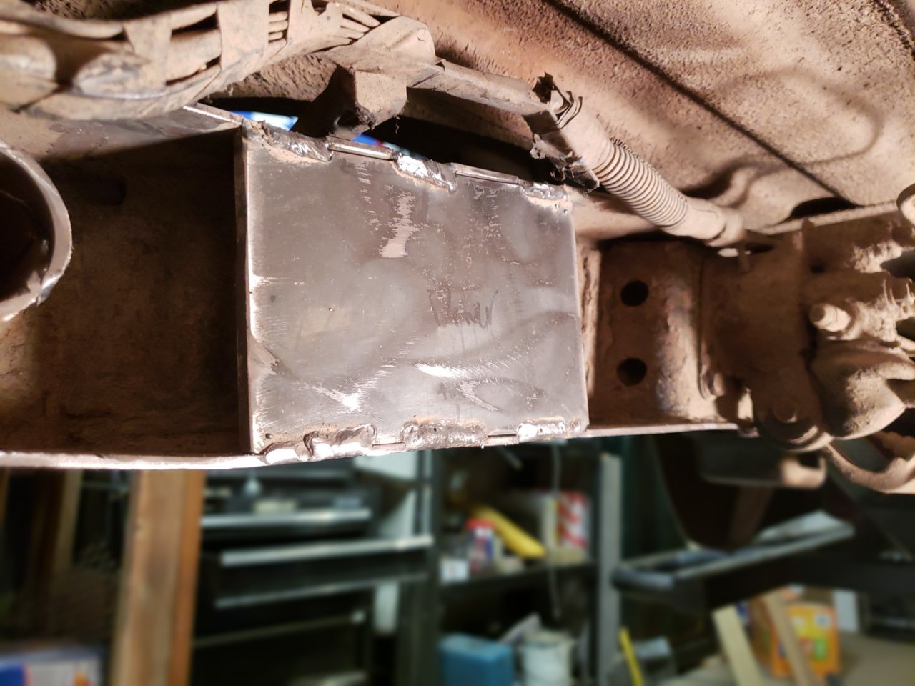

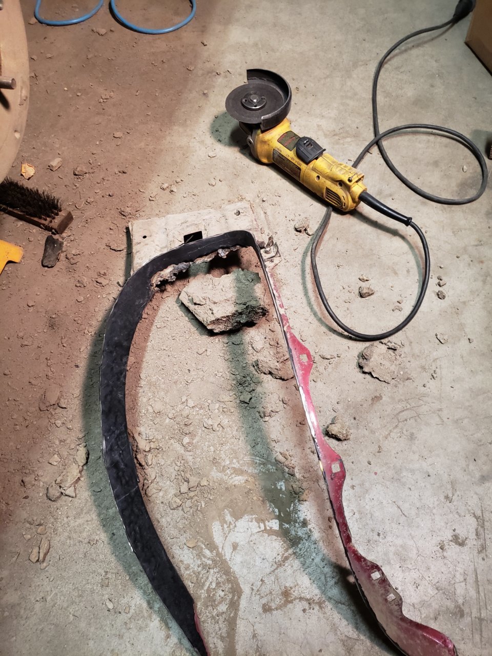

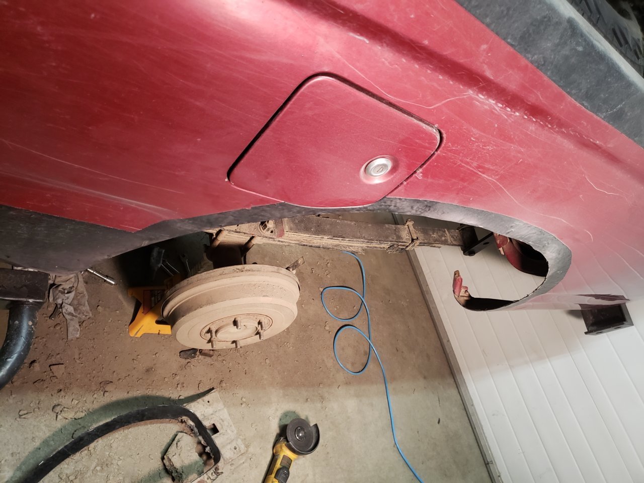

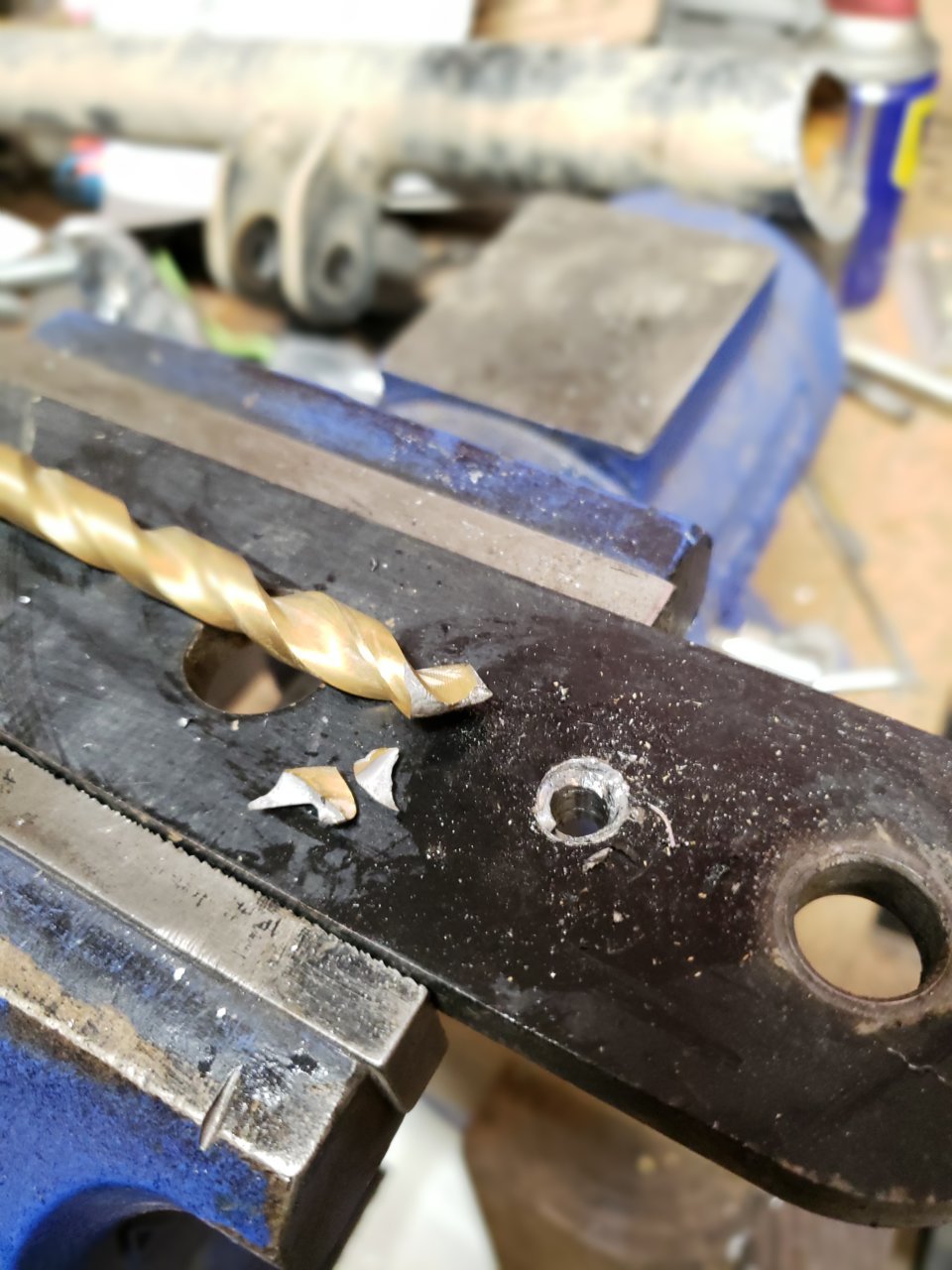

    Been very slowly plugging away at optimizing and rebuilding my suspension all around. I cut my bedsides 2" larger all around to get rid of rust and to fit my 37" tires better. I will see if I can find a shop to help me roll the edge, or I'll just run it as-is. Also are some new frame box plates to weld a new crossmember to get a shock angle more vertical. My old attempt of just welding in 1 3/4" .120 wall Dom was cracking my frame jut outside of my welds. Also, drilled out my 6" RuffStuff shackles to 4 3/4" to help lower my truck some too.

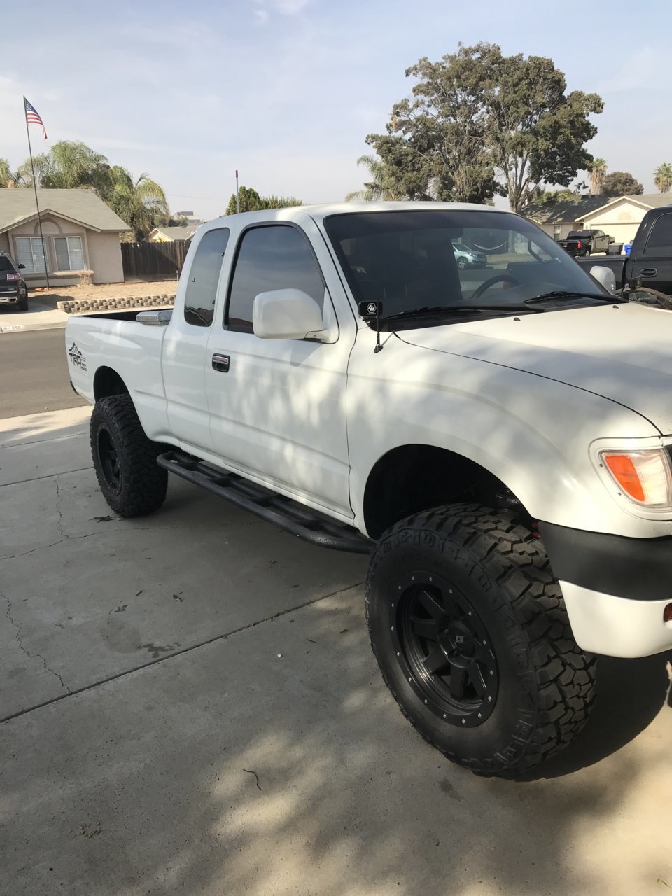

    Put some sliders on it 2 weeks ago. B0D9806E-4132-497F-AC8E-5BDFD017CA56.jpg

    I want... are they weld or bolt

    They were bolt on but I didn’t want to make holes in the frame so I welded them on
