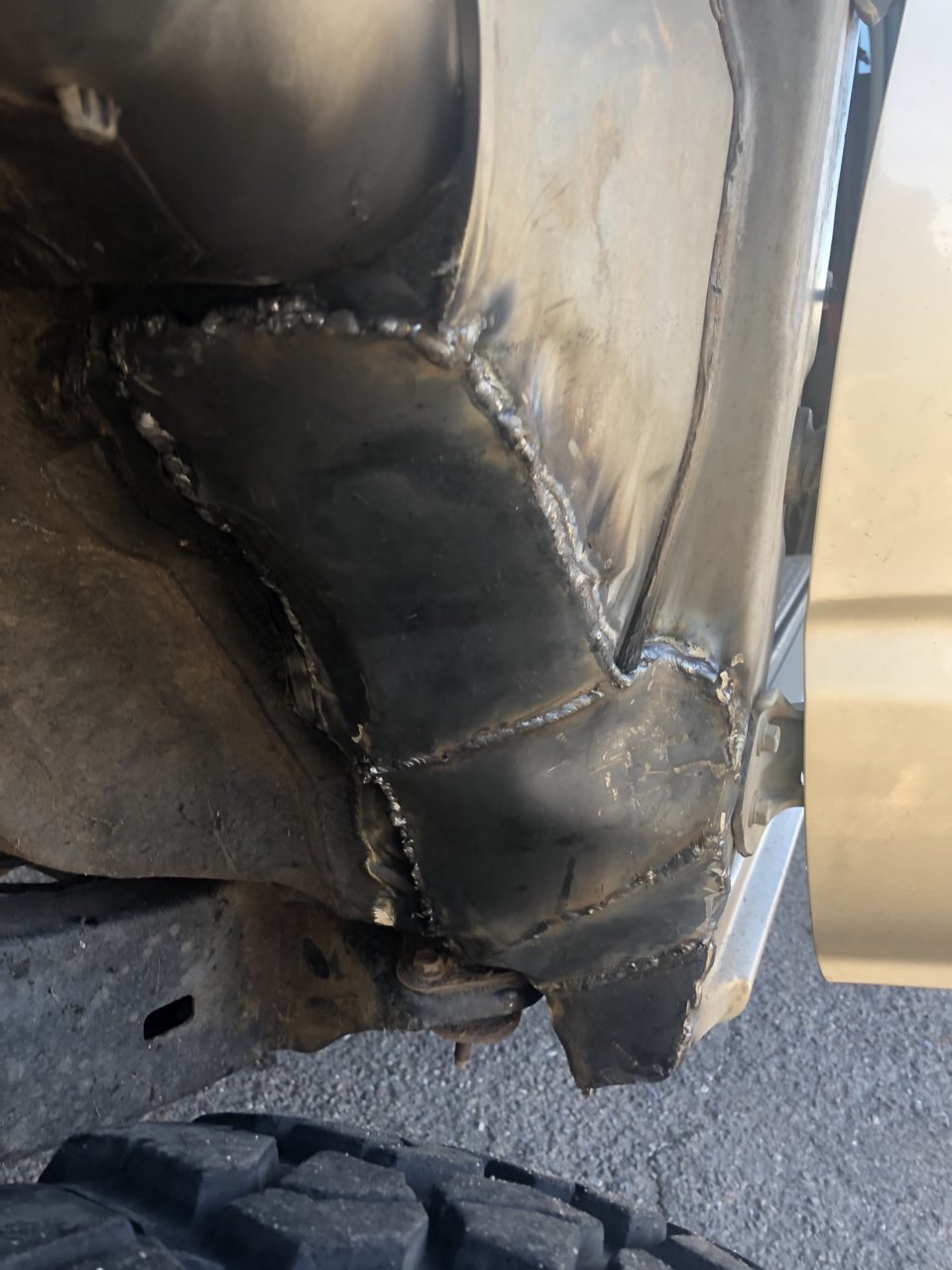

    Tub my fender well...

    Ehhhh.
    Maybe I’ll do a SAS. Wouldn’t have to tub it then! That’ll show them.

    I don’t think sas means you don’t have to tube

    lol, going for 35s too?

    He doesn’t want to hit the pitch weld for 33’s

    then just cut it off with a grinder, that shit is like cutting through butter.

    Shoulda said he doesn’t want to touch the pinch weld

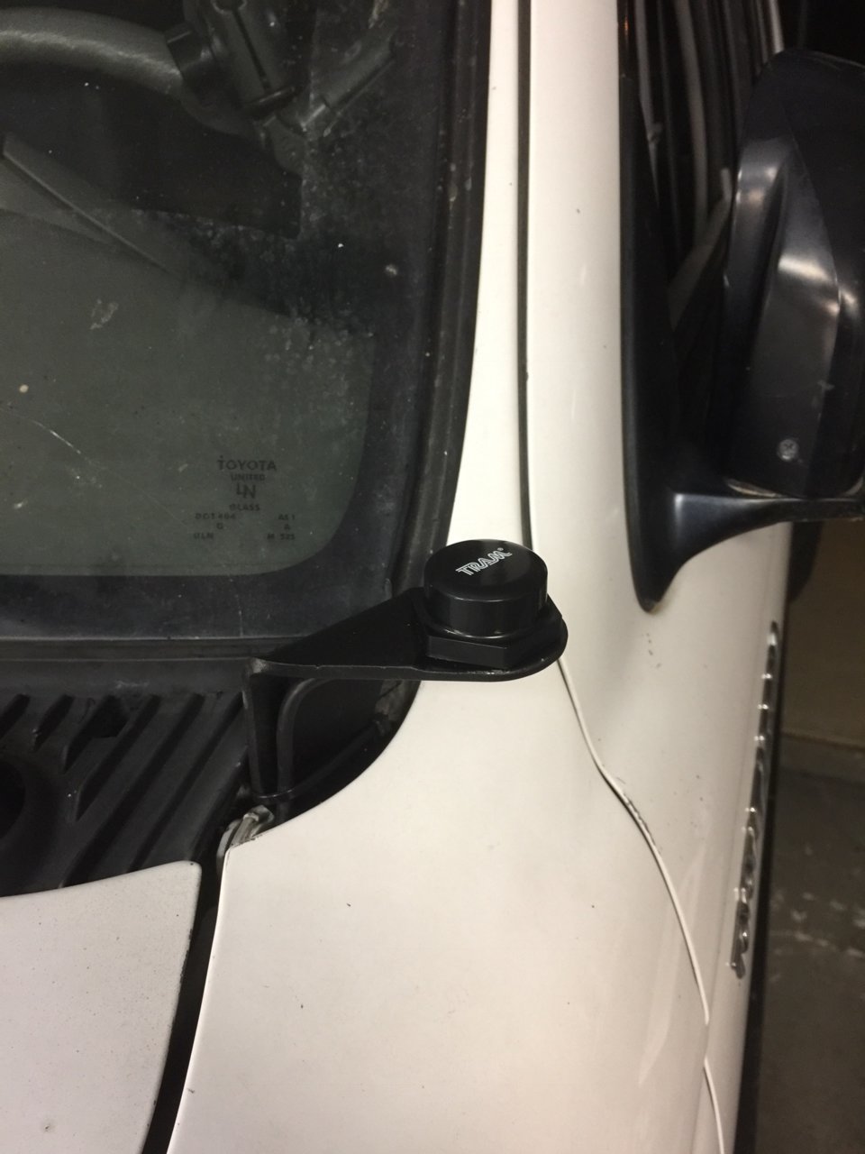

    I’m running my 3/8 NMO CB antenna on a ditch light mount and it’s been great. VSWR is 1.4:1 at CH1 and CH40; 1.1:1 at CH20.
    When I go HAM, I’ll likely do a 3/4 NMO mount in the middle of the roof.
    @BartMaster1234 , here is a picture of my antenna. The NMO mount is really nice because I can take the antenna off when I don’t need it and protect the mount with the cap you can see in the picture.

    Don’t CBI have a Cb antenna mount?

    As @Speedytech7 mentioned, it’s just a single ditch light bracket. You choose which side you want when you order one. The 3/8 NMO antenna mount fits the bracket hole perfectly.
