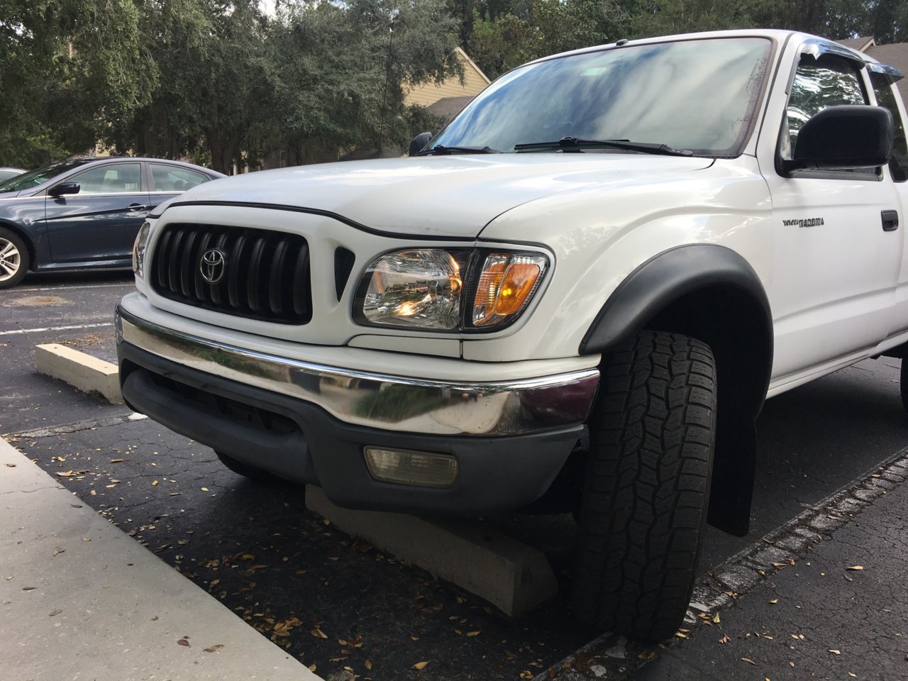

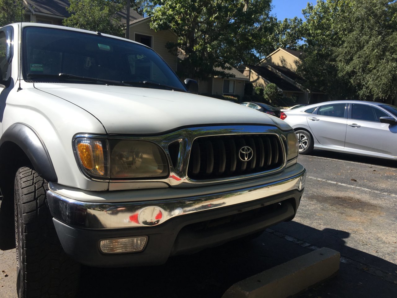

    You have any issues with the led lights not working with the curtesy light fade?

    What heads lights did you go with?

    Just headlights off rockauto... forget which ones but someone recommended them and they are about $80 for the pair (the most expensive of the choices). They fit quite nice and they say “Eagle eye” on the box. Great fit and look good!
    Edit: “Rock-auto CAPA cert”

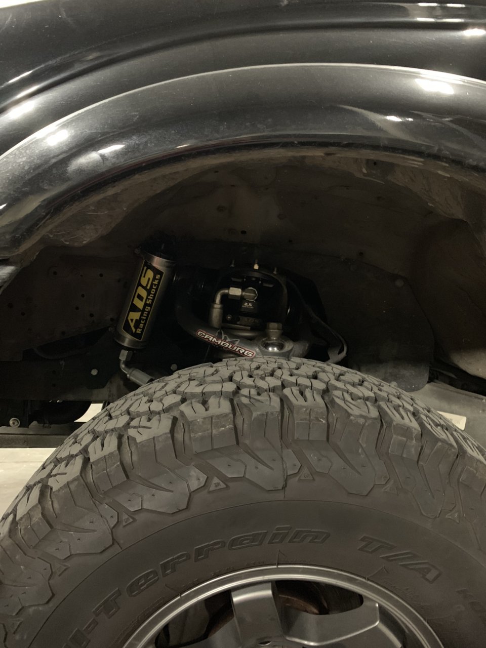

    After a year of them sitting on a shelf I finally got around to installing my ADS coil overs with the new bracket.
    With the original setup I would rub the hell out of the reservoirs and I even hit one and bent the bracket up pretty bad once when turning into a steep bank.
    This should solve the issue.
    Matthew at MCM has these mounting brackets if anyone is interested.

    Nice, is that the mounting bracket from MCM?

    Yes it is. You’ll also need new hoses and fittings, need to tap the holes that the brackets use and I had to take them to a sheet metal shot and have them slightly bent so they wouldn’t contact the inside of the fender.

    Matt hooked me up for free. I also bought oil and rebuild kits though. It was a test run to see how they work out on a Tacoma. I’ll have to make a review thread tomorrow and include everything that I had to modify to make them right. It took me quite a bit of time to make it work.
    And you won’t be able to make it work without new hoses. Those hoses are not super flexible either. I had a really hard time myself with this. I have access to hydraulic hose, fittings, and a crimper and I went through a few sets and spent like $100 before I found a way to make it work.
    But honesty you do not need the quality of hose ADS uses. There is very little pressure in them and if you look at king or Icon they both use what seems like more flexible cheaper hose and fittings.
