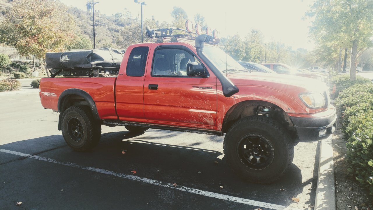

    What kind of rack is that?

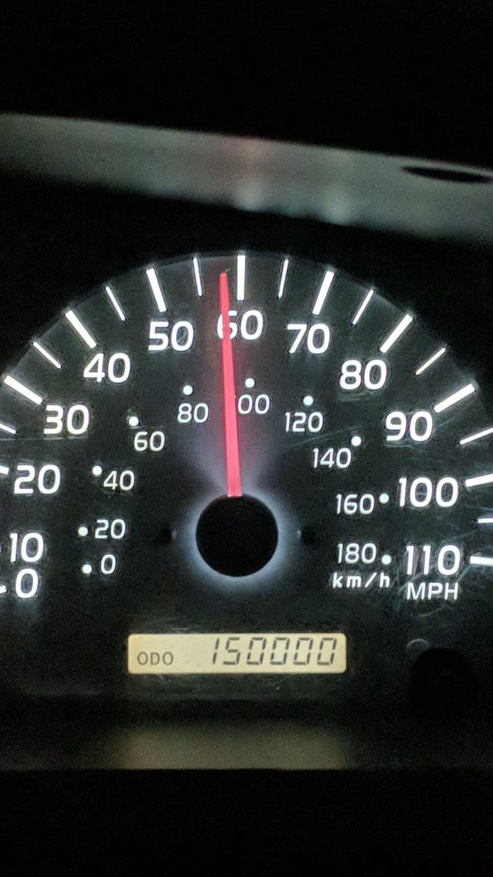

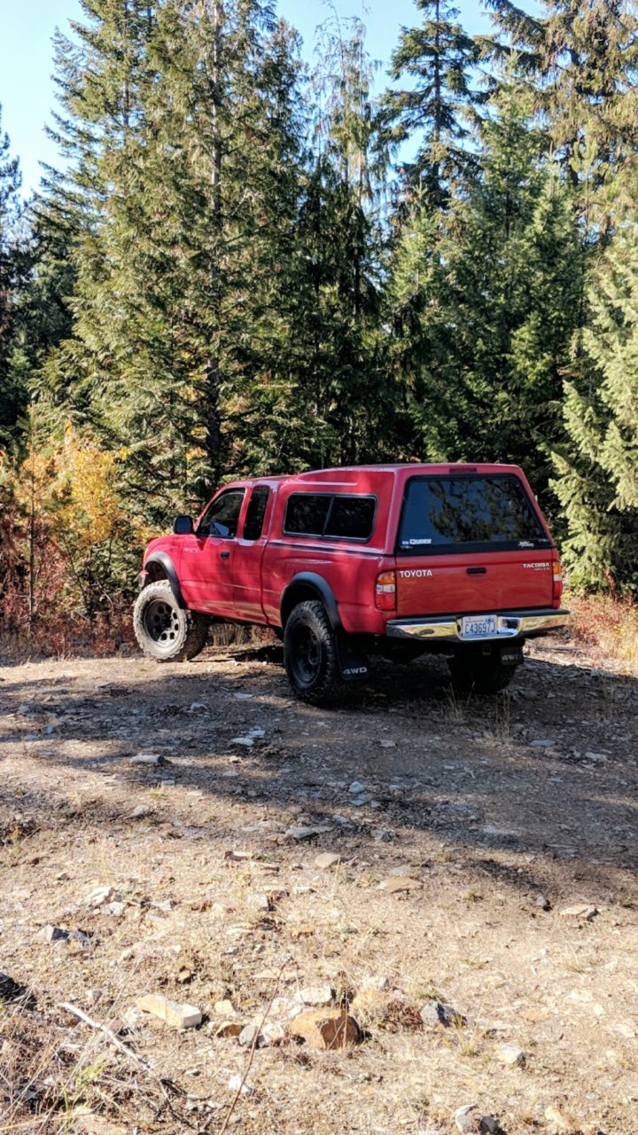

    Broke 150,000 on the old girl. Time to trade her in for something more reliable like a used gasser Dodge or something along those lines.

    It's a Smittybilt Defender roof rack, the compact version...they make a bigger one that covers the entire roof.
    I'm sort of on the fence about keeping it...I've had it on for a couple years and lately it's been making a bunch of knocking/rattling sounds because one of the well nuts (I think) has come loose. Since it's bolted onto the roof it's going to be a pain to deal with lol.

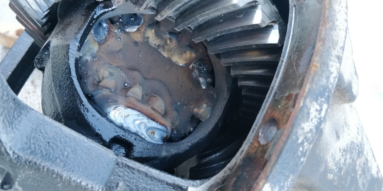

    I need to get it installed this week if I want to make the group run this weekend:bananadead:

    Nice! Did you cut the plate to fit the gears too?

    Yeah, I cut that plate out of 1/4 to fit between the spiders and weld them together after doing some big tacks on the gears. Just welding the gears is probably enough but I figured it was worth an extra few minutes of effort to make it as bulletproof as possible especially given advice from a friend who has done several.

    The plate method is always smart, yours looks like it fits really well too.

    I have gotten better at reading a tape measure with age :laugh:

    Plus having big welder to crank the settings up on really lets you get good penetration on those teeth and makes it look a lot better than if I had used a little 110 :)
