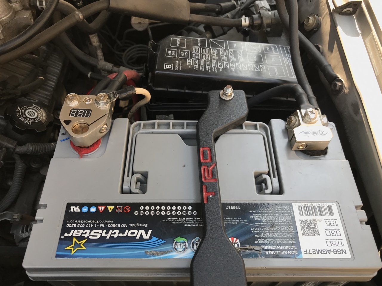

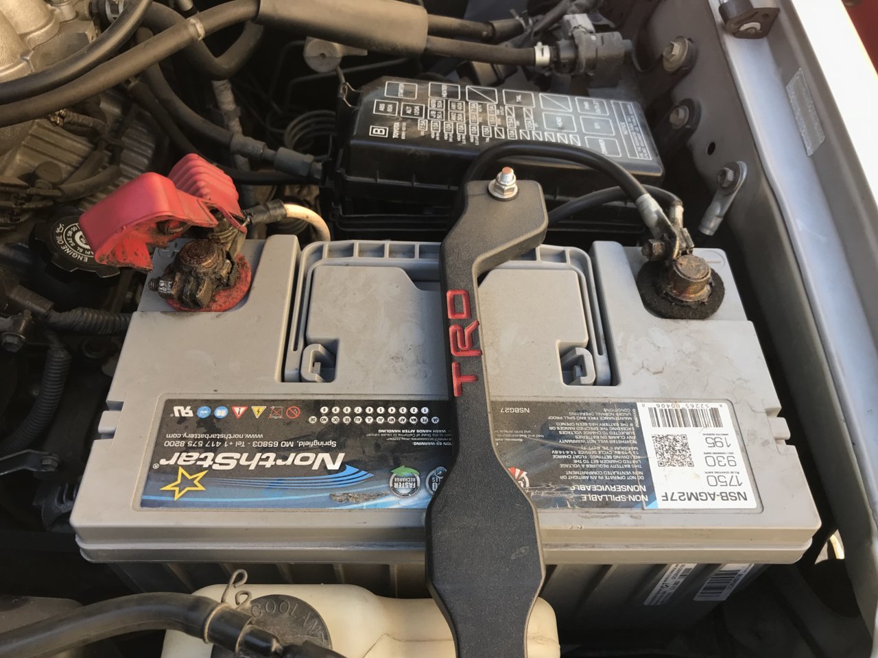

    I reinatalled my aux fuse box and tried to wire up the light bar last night. I ran a positive wire from the fuse box to the lightbar and tried to use the switched ground in the passenger headlight plug (I'm running a relay harness so it's unused) to trigger it when the high beams are on. That works but I think I'm going to scratch that idea and just run a switch because when the high beams are off the lighbar is still getting a connection through the plug and has a very faint glow.
    Low beams only
    High beams
    High beams with light bar

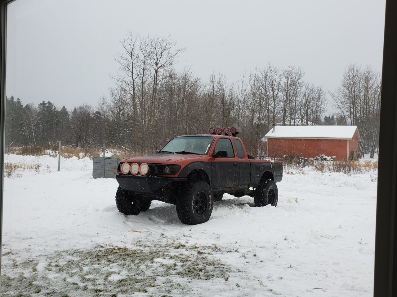

    flew home for the month and took for first drive in snow this year
